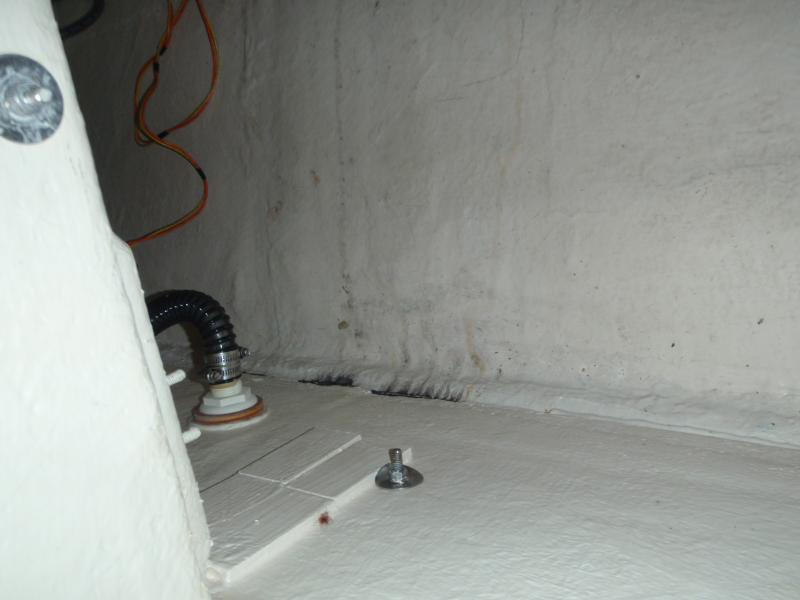

OK getting set up for the spring work list and one item I have on my list is to repair a very slight leak coming from the screws that hold the rub rail to the stern of the boat. I have enclosed a picture of the inside of the storage area. You can see the black discoloration. My plan is to remove the screws holding the rub rail in that section, one at a time, then putting sealant on them and reseting the screws. My question is has anyone else done this before. Is there something I need to look out for and which sealant should I used?
This section of the rub rail is always underwater and though this is not bad it bothers me to have a leak of any kind or size.

That's an interesting picture. What year is your boat? I'm curious, because on our 1995 H336, the entire hull to deck joint from the rear cleats back is glassed over on the inside, so even though the rubrail around the scoop stern is usually under water when we're underway, there's no way it can leak. I assume it came from the factory that way, and I'm wondering if it's something they quit doing.

It is a 2006 and we found this when we did the survey. It is right at the bottom of the sugar scoop. Nothing serious but bothersome. I just want to clean it up and make sure there is no further seepage.
