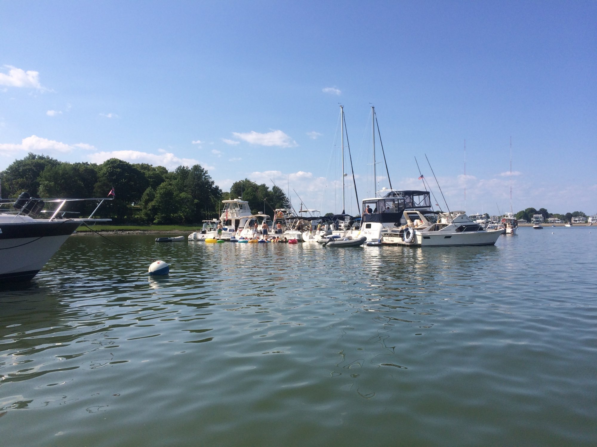

We used to prefer the ball fenders (sometimes called tuna balls) for raft ups. They do better with different hull contours coming together.
This was a small raft up. We have had as many as 41 boats rafted together at this spot.

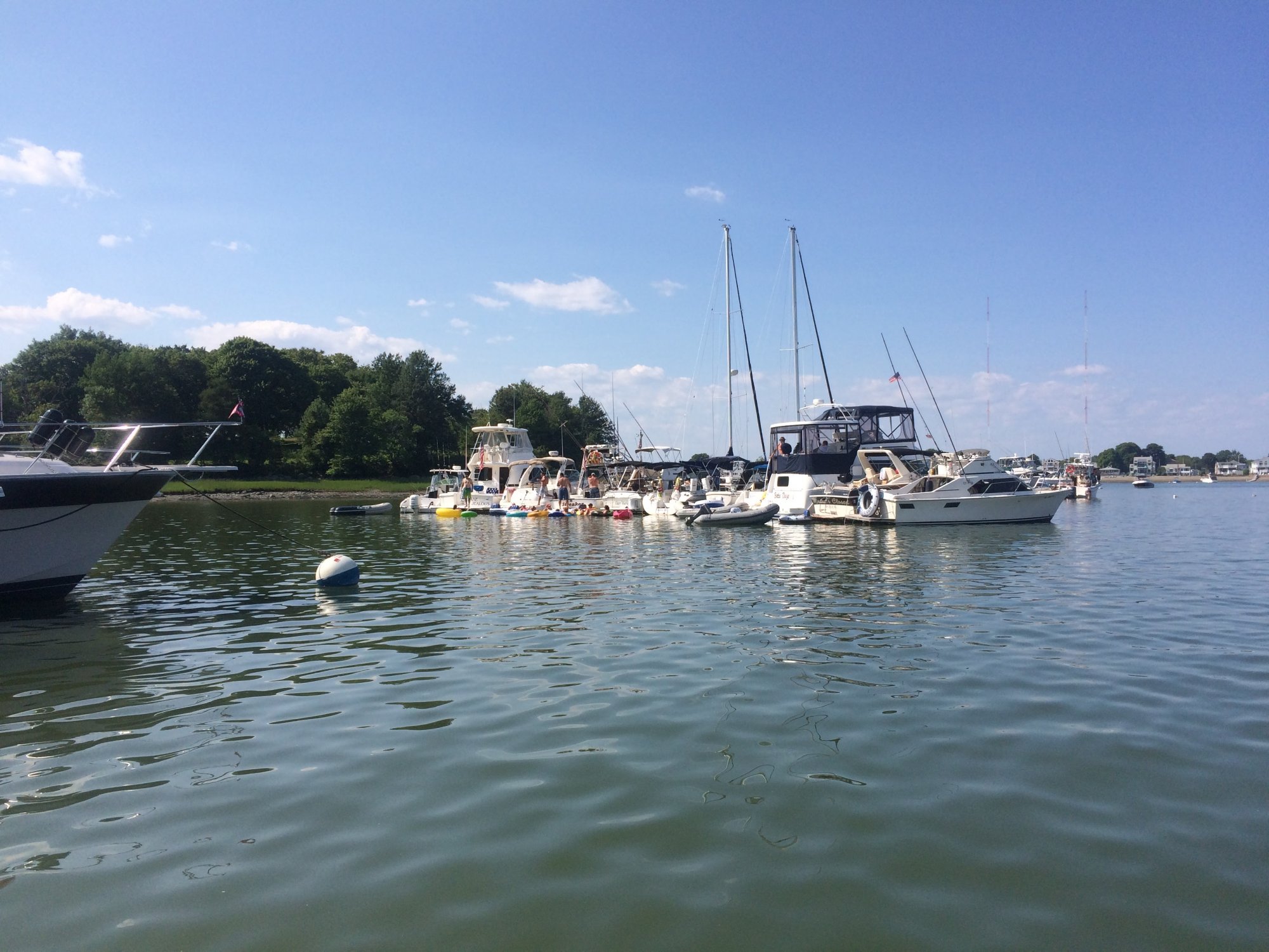

I agree. The big power boat that anchored uses them (they‘re our race committee boat, so they also use them for small boat racing marks). If I had a place to easily store them on our boat I’d get some.
41 boats! That’s impressive.
