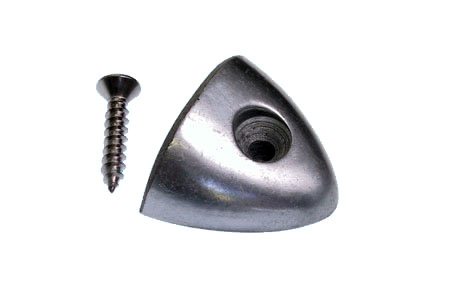

These are not available any more. Other than replicating it at a machine shop, any ideas?

I did in fact look at Taco. Nothing close.
Someone at CD recommended the rubber jib track stopper...

If you have one, can you use it as a mold and make one from fiberglass?

Good idea to make a mold. Could mold from any plastic and then paint, or how about JB Weld? Find a friend with a 3D Printer...

If you go with epoxy, like JB weld, and you have access, cut fiberglass threads about 1/4 inch long and mix in. It will add a lot of strength.
