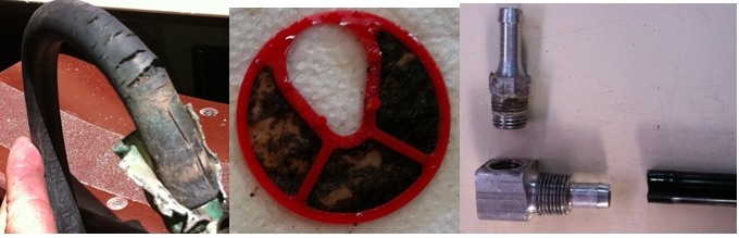

Fuel delivery
I got towed back to the slip twice in a week. Pretty scary as I was close to shore when the diesel engine acting up. The engine will slow down and speed up, eventually quit. It can be restarted but own't go into lower RPM or idle.
Traced the entire fuel system and found the following:
(1) Fuel hose at the engine cracked at the bend but can not see it visually.
(2) There is a screen inside the fuel pump which is almost blocked. Didn't know it exists.
(3) The pickup tube inside the fuel tank was just a piece of plastic (ABS) on a barb. It let in air because it wasn't glued on.
Engine is a Volvo Penta 2002 circa 1985.
It's not obvious but should be checked every few years. Lesson learned !
