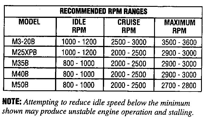

JK, Thanks for the chart in your last post. My idle was set at 750-800 and the vibrations were very strong. After I started the engine I raised the rpm to 1200 and it would smooth out. Bumping the idle up to 1K is a lot better and if other crew members start it, they don't have to remember to raise the rpms.
Just as an aside, your chart shows max rpm as 2900-3000. I can make that engine speed but my "redline" on the tach starts at at 2500. I can hit 3000 in neutral, but when motoring out of the harbor I max it out and it runs at 2500. Then the rpms gradually slide back to 2200 where it will run all day. Very smooth and the engine seems to like this amount of effort.
