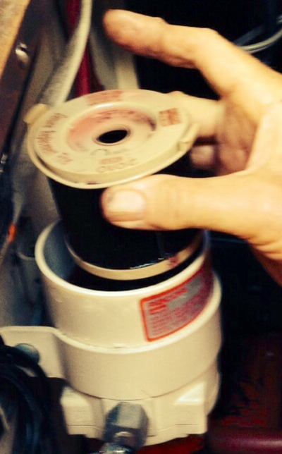

Racor filter was dirty. Very dirty. Surprised engine ran as well as it did. When we get home after Memorial Day I will take off vacuum gauge and get it tested.
Thanks all for your advice.
