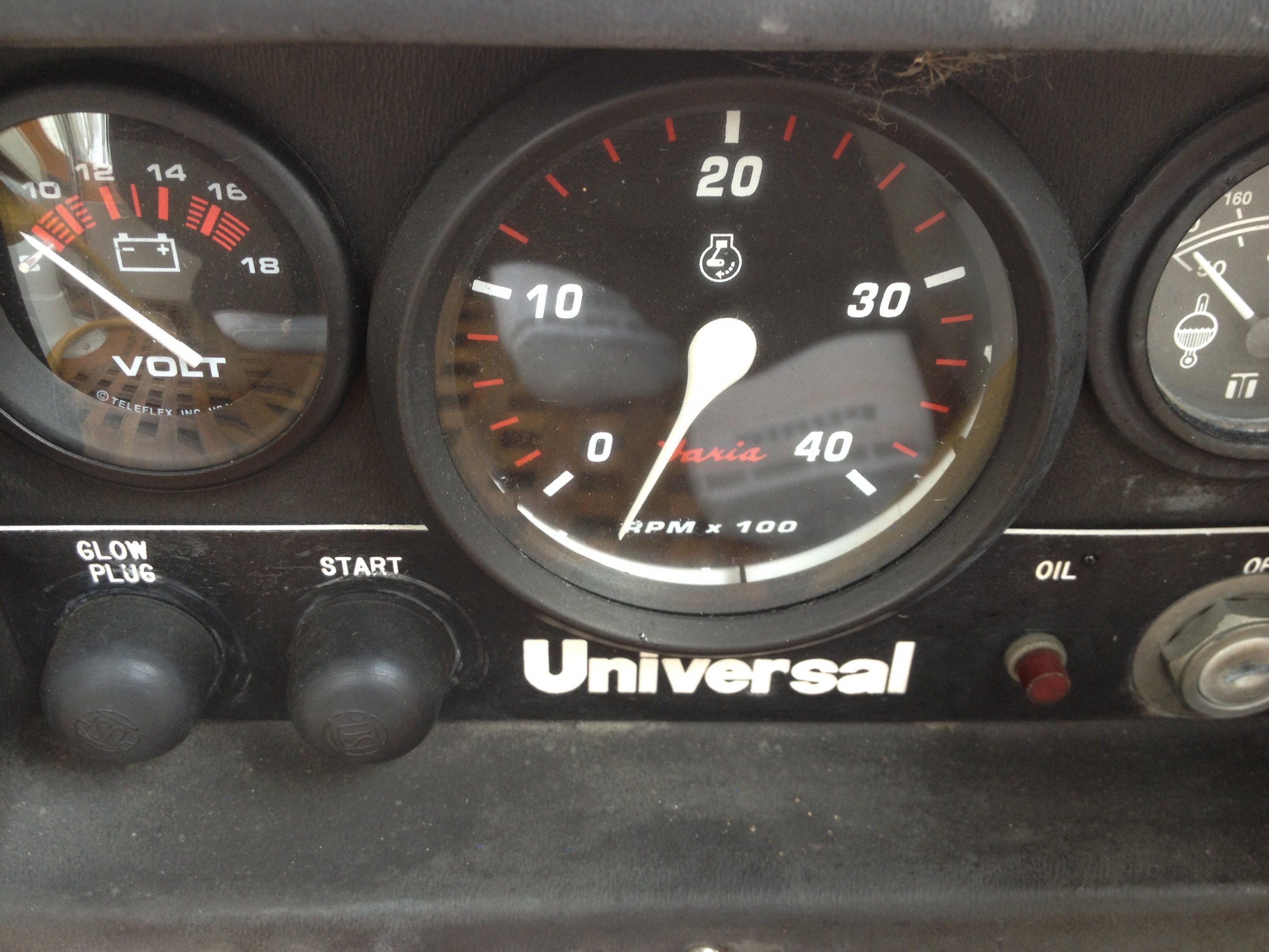

My tach is marked at 500 rpm intervals. If yours is similar, say a standard 4 or 5000 rpm tach, how can you tell? Do you have a digital tach? If not, this appears to be a non-issue, and perhaps only one of perception.
Not sure I understand being in large enough swells to even begin to notice this issue in neutral. I'd be moving to stay sane. :):):)
It's graduated in 200's (pic). Definitely moving during the incidents. Rock steady when water is flat. I think it's a non-issue too, but can't figure it out which befuddles me.
Yes I like to be moving :) but I see the fluctuation when stopped to bring sails down into the wind and swells after starting motor to transition to entering harbor.

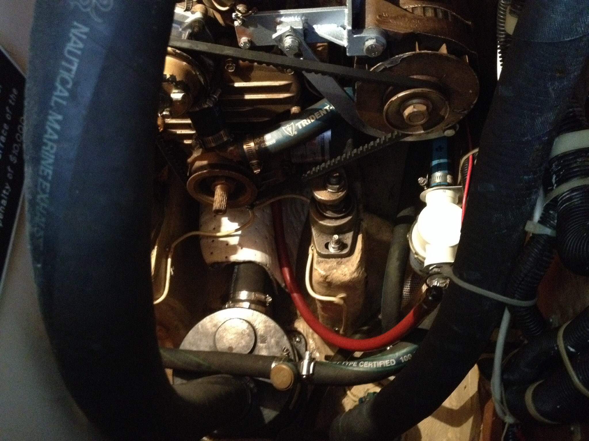

I didn't think about the governor. That's possible. Also water in the exhaust moving back and forth is interesting too; with the stern down, the motor is pushing water uphill towards the muffler which is forward of the motor in my setup. The hose makes a u-turn behind the motor/riser and runs under the motor towards the muffler. The exhaust then goes up and runs along the top of the engine bay going aft to the stern port.
Edit: added pic
the needle on an electronic tach can move a bit with the sway of the boat, in the same way it can move a bit if you are holding it in your hand and rotate the housing, while its powered up or not...its an inductive instrument so the needle is not connected with a linkage like a mechanical tach would be.... and, unless one is using a digital tach, and the change is sustained, 100 rpm is hard to distinguish on a stationary engine in a shop, let alone one running on a rocking, pitching boat...
but its also true that a lower powered 2 cylinder engine will be more affected by any gyroscopic precession, as suggested by kloudie1.... as will any water surge within a waterlift muffler system while the boat pitches...
and when first reading your post, I was thinking along the same lines as capta, where the doppler effect gives the impression that the rpm is changing. and the sway of the boat is causing the needle to dip slightly.... it could be some combination of all the effects, and im sure that you could do some experiments and tests to find out the real reason, but I would also bet that in the end, it wont make any difference in the performance of the boat or how much enjoyment it can offer, than it would have if you never would have noticed the difference...
