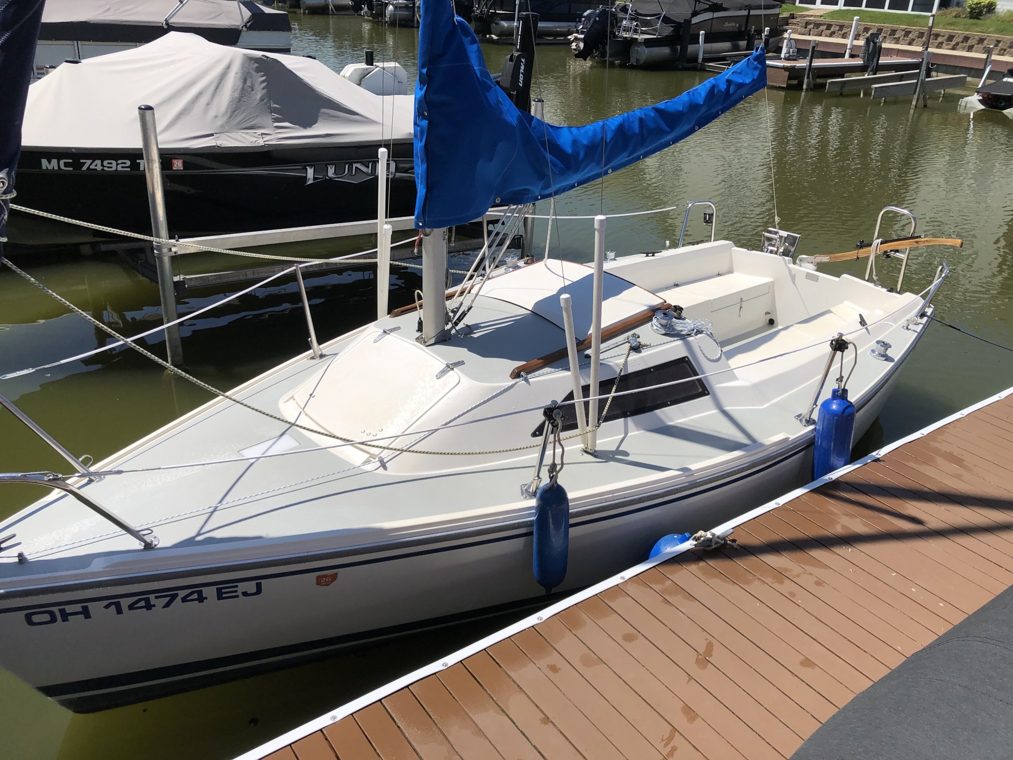

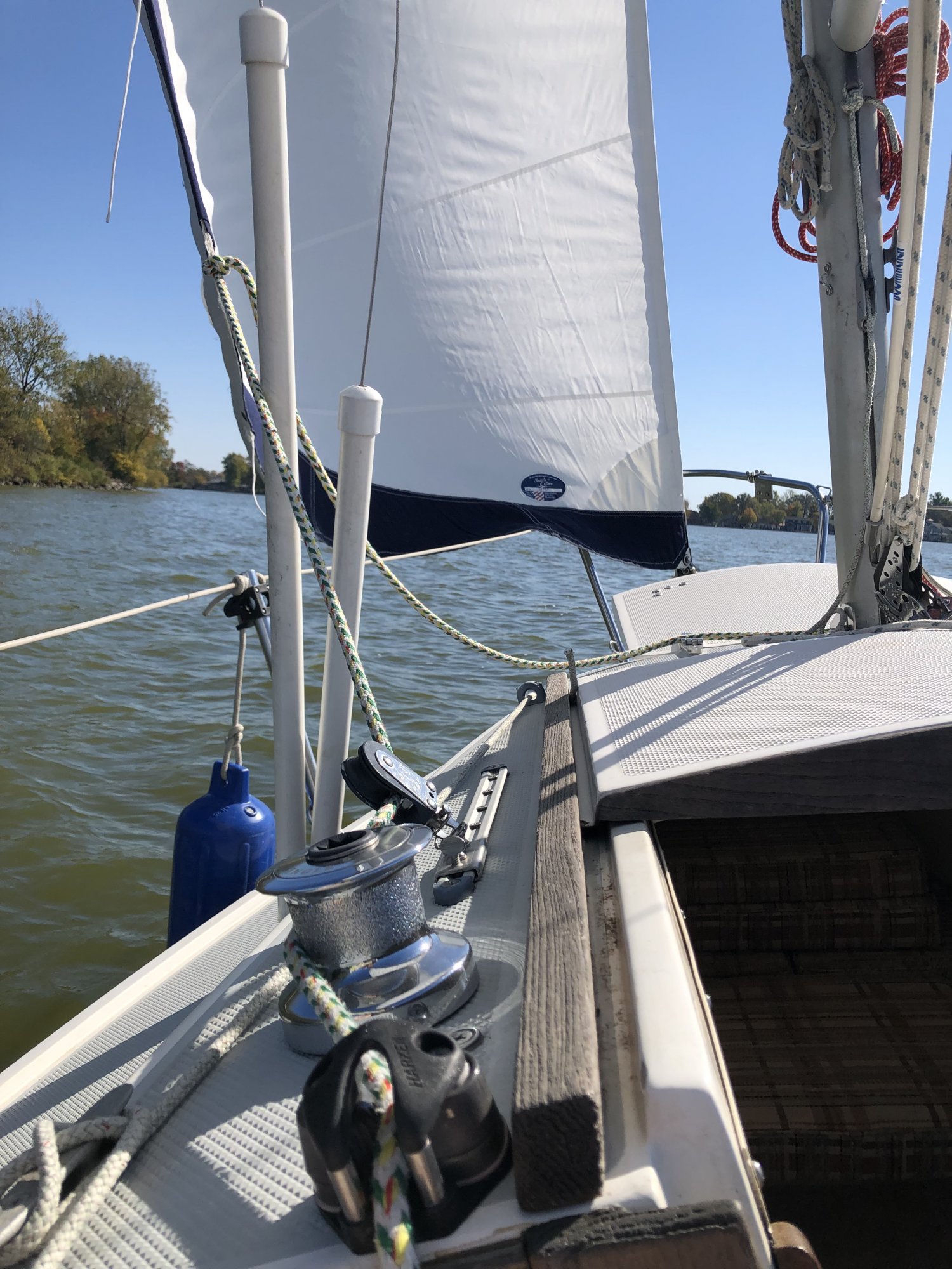

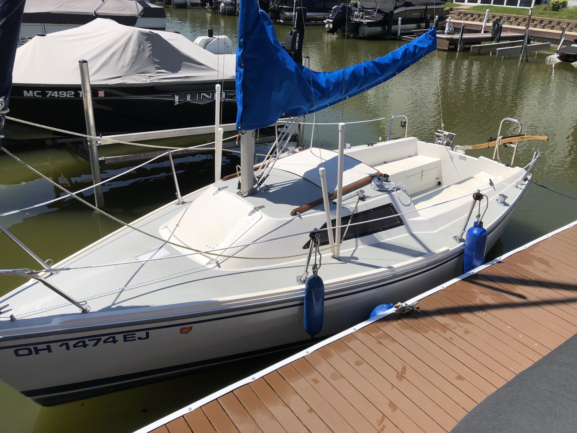

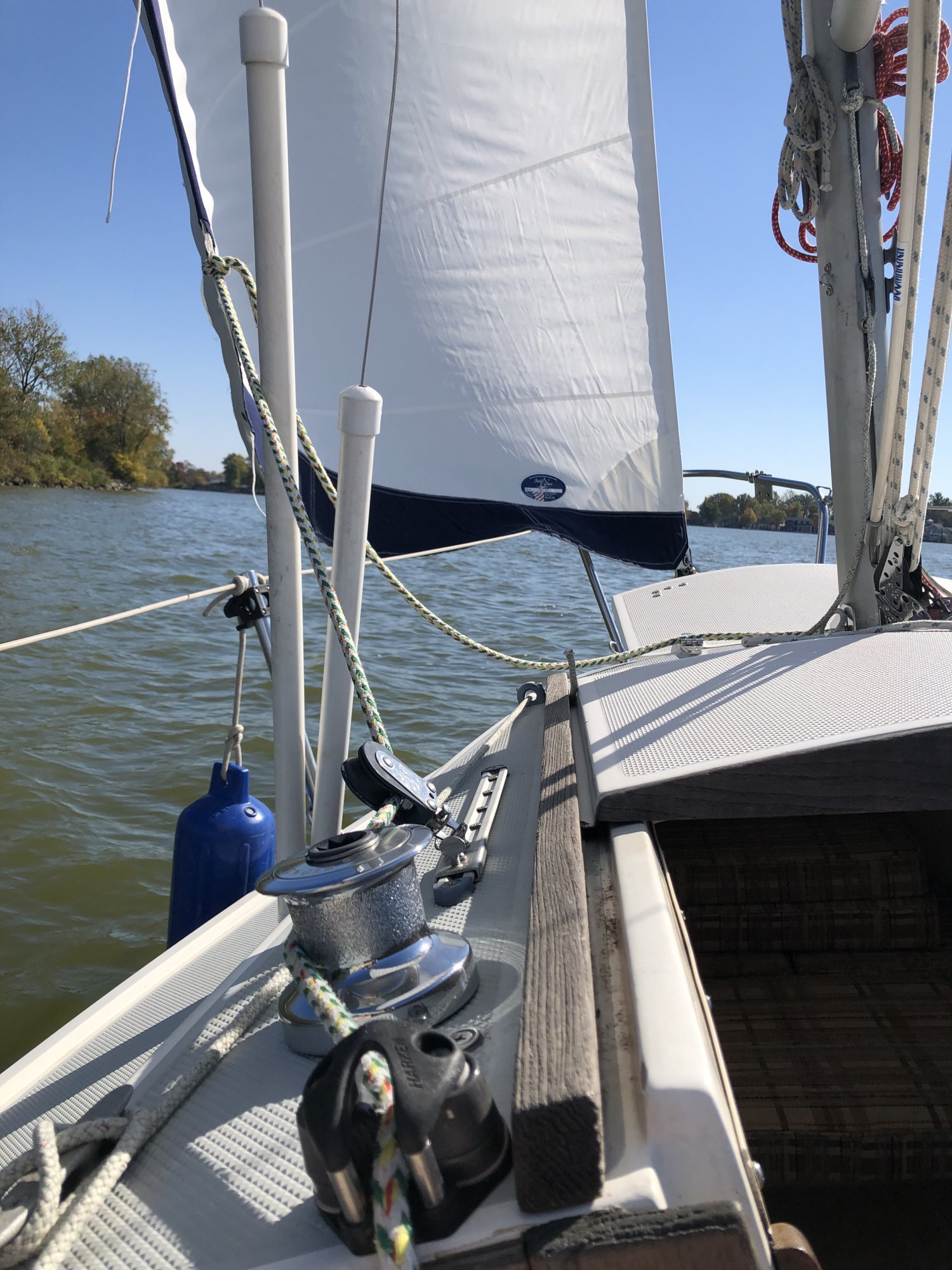

Correct, no travelers for the jib on mid-ship, either side of the cockpit. The current jib sheet is routed through travelers mounted on either side of the cabin hatch and secured with a cam cleat.
Attached is a photo showing the jib on port tack. An additional picture showing the full side of the Capri with a wrench and cleat mount aft of the cockpit.

Actually, the boat is on a stbd tack because the wind is coming from the stbd side of the boat . . .
That said, could you move the cam cleats farther aft, or perhaps install new cam cleats farther aft?

The pictures help.
In the photo of the boat sailing it appears the jib isn't fully trimmed for pointing and the tracks on the cabin top aren't helping. That's how it looks to me.
So, I think the jib might be happier being led to a block on the deck near to the rail and hence back to the cockpit winch and tied off on that black cleat. It would run outside the upper shroud. You would have to plan the angle the sheet meets the winch in horizontal and vertical dimensions to prevent over rides.
Unfortunately it is hard to test placement of the track or block. You can learn a lot using the time tested method of placing your foot on the sheet in various places until you like what you see.
How much do you move your jib lead. You may save yourself the trouble of putting track down and just put a block there.
You can buy sailboat hardware online. West Marine, Defender, Rig Rite, Amazon etc.
But first go sailing with crew that can drive upwind, and re-route those sheets to the aft winches and figure out where to put a block or track and how high it needs to be.
Don't be surprised if you find you like the existing setup better.

The sheeting angle around the outside of those shrouds doesn’t look right to be. I suspect that the design intent was to have the jib sheet inside the shrouds straight to the tracks on the cabin top.
I’d try running the sheet inside the shrouds, through the existing block on the track, back to the block behind the cockpit winch, then forward to that winch. If the sheet can make the run between the two blocks without fouling anything I think that might be best. If the sheet fouls on the cabin top or itself you could add a new block on the deck in front of the winch, somewhere that the sheet can run cleanly. You could replace the existing track with a new one on the deck somewhere in front of the winch, but I suspect that will give you a worse sheet angle when you want to point upwind.
What Joe said about the captive cam clears behind the winch is right - those are not the right kinds of cleats for a sheet. If you try using the winch they’ll be very hard to work with. Also sheets always run clockwise around winches - the one you pictured will chafe the line running that way.
