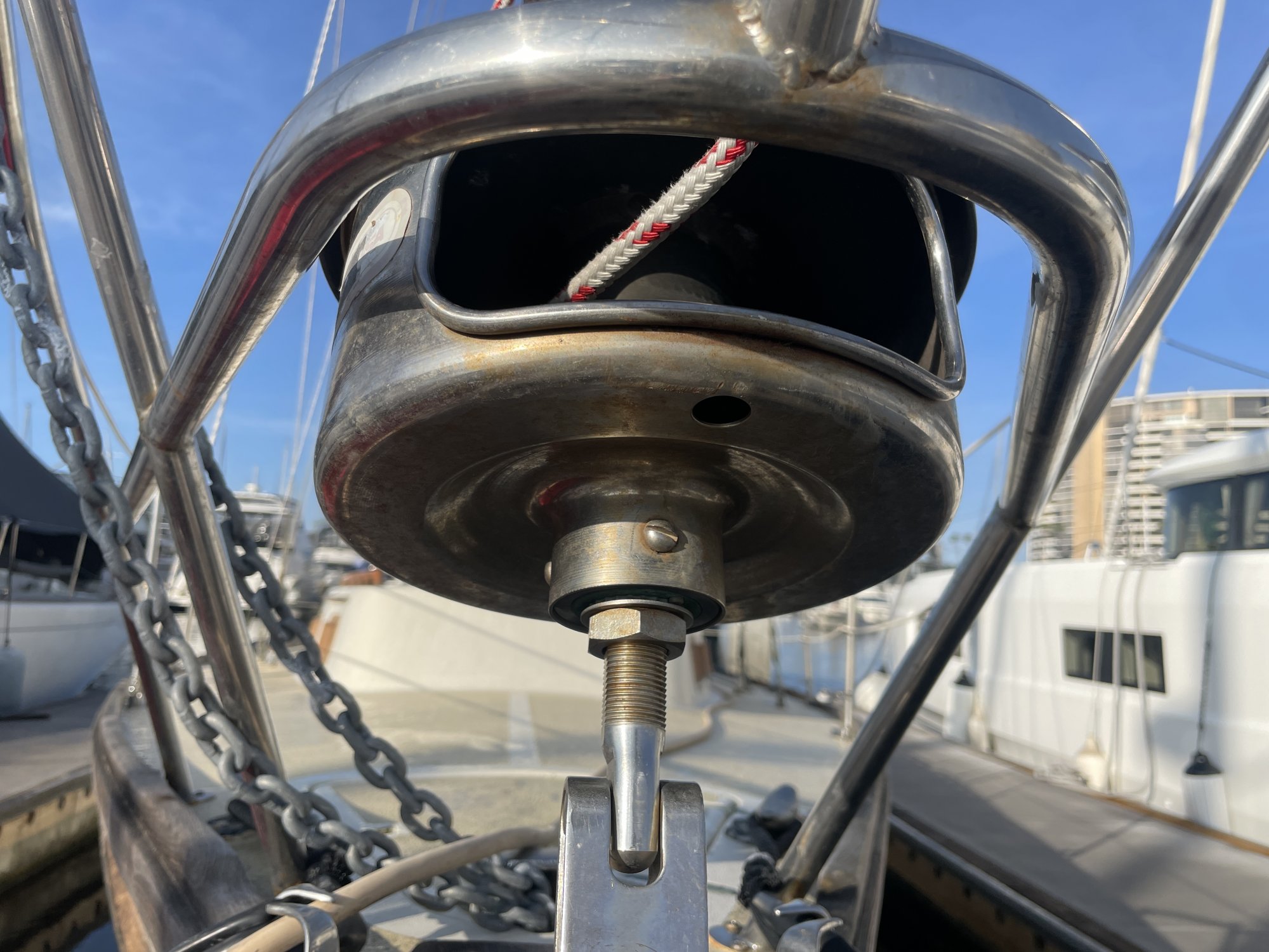

During recent haul out, when the rig was reinstalled, the opening of the furling drum got rotated 180 degrees and now faces forward instead of to back/port side. I did undo the forestay at the masthead to replace the retaining pin and maybe rotated it when i did? Im not positive, but if i did, does it need to be undone at the masthead and reversed or is it good enough to undo the rigging at the bottom and simply rotate it there, or can i simply rotate the drum and leave everything else alone?
14,278
Try just rotating the drum and leave everything else. You'll have to do this before you run the furling line back to the cockpit. Same thing happened to me last time I stepped the mast.

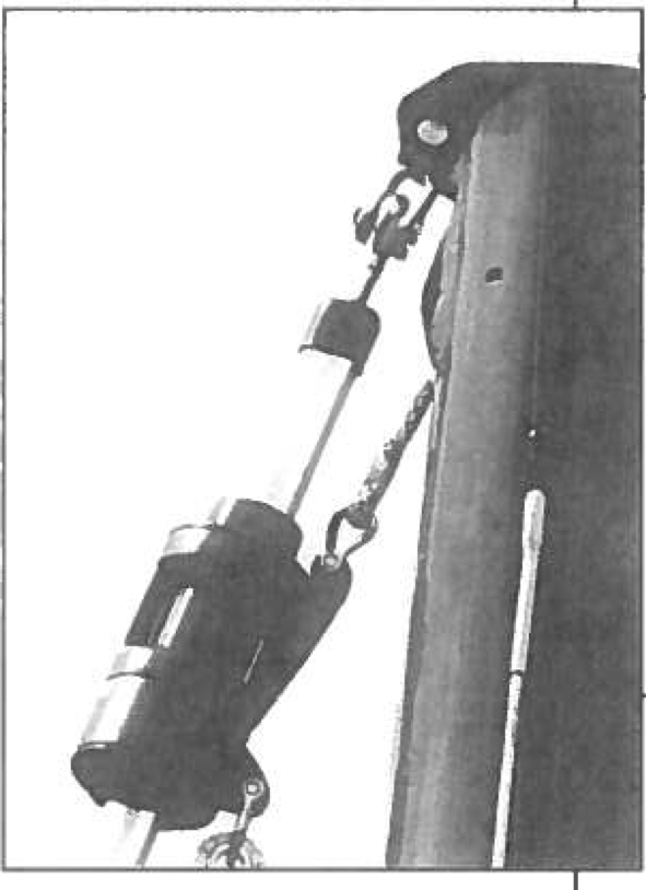

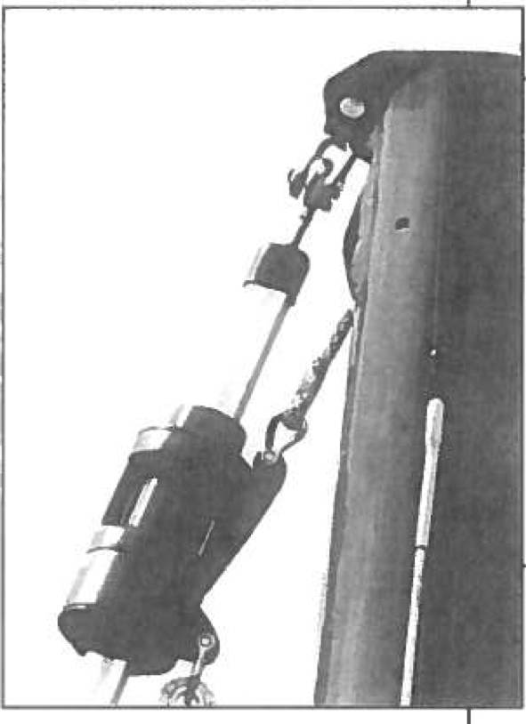

I am clarifying the issue in my mind. Your concern is the drum furler at the bow. When you look at it, the opening for the furler line is pointed forward over the bow. There is nothing regarding the swivel at the mast top. It is oriented so that when you raise the sail, it is positioned as in this image.
When you look at the extrusion, the slot opening for the sail is directed back towards the mast.
If this is the case, you only need to adjust the drum opening. It should be able to be released. You then rotate the opening towards your desired furler line route.
Thanks jssailem. Yes, all of that is correct. Only the drum is facing forward. I was at the boat this morning but couldnt stay long enough to mess with it. There are four screws in the drum that look like if they are loosened it may rotate freely.
24,926
Sweet. That is where I would begin.
It is very easy when assembling a forestay and furler not to align the drum properly.
