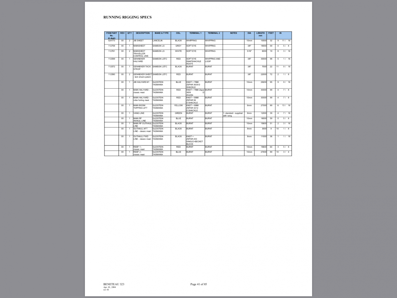

Line lengths for my Bene323 are on one of the pages in the owner’s manual. The good thing about it is that the information included is the length in both english and metric, the diameter, the color, type, and brand.

I have one application question though:
My jib winches are Lewmar 30s, The sheets on my asymetric are too heavy, that’s a given.
They are 3/8 diameter, and I prefer not to use a single sheet. Does anybody have experience with lighter, smaller diameter sheets that will still self tail on the winches?

On a 32' boat any sheet smaller than ⅜" is going to be hard on the hand and difficult to grip. One option is to go with line where the cover can be stripped. This way the end at the spinnaker is light and thin and the end you grab is thicker. Or get a thin high tech line and add a cover to the tail, again to make it thicker and easier to handle.

Doug, I took my B323 owners manual apart and put it in page protecters and keep it at home. I printed out the manual and again did protectors and keep it in a notebook on the boat to post changes I make. I am looking at the line selection chart on page 41. I got the spinnaker package when I bought the boat. That included the 30 winch on the cabin top, line stopper, and the spin sheets as in the manual. The sheets came with the boat, but no spinnaker. The sheets are 72' of 3/8 StaySet LSTC. The 3/8 has been okay on the hands.
WHILE WE'RE AT IT, since someone post a chart with suggested line lengths... On my B323, I led my running lines to the helm wheel and cut it there. I found I could cut 17 or 18 or 19 or 20 feet off of the various lines and still be able to trim from the helm. The topping lift I increase from 86 to 95 to get it to the cabin top winches.
