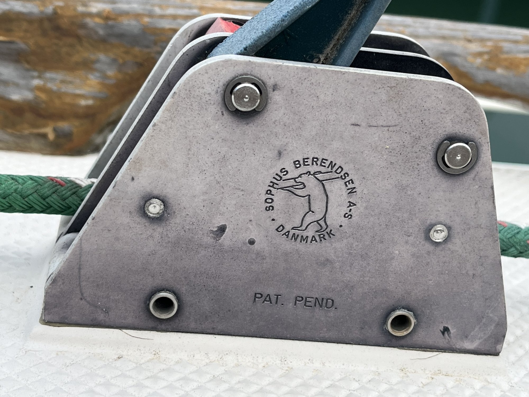

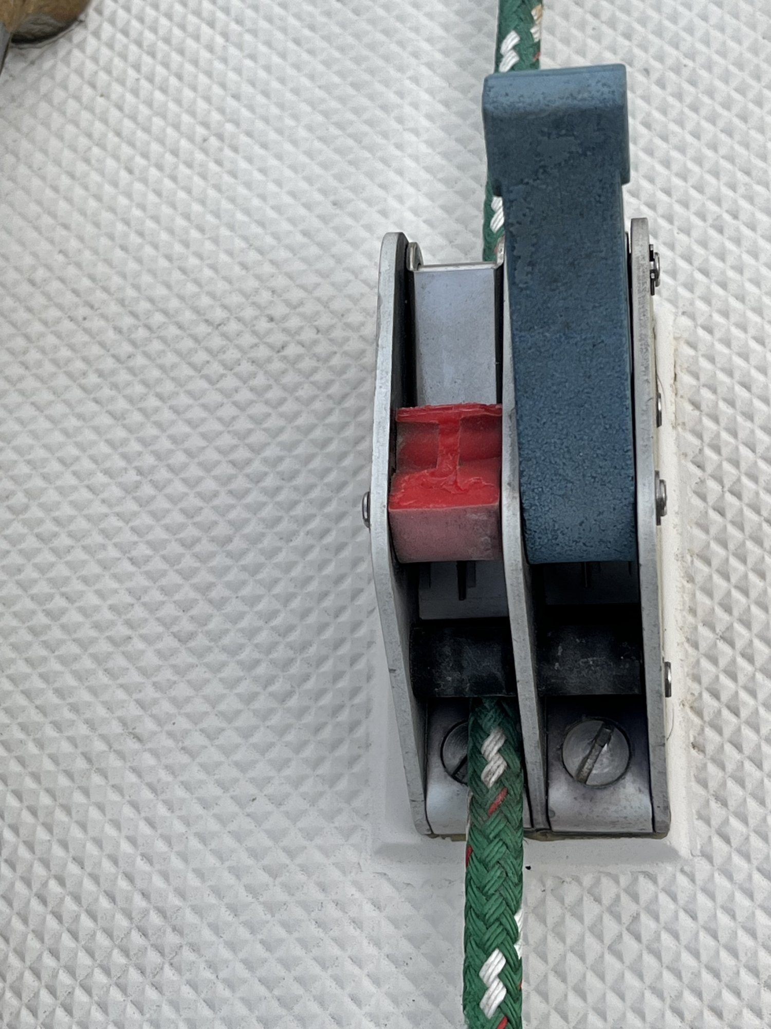

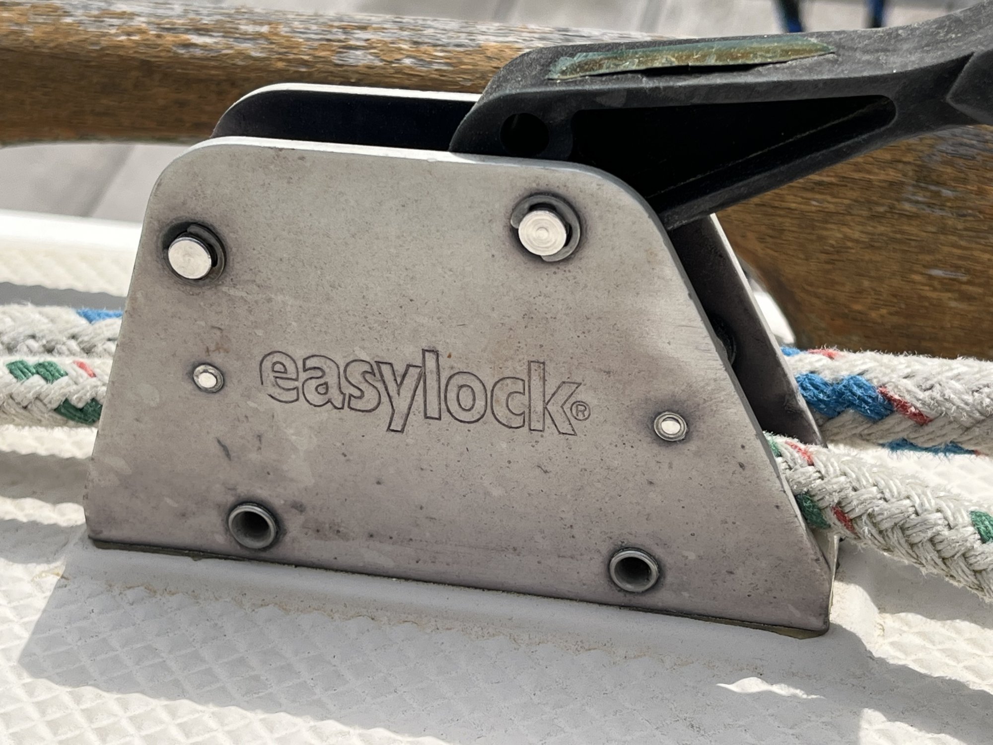

My C27 has the Sophus Berendsen EasyLock clutches that need replacement or repair. One of the handles broke off, and the lines do not run easily (which I suspect is age or fat lines from the previous owner.)
Reading through some threads on this forum, if I want to replace with new clutches, it looks like I have to drill and tap new holes in the underlying aluminum plate.
I would assume this is not possible if
  • the hole foot prints overlap
  • the screw diameters are different
Has anyone had that problem?
I don't find footprint patterns in the on-line literature of new clutches. I assume I will have to contact sales support to get that, or am I missing something?

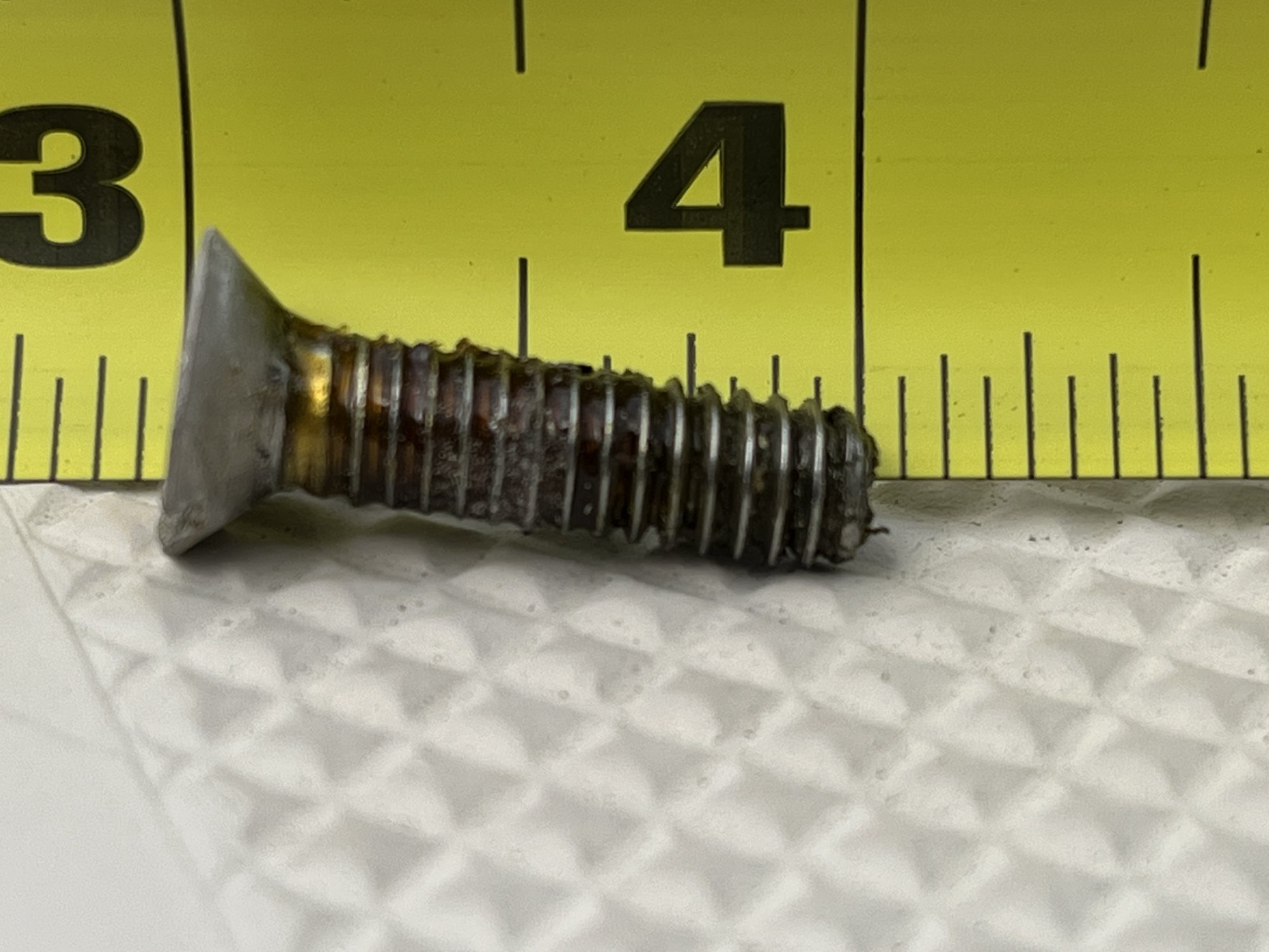

The footprint of the SBs is 0.83 (21mm) (side to side for the double clutch) and 3.35 (85mm) end to end. Pic of the screw is below.
Lastly, the boat is a C27. What is the good quality/value brand? - something that is well made and made to last, but not high performance racing?
Thanks!

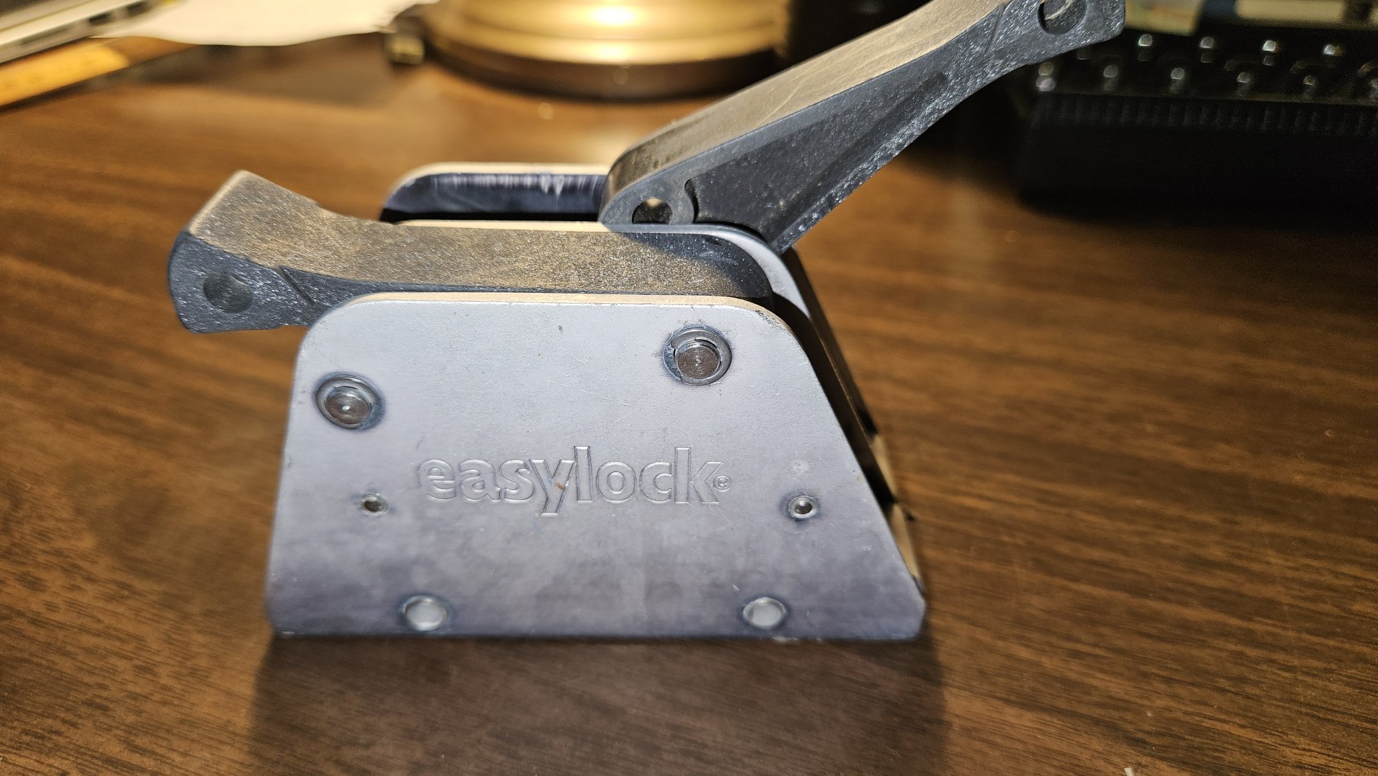

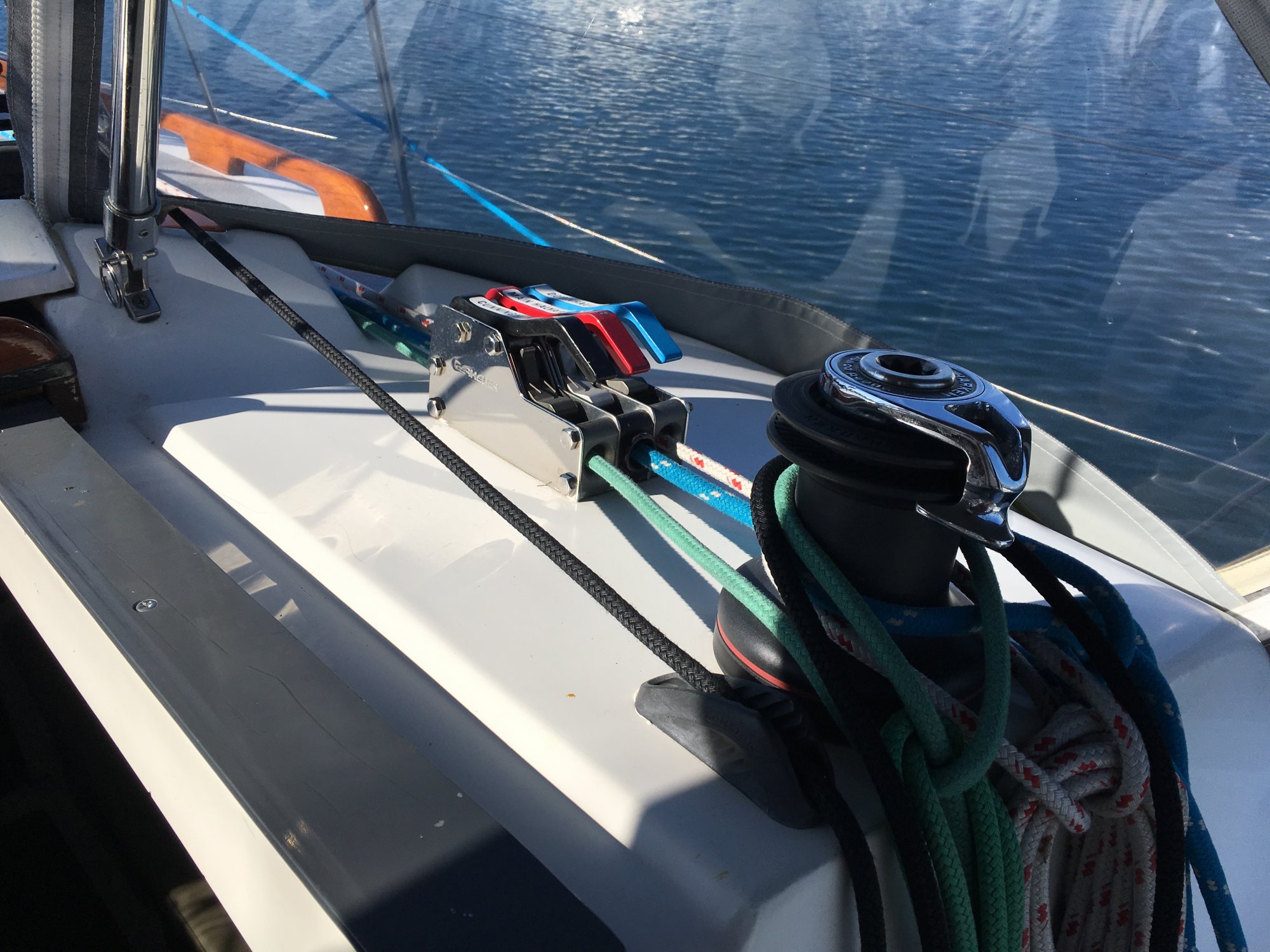

Staying within that footprint narrows your options. It looks like, though you showed two different clutches, it is the Sophus Berendsen clutch that is broken. If so, you might be out of luck for a direct replacement. Too bad it's not the EasyLock because it looks like you might be able to get replacement parts, as BSI Rigging seems to own that brand now. Though, it isn't clear to me that it is the same design, since they only show the updated version on their website. Still, it might be nearly identical:
A replacement arm: Easy lock 1 Spare Parts - BSI Rigging
Template: https://bsidk.com/app/uploads/sites/10/2022/02/MINI_hole-template-6.pdf
Not sure if that helps you, since the broken clutch is something else.

Why not just replace the handles
I saw the ones in your link. I am unsure if they are the same handles. Mine are 0.94 x 0.71 inches at the pin end (rotation as shown in the RigRite picture x side to side as the pin goes through respectively), and are on a Sophus EasyLock. Rig-Rite states theirs are 0.81 inches wide, don't give a third dimension, and are for EasyLock 1.
If you know that they fit the EasyLock or some updated EasyLock 1. If you know, please clarify.

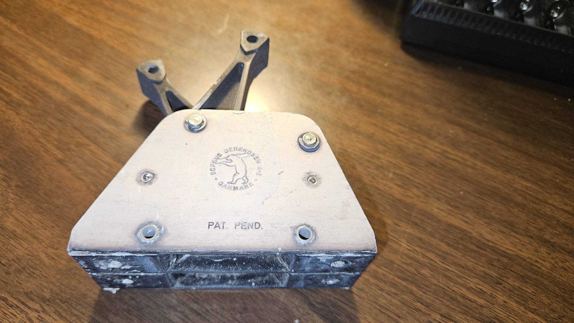

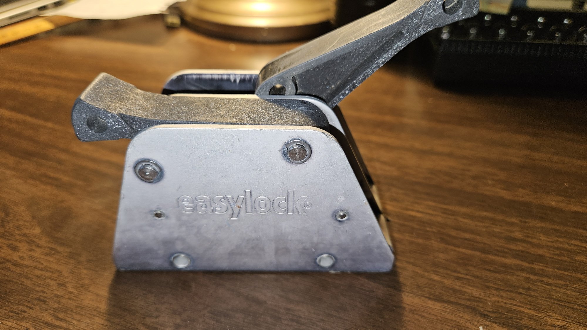

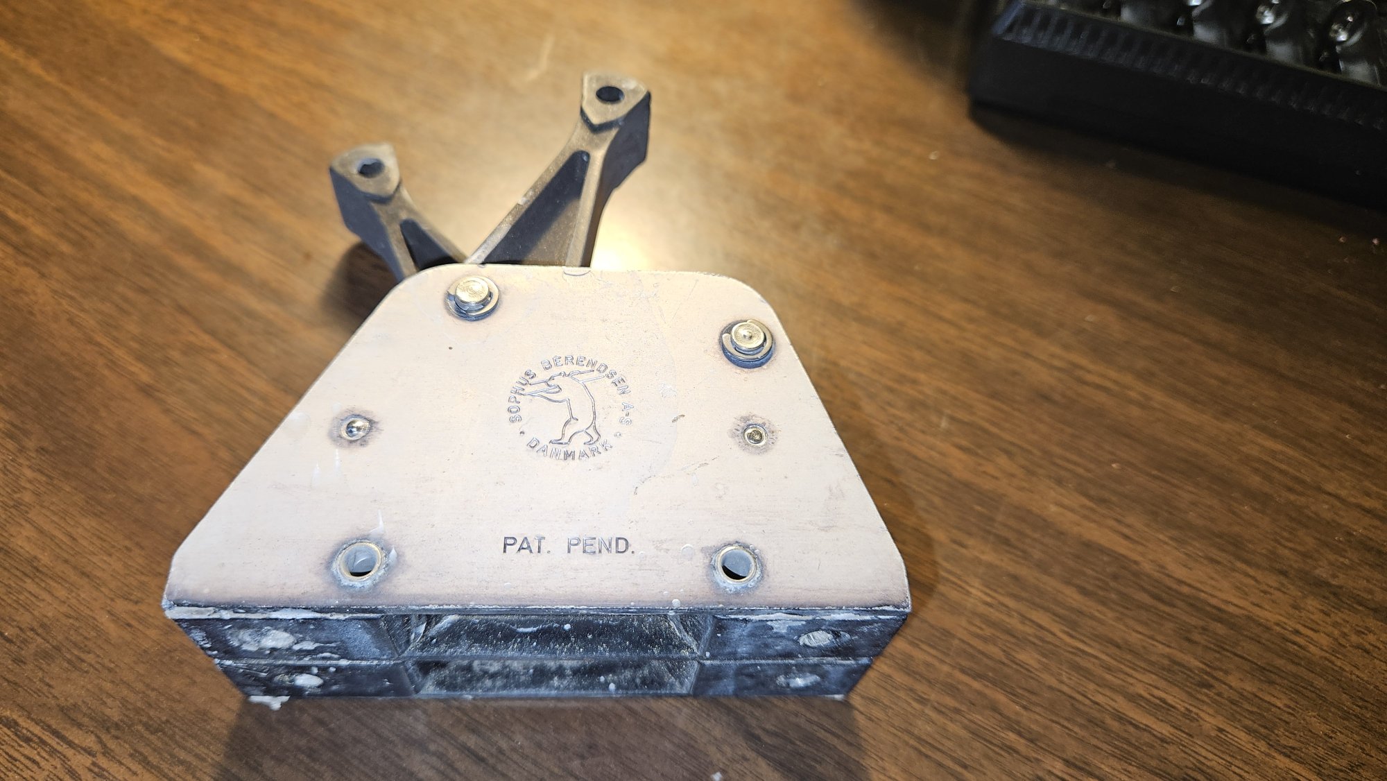

I have this old double clutch that you can have. Just compensate me for packing and postage.
