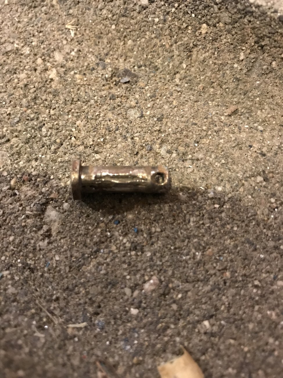

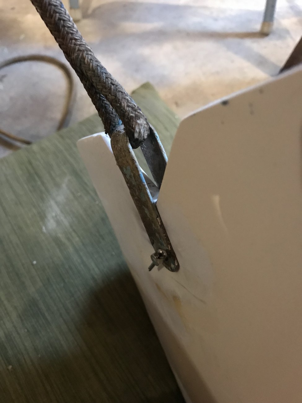

Here are some photos of my pendant and clevis pin from a 222 that I'm restoring. The clevis pin is split/corroded, so it's probably original, as is the pendant. it's my understanding that some centerboards have a notch where the shackle attaches and some do not.

I was able to send the last email with the photos of the centerboard pendant only because my boat is off the trailer which allows me to get at the centerboard. Once I replace the pendant and pin, I'll put the trailer back under the boat and finish up some topside issues.

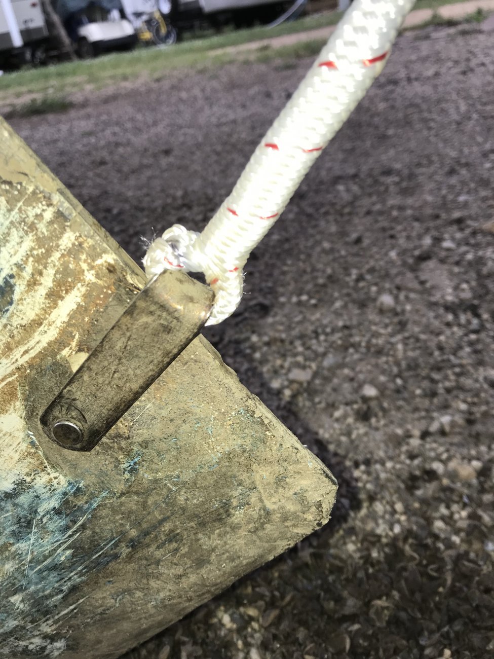

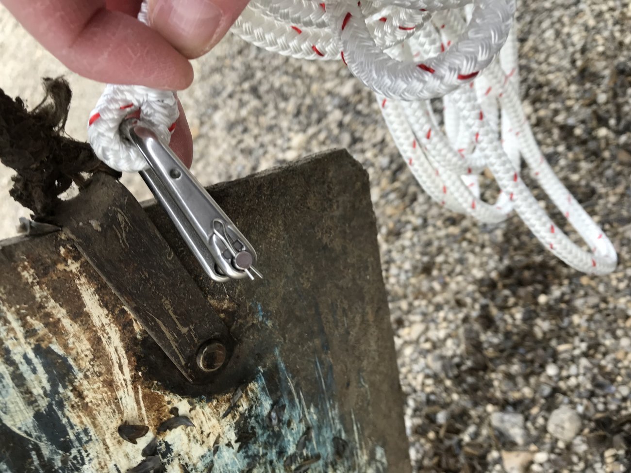

I replaced mine this spring, only because I could not drop the centerboard due to zebra mussels jamming it and had to put it on a lift to scrape them out. It had probably been 10+ years since the last time I had it on a lift and replaced the pendant. I ordered the one from D&R Marine, but the shackle was too short - it may have worked if the centerboard had a notch, which mine does not. I reused the old shackle since I had no other option in the one day it was up. The line was worn almost through, so I may schedule another replacement in 8-10 years... Now that I have photos, I may find a new shackle and splice my own line next time.

I asked about a thimble and Rudy said he's never put one in, so I just bought what he had. With the width of my shackle, the thimble would have to be quite large and probably not leave enough room to let the shackle pivot. I did not measure the original shackle, but if you need the measurement of the new one that came with the pendant that was too short, I could locate that and measure it and you could extrapolate the length from the photo...

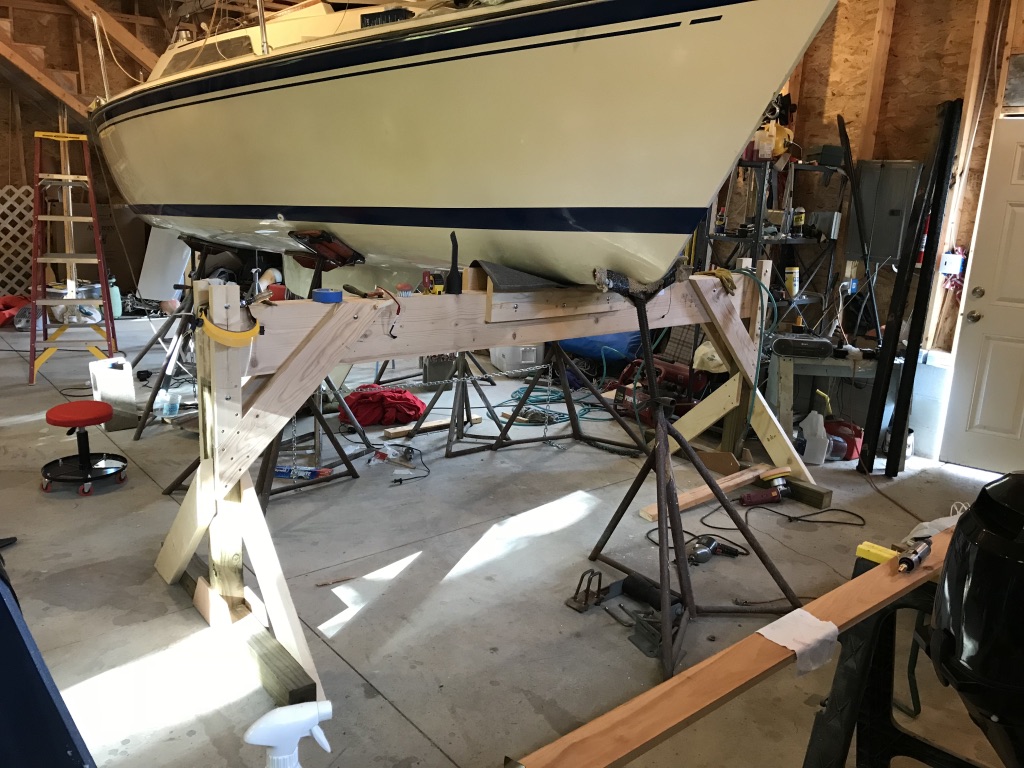

I had found a simple beam arrangement on-line to facilitate taking the trailer out from under the 222 without moving the stands every 2 feet. It worked great and greatly simplified the process. The beam is made up of 2 10' 2X10's. The rolling stool in the lower left was a back saver for the centerboard and hull work I did as well. Pretty cheap at Harbor Freight. Can't have too much support when you're working underneath.

I used Craig's lift for my Mariner and he said he wouldn't lift anything heaver than that. Maybe I'll talk to him to see if he has another arrangement.
If I had those facilities, that looks it would work nicely! Is that a brilliant shine I see on the bottom? Wowzza.

Yes it is a shine. This boat had a thin coat of bottom paint and had been in fresh water for a couple of decades before I bought it. It was uneven and I didn't like the looks of it, so I stripped it off. I'm planning on trailering the boat for the next few summers along the Maine coast and it won't be in the water for more than a week at a time. With that, and a little buffing, I didn't want to cover over the shine.
