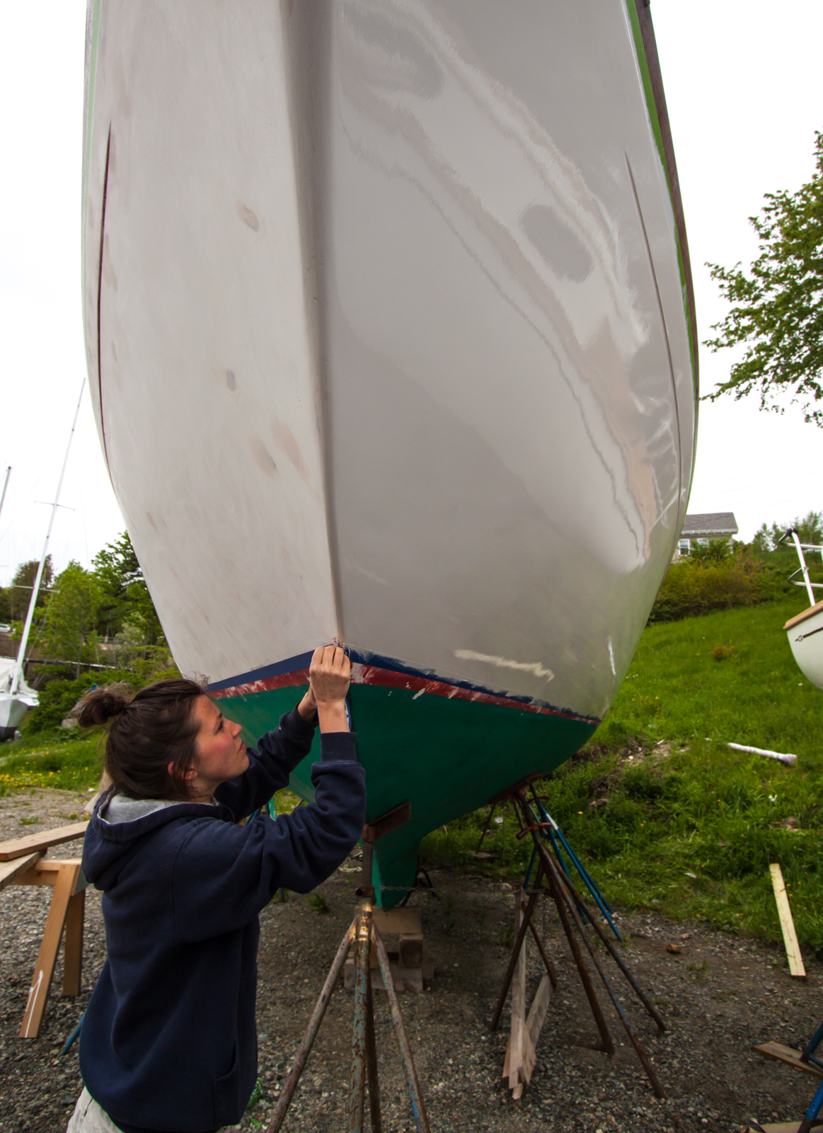

Time was tight this year so I did about 10% of the 90% of prep work I could have completed(I'll do a better prep job in 2021).

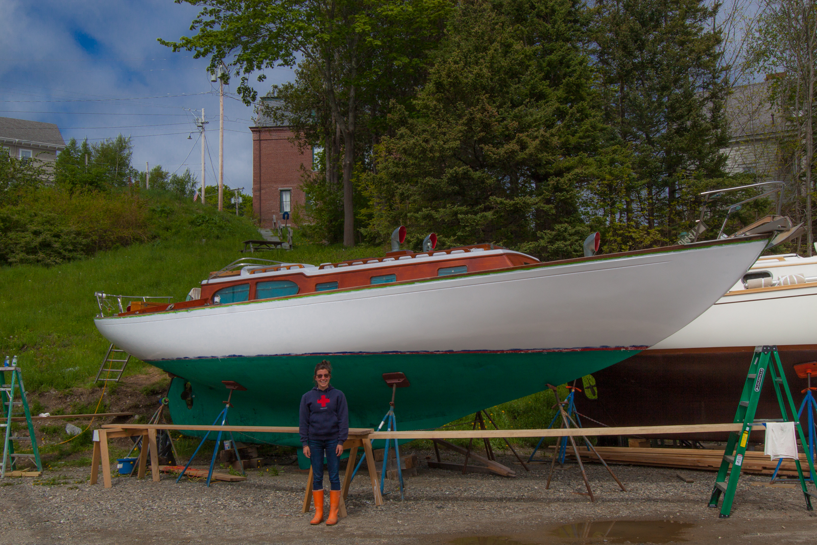

With taping off of the toe rail and the bottom complete, the staging set on the port side, it was time to find out.

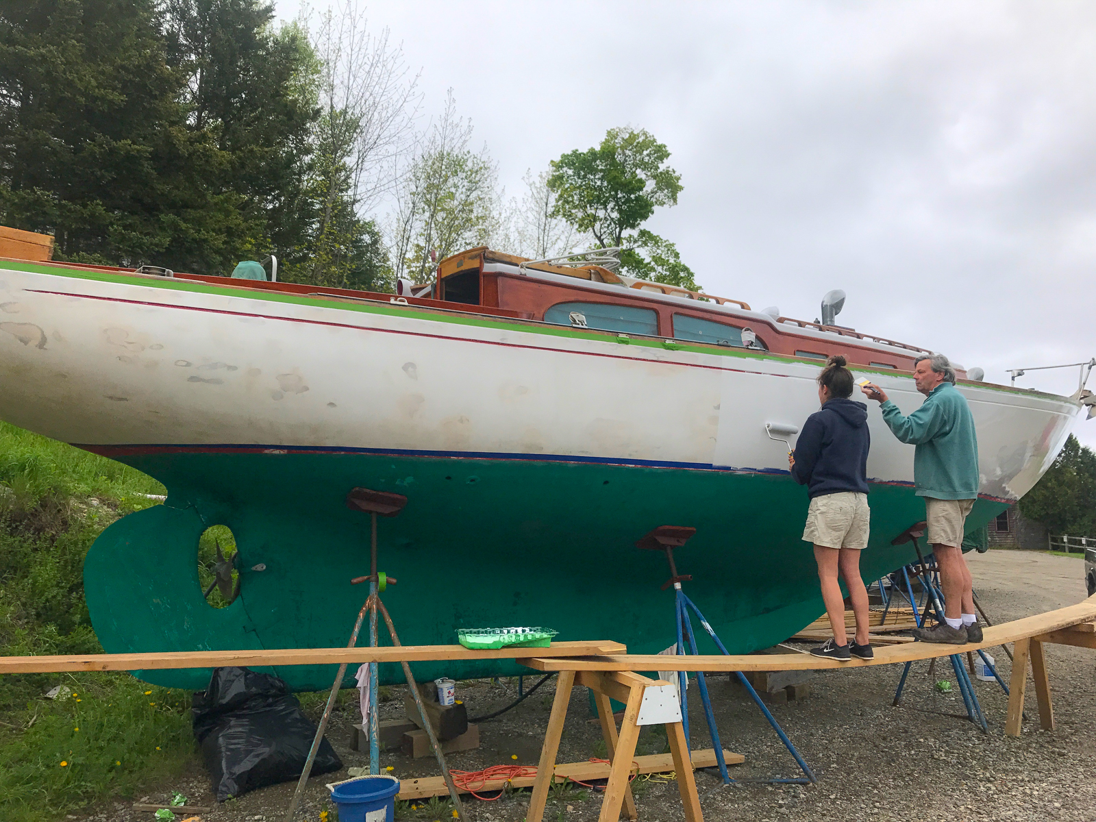

With a roller pan full, we were off: We started at the stern where I explained the process to Mary Jane.
She caught on quickly but we adjusted her speed and rolling method until timing was feeling right. Here we are at the 'waist' of the port side. She was taking photos to document.
This is the holy grail of the process: MJ has just rolled on about 2 feet of evenly distributed paint(air bubbly patch in front of me).
I brush the paint in a checkerboard pattern (my preference), and finish with complete light strokes from toe rail to bottom tape. The cove stripe gets extra tipping as it can catch paint that will sag and run.

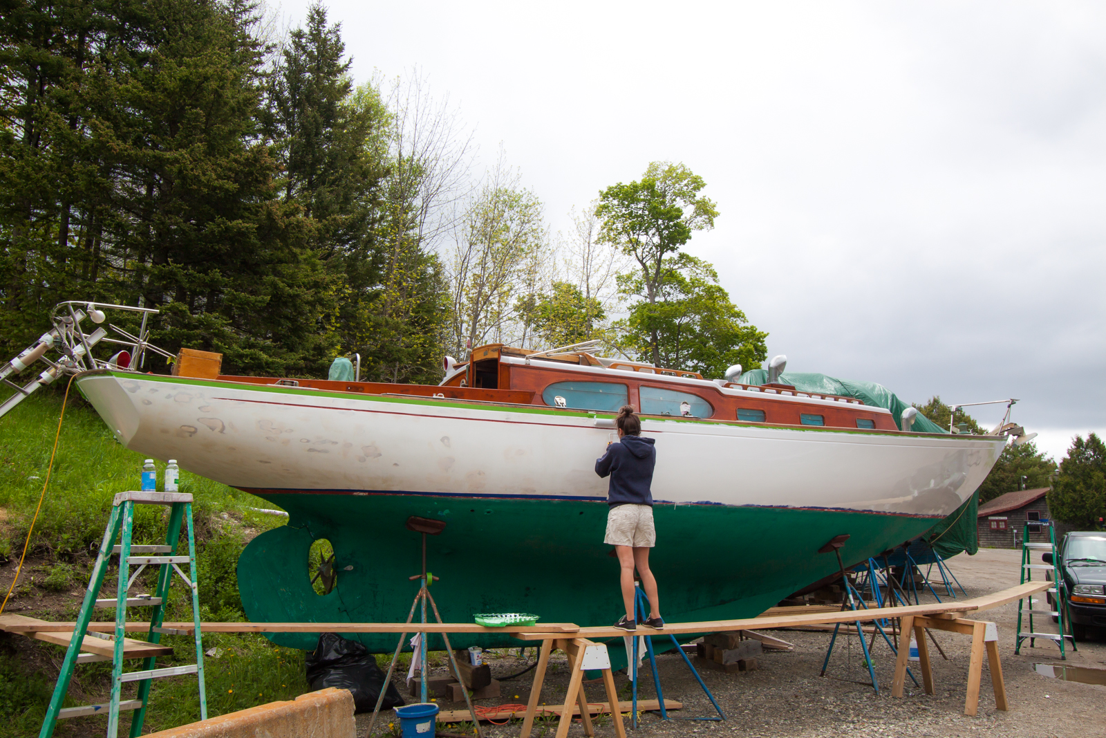

Here's a shot of the critical staging. Staging makes all the difference in any task (I'm a builder), especially boat work.

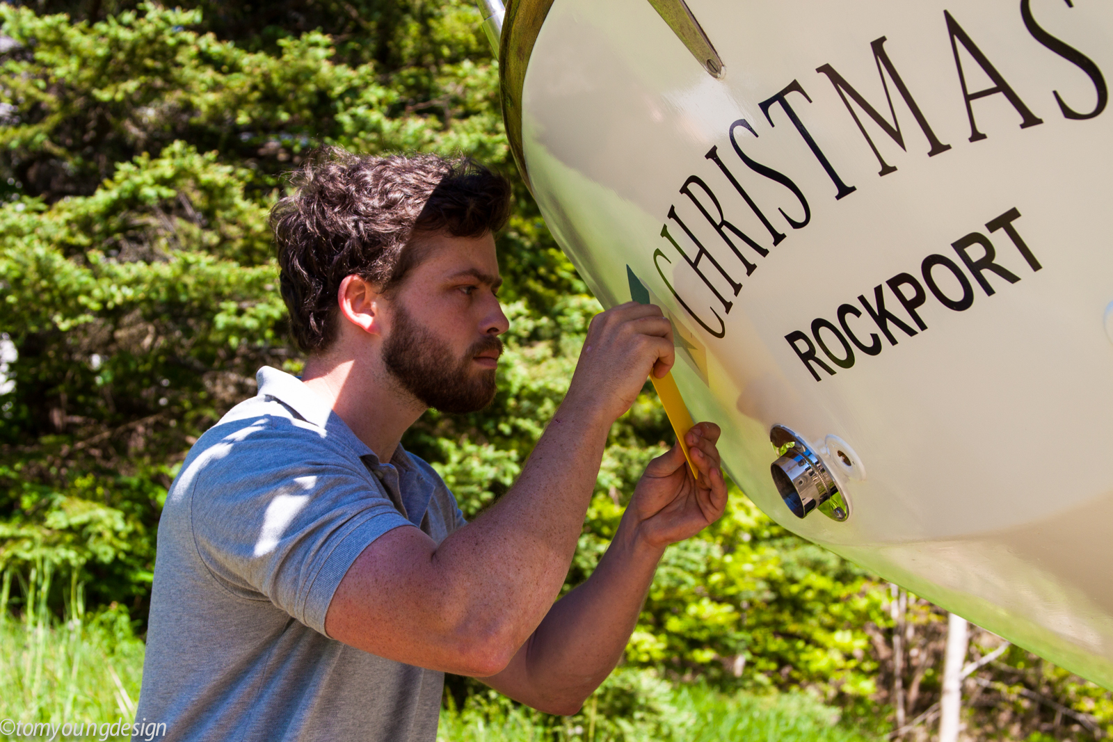

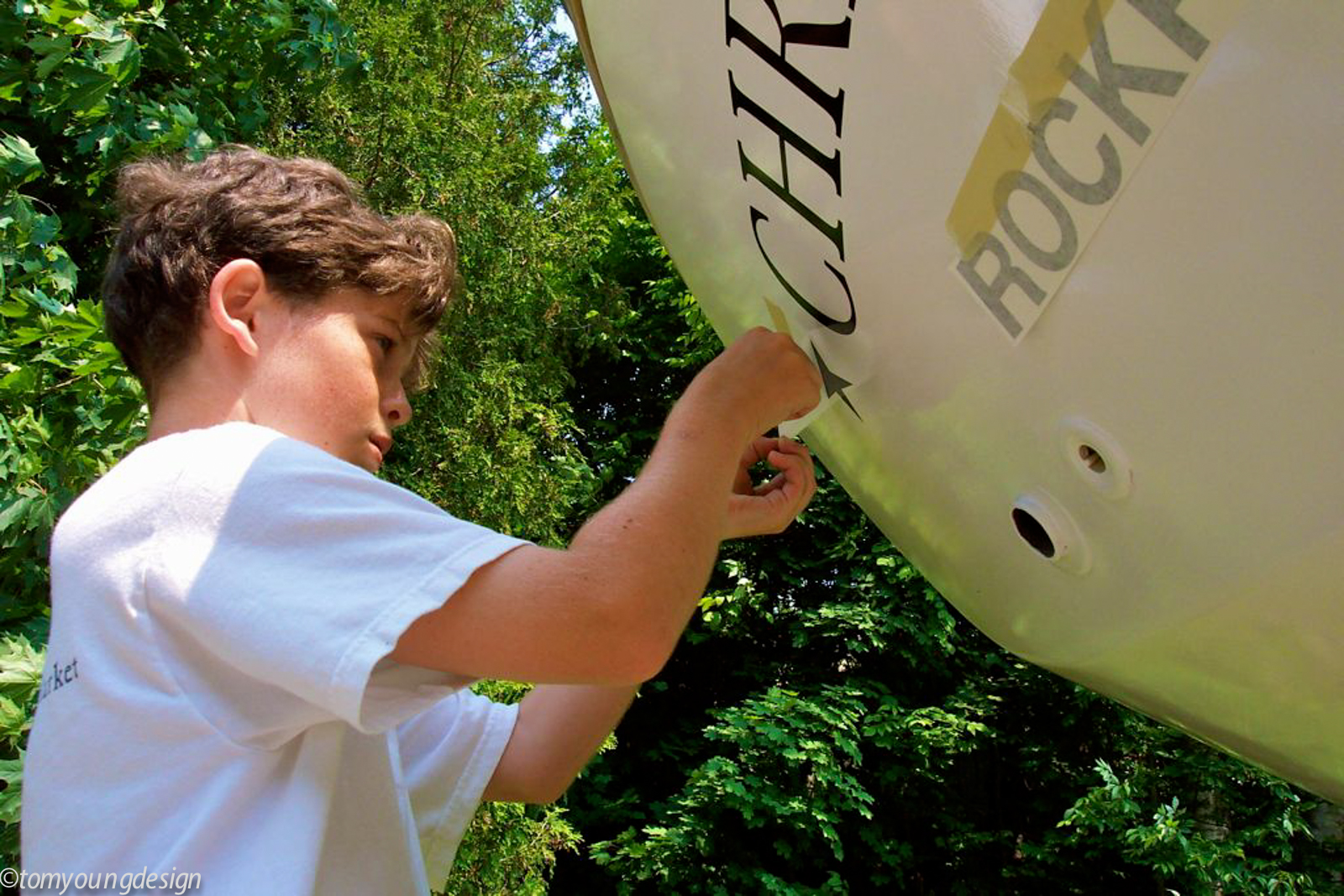

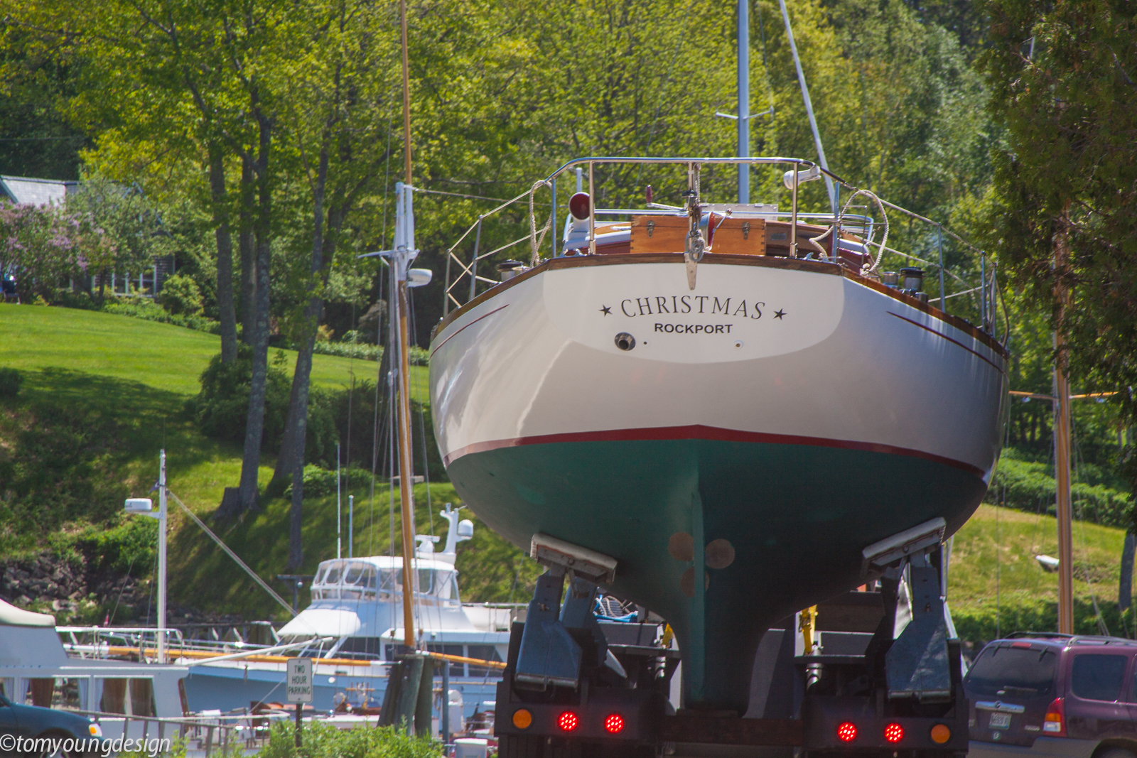

A beloved boat, new or old, becomes a part of a family. Our old boat is a piece of our family history. Taking care of CHRISTMAS, is a labor of love.
Our son applying the stars to the transom in 2002.
And this week, 15 years later.
