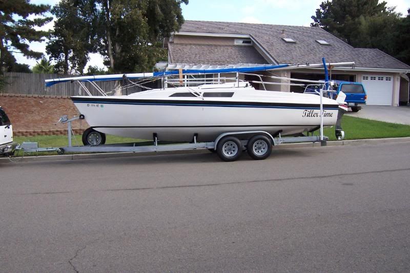

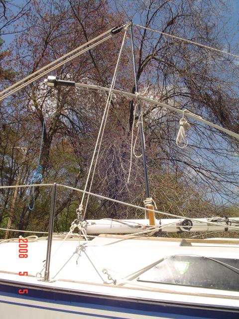

I trailer my Mac26S with the CDI furler and 150 genoa sail rolled up, all the time, as do many others I know of. It does make it a little more difficult to raise the mast. But I use a mast raising system, which makes it not a problem.
I keep everything laying on top of the mast, secured with ball bungees. I use an 8 foot length of PVC gutter to keep the overhang from bending, also lashed with bungees. In doing so there is no sidways pressure exerted on the top of the headstay.
Sumner
Jan 31, 2009
5,254

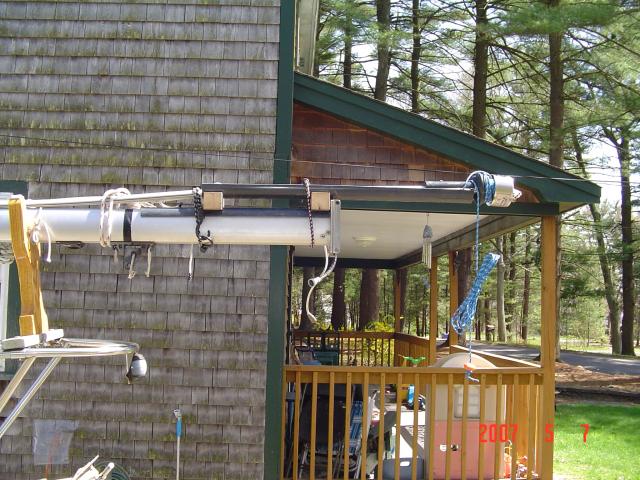

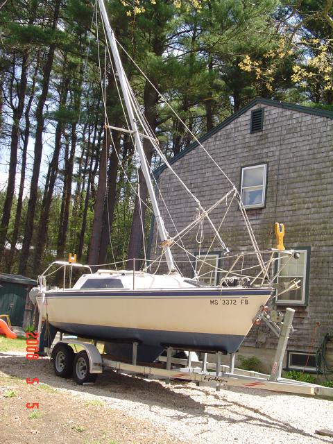

Your Mainsail can be............... I also tie my furler to the Gin Pole using a lineman's "Rolling Hitch." This keeps the roller furler from flopping around when the is being raised or lowered............Joe
Thanks Joe, I like the idea of putting the furler on the gin pole. We bought a CDI over the winter, but still don't have the boat outside and I have to have a new forestay made up, but like what you did with the toggles at the top. I know some of the guys leave the furler attached at the mast and support the front overhang, but I think we will remove it like you do while trailering, since we trailer so far.
I'm also thinking I could add a short side extension to my gin pole and then tie the furler to it a little above the top of the gin pole, so that as the gin pole and forestay come down to the deck the furler is held up off the deck. Probably not a big deal to you as you don't go on and off the trailer as much. Also my gin pole is shorter and comes down to the deck well aft of where the forestay pins.
Anyway thanks for the pictures and ideas,

Sum,

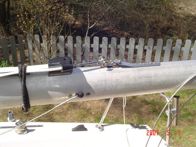

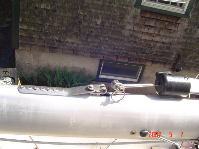

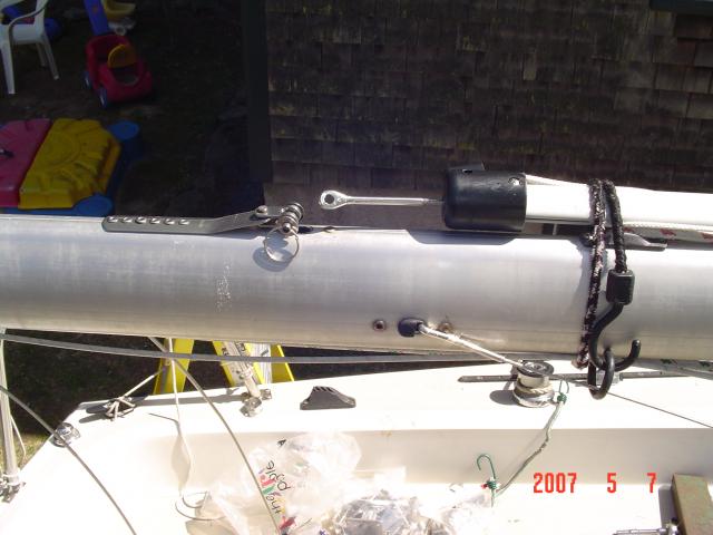

On that toggle strap set up; you will need to use your Dremel Tool to grind the strap a little so that the rigging pin will act as a toggle from a turnbuckle.
For the furler drum support; I took a piece of 2" PVC and cut it in half lengthwise and screwed it togother to shaped wood blocks. My late friend Walter got that idea from the Mac site.

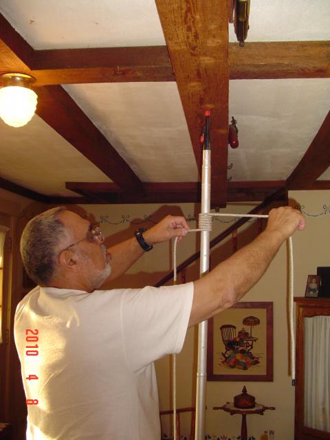

You won't need to add anything to your Gin Pole to hold your furler luff if you use a lineman's "Rolling Hitch". You're going to have to make the call on tying it around the furled Gennie though. Dog brought up a good point about using a bag around the furler drum while the boat is enroute to the ramp, but I would even go a step further and bag the whole sail too, or cover it with something like a long sock.
To tie the lineman's "Rolling Hitch" you take about six CW turns around the luff, hold the wraps and come down under the standing part of the rope and back up, and then tie two or three half hitches around the luff. You can move this hitch up or down by grabbing the wraps, but once you put a strain on the standing part, that hitch tightens up and won't move. You can tie this hitch to anything like ropes, lifelines stays, and spars including the mast. When you tie this to your furler luff to raise or lower your mast, tie it about a foot or two above your Gin. Then tie it to your Gin Pole about 2/3s of the way away from your mast. I usually pull it tight to the Gin and use a Round turn and two half hitches. Then I take the same line and go around the luff and tie a couple of more half hitches around the Gin Pole entrapping the furler luff to the Gin Pole. I'm adding some pics so that you can learn this hitch. I assure you that it's a hitch that you'll use over and over again and it's so simple to tie.
Joe

On that toggle strap set up; you will need to use your Dremel Tool to grind the strap a little so that the rigging pin will act as a toggle from a turnbuckle........... I'm adding some pics so that you can learn this hitch. I assure you that it's a hitch that you'll use over and over again and it's so simple to tie. ......Joe
Thanks Joe for all of that. I'll practice that knot. It does look like it will come in handy. If we do our planned trips this year the boat will be on the trailer for over 6000 miles, so we plan on having the genoa on the furler and the main both in socks. We don't want to have all of the road grime on them. Ruth will sew them up. Nice thing about a smaller boat is all of this stuff is also smaller :).

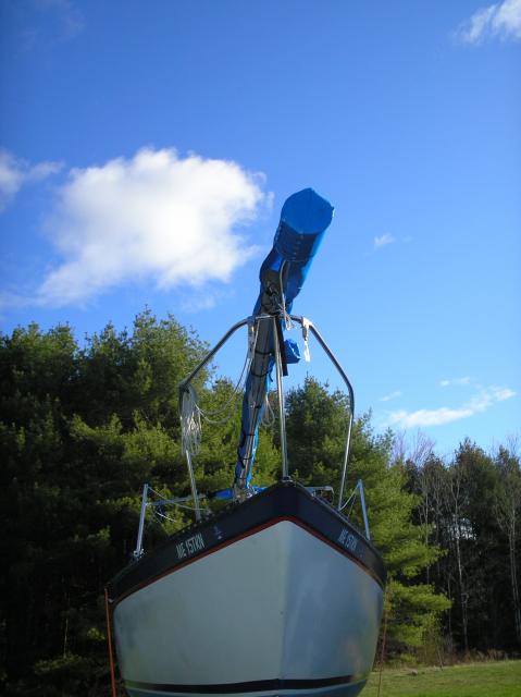

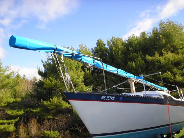

I'm a newbie, and a designer by trade. Not always a good combination. This winter/spring, one of the gadgets I've made for the boat is a mast cover. The idea is that all the straps for the mast and support for the furler are combined into one easy-to-install, easy-to-store package. It's almost done, a few more straps and final fitting. I've included a couple of photos. Maybe it will inspire you . . . or make you laugh. Not sure. The headsail isn't on the fail and not everything is tight yet, that's why it crooked. But the blue fabric and all the black straps are sewn together. No more bazzillions of bungees, straps, ropes, sail ties and the odd hank of duct tape for me.
Remember "Flashdance"? "I have to dance"? We'll . . . "I have to design". My house is filled sketches, projects and bad ideas.
Fair winds!
Don
Sumner
Jan 31, 2009
5,254
.... one of the gadgets I've made for the boat is a mast cover. The idea is that all the straps for the mast and support for the furler are combined into one easy-to-install, easy-to-store package. It's almost done, a few more straps and final fitting. I've included a couple of photos. Maybe it will inspire you . . ...........Don
Don that is a great idea. You can probably expect to see that copied by us :). We now use ......
....the bungees with the balls on the ends and that is fast and easy and what I would use if we were trailering a short distance. I can put all of those on in less than a couple minutes and they keep everything in place.
Our problem is we always have to trailer a long ways and now we will have the furler up there and I'd like to keep the genoa on it to free up the cabin area as we sleep in the boat on the road. I'd also like to keep the main on the boom and start keeping it up above and out of the cabin also.
To keep road grime off of the sails we were thinking of making socks for them, but your idea takes care of covering the sails and securing all of the standing rigging at the same time.
Another project for Ruth :) and if we do it I'll post pictures also. She also likes it a lot. I know what it is like to have those ideas flying through your head. I have a lot more than I'll ever build :cry:.
