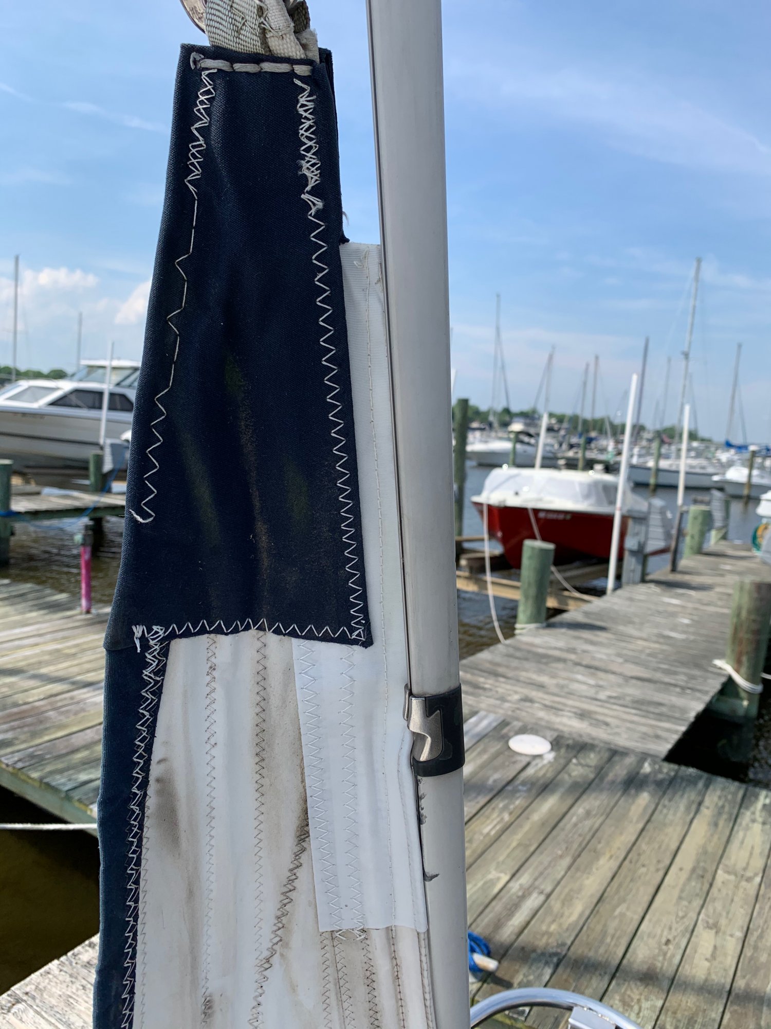

2) maybe there's some problem with the forestay tension? One odd thing I noticed: the foil (the part which fits around the forestay) looks a bit banged up just _below_ the feeder slot where the sail feeds in. Not too bad, but I have absolutely no idea how this could have happened.

Or it's just lubrication. Or something else. BTW: you can also see the minor bunging up on the foil just under the sail feed slot. No idea.

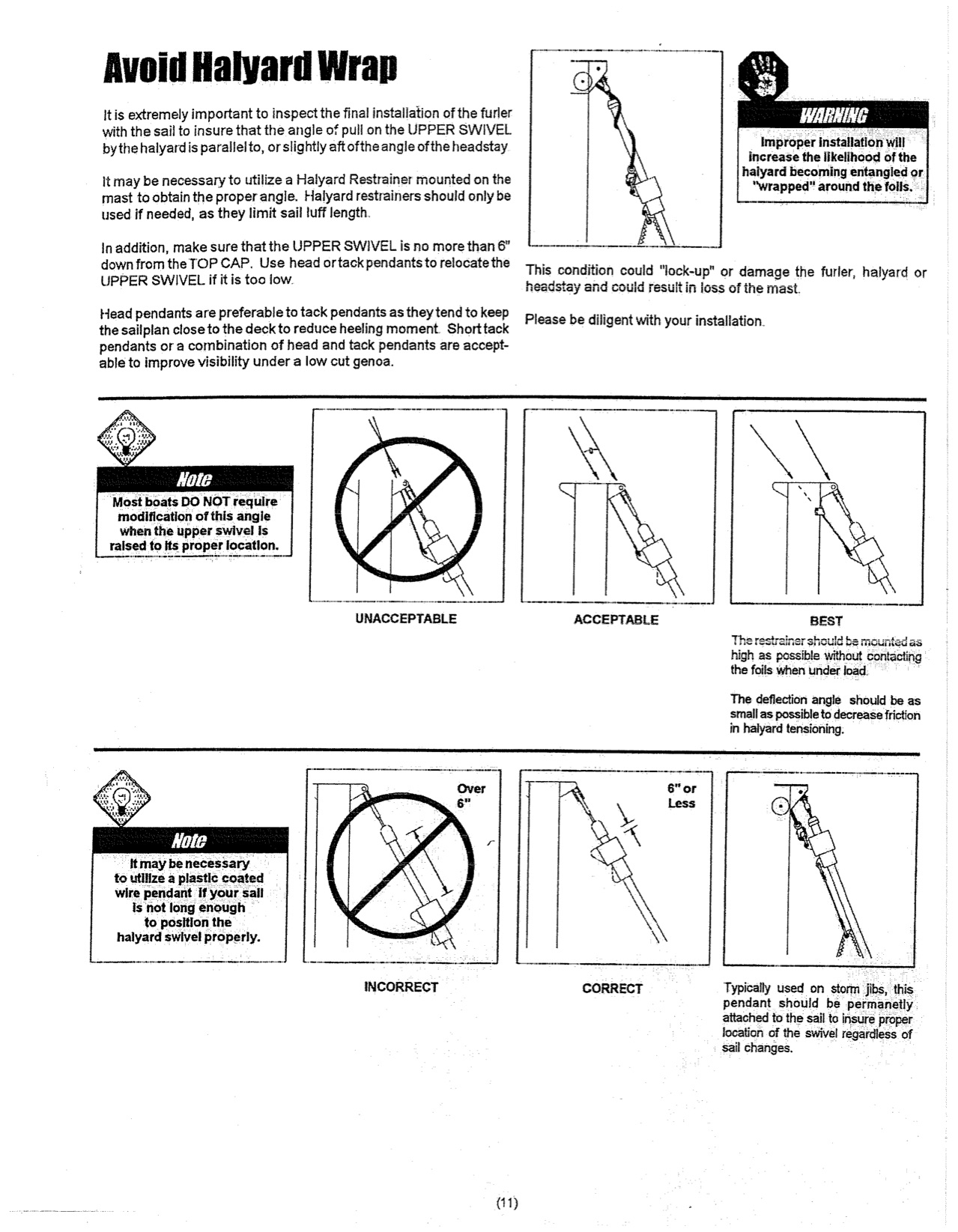

Take a look at it with some binoculars. Another possibility is halyard wrap, where the halyard gets wrapped into the sail as it is furled. This is caused by the lead from the mast sheave to the upper swivel. I doubt this is the case because the boat is older and it would have been discovered and fixed by now, but ya never know.
While you're looking check to make sure the halyard lead is fair and the halyard exits the mast and then goes straight to the upper swivel.

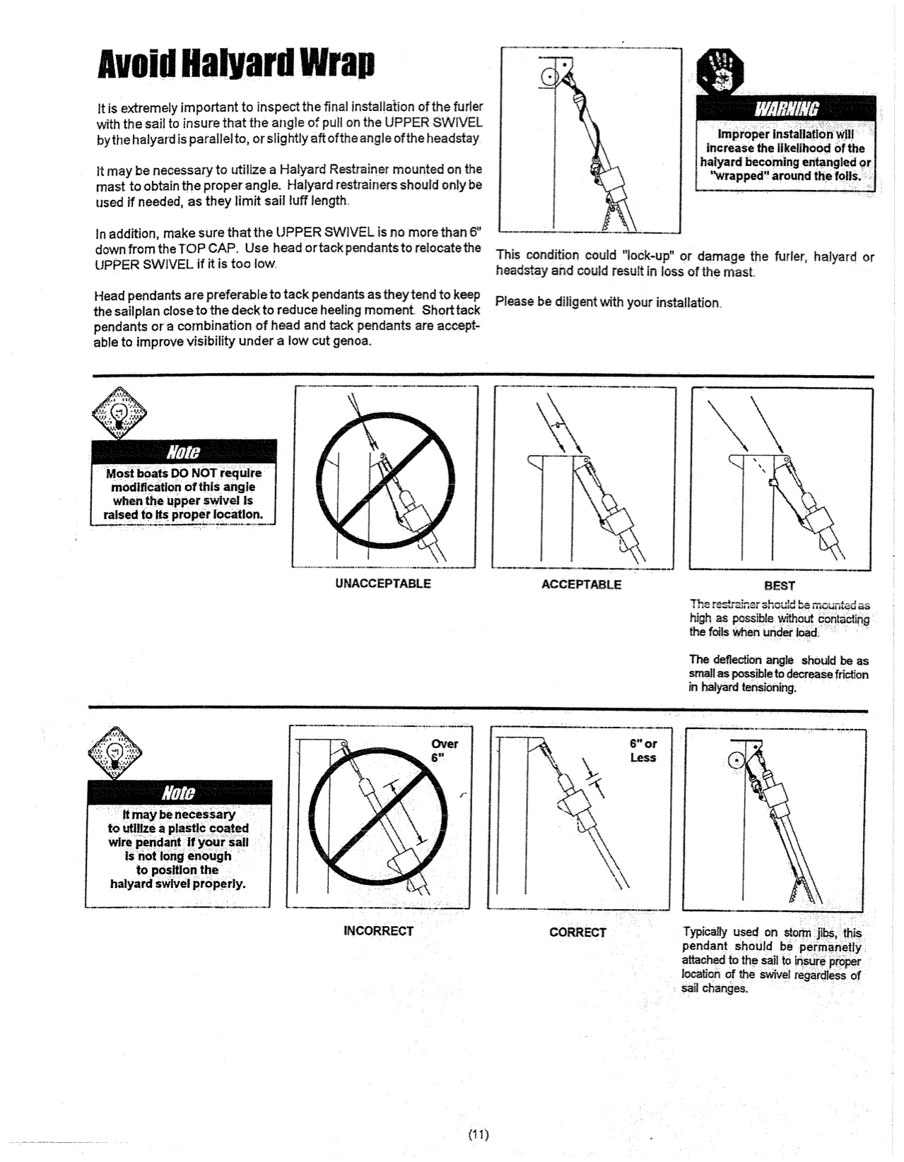

That was a problem on my Hood 810. Had to lengthen the line at the bottom so no halyard was exposed up top. When I got the length right, I replaced the line with SS wire like the manual says to do.
7,746
Halyard wrap is caused by the angle of the halyard to the upper swivel. The halyard needs to be parallel or angled angled back to towards the mast to put tension on the swivel. See the attached page from the Schaefer 2100 installation manual, which also happens to be one of the solutions to problems with a Furlex furler.Halyard Wrap.jpg

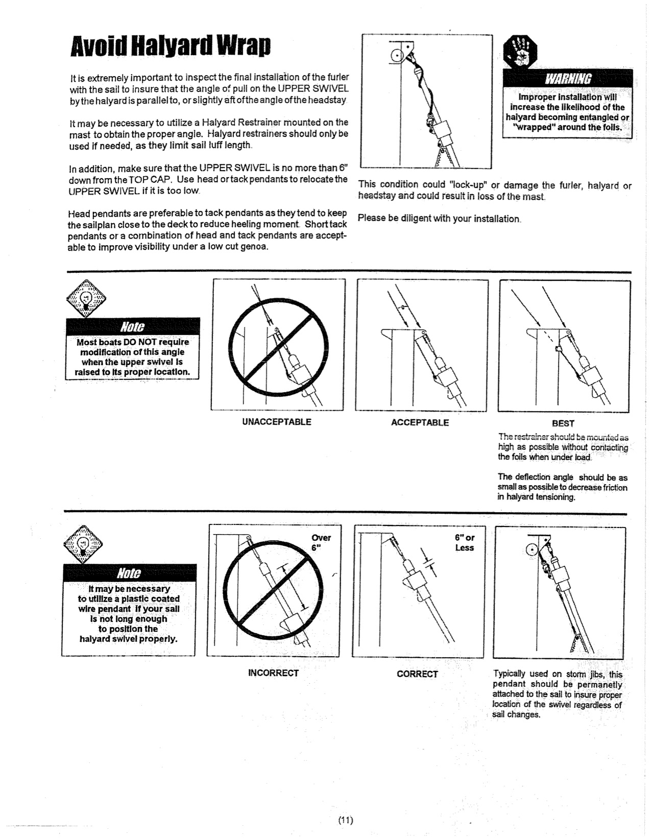

I would suggest you start by looking at the angle between the main halyard and the furler. That’s the usual cause of halyard wrapping around the foil or forestay. The angle between the forestay and mainhalyard should be a minimum of 5 degrees and a max of 10 degrees.
sometimes the problem is that the luff of the sail is too long, and in that case, your sailmaker can fix it for you. Sometimes the problem is that the sail is too short, and in that case you can add a pendant to the head of the sail. Sometimes the problem is that the forestay and then halyard exit on a masthead rig are too close to each other, and in that case you need to install a halyard restrainer on the mast.
If the upper swivel is hoisted up too high, the angle might be closer to 90 degrees than than 5 or 10 degrees. In this case, the swivel and the halyard pulls horizontally, and that will cause the halyard to wrap around the forestay. that’s not always visually obvious from the deck unless you look very carefully.
If the upper swivel isn’t hoisted up high enough, the angle is less than 5 degrees. In this case, the halyard will wrap around the foil,.

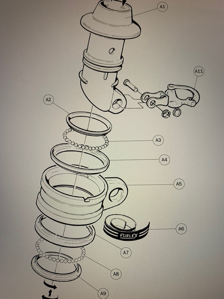

Does anyone have an idea how to get grease in there past the bearing races and to the actual ball bearings? Here's the picture from the manual:
Jun 25, 2004
1,108
See page 42 of the owners manual,for instructions on how to lube the upper swivel.

Judy: that's the part of the manual that just says "Press grease into the grease recess E and F in the Eye ring", which is what I was paraphrasing above. As I was saying, it's hard to see how the grease is going to get past the bearing races (A3, A4, etc. in the picture above) and into the actual ball bearings. What I really need is a grease gun with a very thin fitting on the end, maybe.
