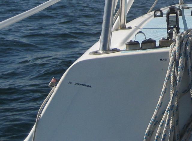

We added a cam cleat (I won't mention brand and size cuz even though I think I sized it right...to each his own), just behind the port sheet winch. A block attached to the be lower portion of the sternrail leg allows the furling line to make about an 80 degree bend from its fore and aft path to the cam cleat. Wow! Not rocket science, but an improvement that has stood the test of time, and is super effecient. I can make my genoa changes from the helmseat under most conditions. Easy to release, tug, and reseat in the cam cleat. Note that the cam cleat does NOT have the extra part/guide that would inhibit pulling the line completely free of the cam cleat.
As with all such mods, careful planning goes a long way. On my old boat I installed a thing or two only to find that the mod interfered with something, allowed me to trip on it, or just wasn't very handy. We haven't found a downside to this mod.
It's easy enough to work out the positioning of the block and the cam cleat, but I would be glad to provide the measurements of my locations if anyone wants.
