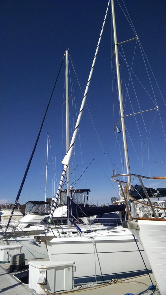

Researching CDI Roller furlers for the hunter 23.5 and 26 boats.. Most people run their furling line down the port (left) side of the boat. Is there a particular reason for this? seems to me it would be better to go down the starboard side since you may be over there running the outboard and the furling line would be on that side and close.... Next DUMB question... saw you can buy new headsails from various sources that are set up for a furler with sacrificial sunbrella already attached etc... they don't seem to specify which side the fabric is on so is it possible to make the CDI furler furl the sail in either direction regardless of which side of the boat the furling line runs on? I know you would have to re-rap the rope in the other direction, but is this possible? hope this question makes sense.... to re ask the question in another way....say I bought a sail and the sunbrella was on the wrong side, could I re-rig the CDI furler to furl in the other direction?
