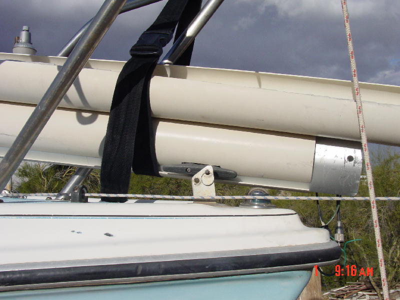

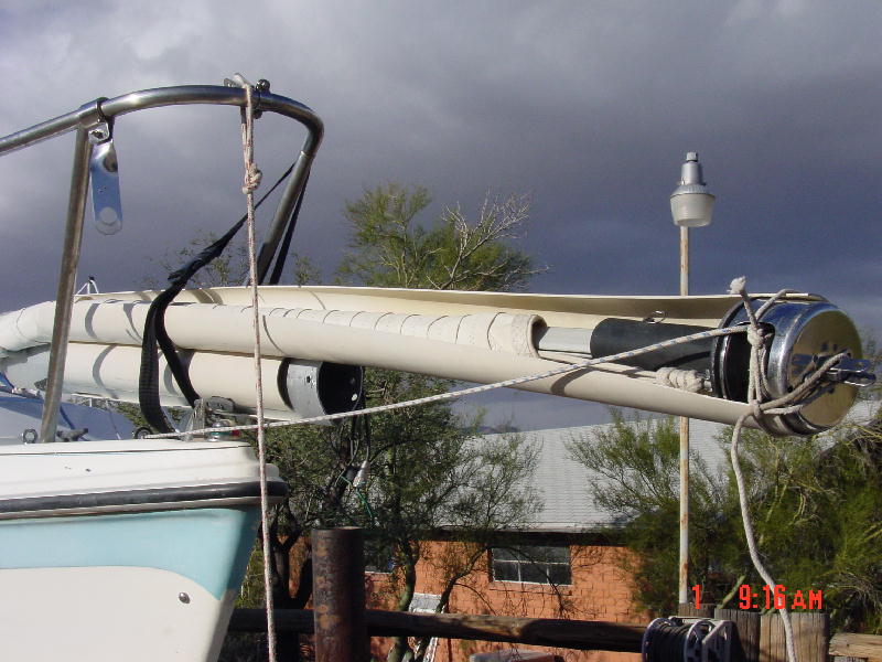

The biggest issue is supporting the furler drum end that sticks out past the end of the mast when trailering.
I've dealt with this problem using some thin-wall PVC and a few coupling nuts.

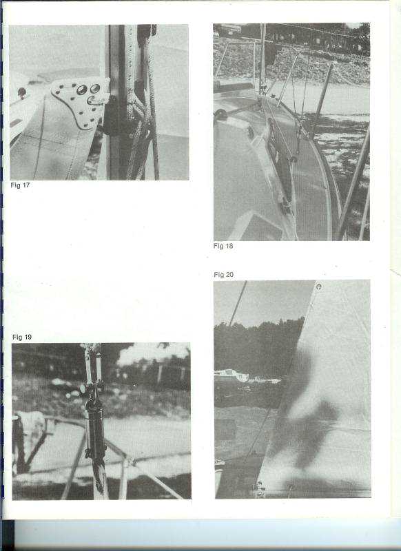

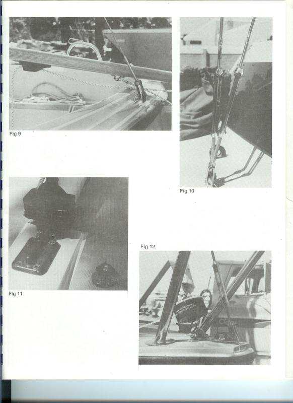

IT DOESN'T replace the headstay, it sets just aft of the headstay (assuming setup as the OEM furler was on the 222.) You should have a attachment loop just aft of the forestay to take the drum and lower swivel of the luff-wire furler, upper swivel connects the halyard to the head of the jib. If you wish to convert to a hank-on jib, it is easy, just have a sailmaker add hanks (or buy them and add yourself). The luff-wire can stay In place with this option. You may need to relocate the jib halyard block a little higher on the mast (closer to the forestay) to get the sail to set right, but it might not be critical. When the 222 was first introduced, O'DAY tried to use the Schaefer System 100 furler, which is about the right size for the jib on a Day Sailer, and WAY too small for the 222 or 192.
If you do wish to keep a furling jib, and there are a lot of good reason to do that, although I'm not sure if it might complicate trailering), I can recommend the CDI Flexible Furler (FF-2) if price is a concern, if price is less of a concern, the newer Schaefer "SnapFurl" is a well-made unit and like the CDI has a one-piece polymer headfoil which will be tolerant of trailering mishaps. Like any good over-the-headstay furler, these will require removing the luff-wire and adding a bolt-rope to the luff. The CDI uses an internal halyard for simplicity, the Schaefer SnapFurl uses your current jib halyard.

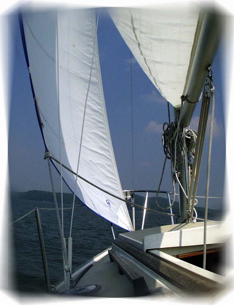

I've included a few pictures, the brochure cover sows the original jib setup, the next pic shows how much it tended to sag to leeward. The 2 pages from a 222 Owner's Manual (from TRINKA), show the setup of that original jib furler, fig 12 shows the lower swivel with drum and Fig 19 show the upper swivel.
