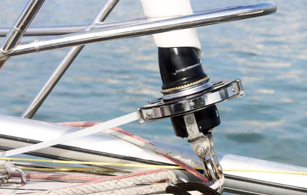

If you want to minimize the gap between the foot and deck, look into the Facnor Flat Deck furlers. They use a single spool of webbing instead of a drum to furl, and it cuts the distance the tack is above the deck in half. They come standard on the Pogos, and work great. Ask your sailmaker to build a scallop in the foot and you'll hardly be able to see the difference.
