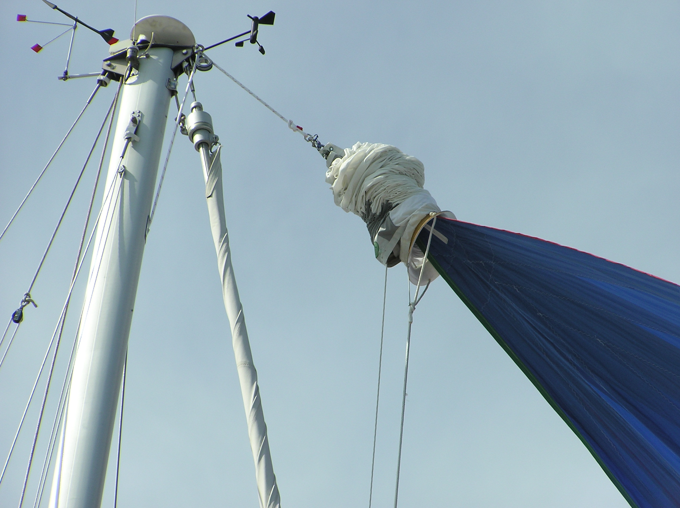

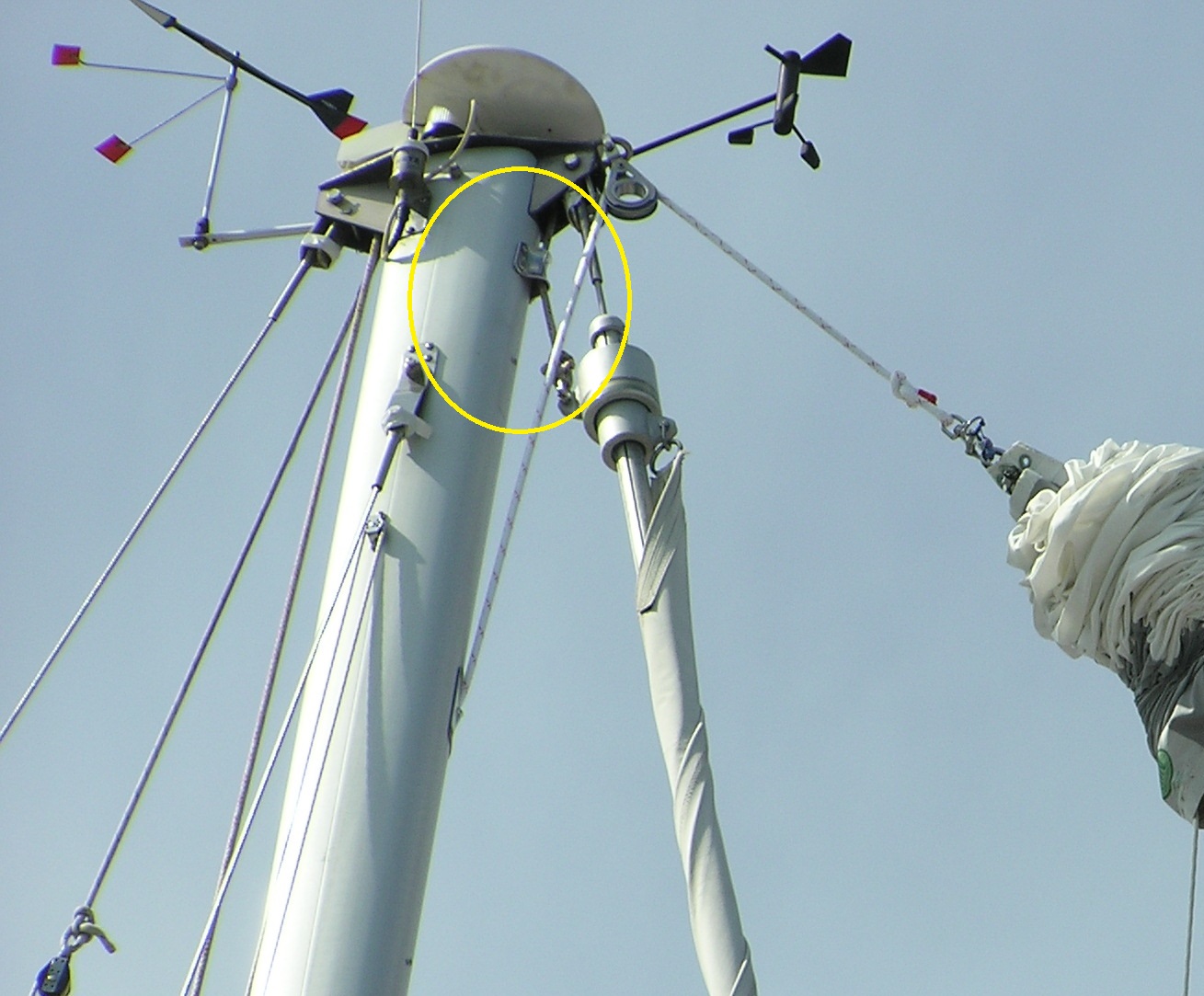

Just make sure you aren't having halyard wrap. That is one of the biggest problems with upper swivel failure. The fix is a halyard retainer. Harken sells them separately. Two come included with every Furlex system. Schaefer has them as an option. It is installed on the mast so that the halyard exits from the masthead and feeds through the restrainer (or retainer) so that it creates the optimum angle for the halyard to feed to the upper swivel. This eliminates halyard wrap which is when the halyard wraps around the forestay and hence binding it all up. My guess is that is really what is happening and so take some binoculars and take a close look before buying a new upper swivel.

Thanks a bunch for photos Paul. Looks like mine so don't think halyard wrap.

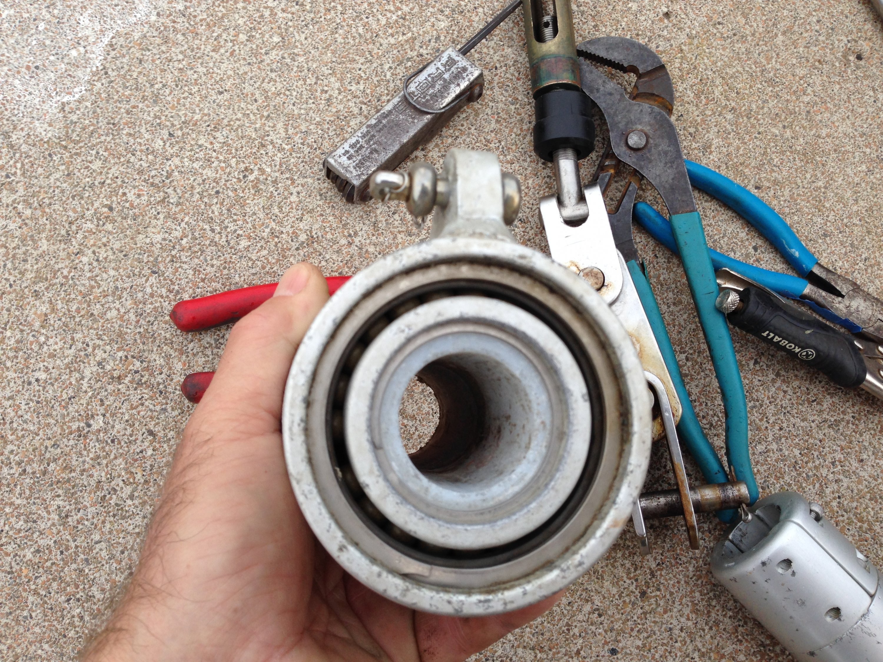

Clyde,
Had to remove my forestay this week and had the upper fuller assembly in hand. The inner bearing is just a teflon sleeve. Not much you can do with it. I would drop the sail and hit it hard with fresh water. I use mclube or dry film lube on the outer roller bearings. Just clean the inner as best you can. The only way to remove the upper swivel is to disassemble the forestay. Hope this helps some.
Jeff

Interesting. Mine has ball bearings.
