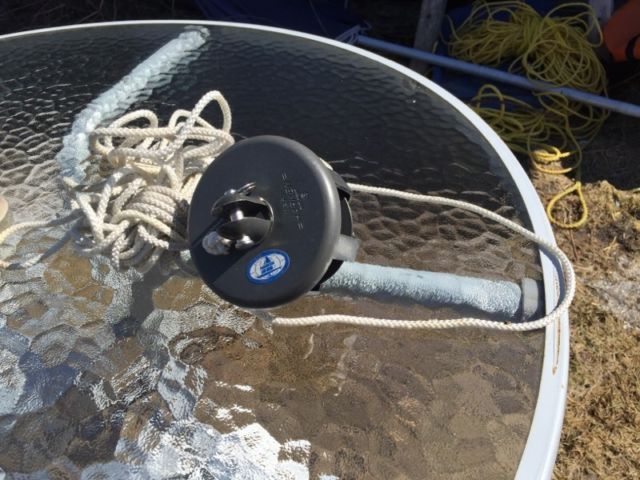

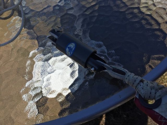

I've found a used harken in top shape, just not sure how to install it, I know I have to remove the forestay but I can't figure out how to attach the top bearing
24,942
Fred to begin to suggest an answer, would need to know which Harken furler your talking about.
24,942
Looks like this may be the unit. Or at least it's cousin. They list the manual in the download section. It uses a wire luff in the sail to wrap around. the unit appears to be hauled up using the jib halyard. The unit in picture 3 is raised using the jib halyard. Have you tried to turn the unit in picture #3. From what I can see it contains the bearings and rotates when the halyard is taught and the jib rolls up on itself.
http://www.harken.com/productdetail.aspx?id=5677&taxid=535
Look under down loads to get the manual.
