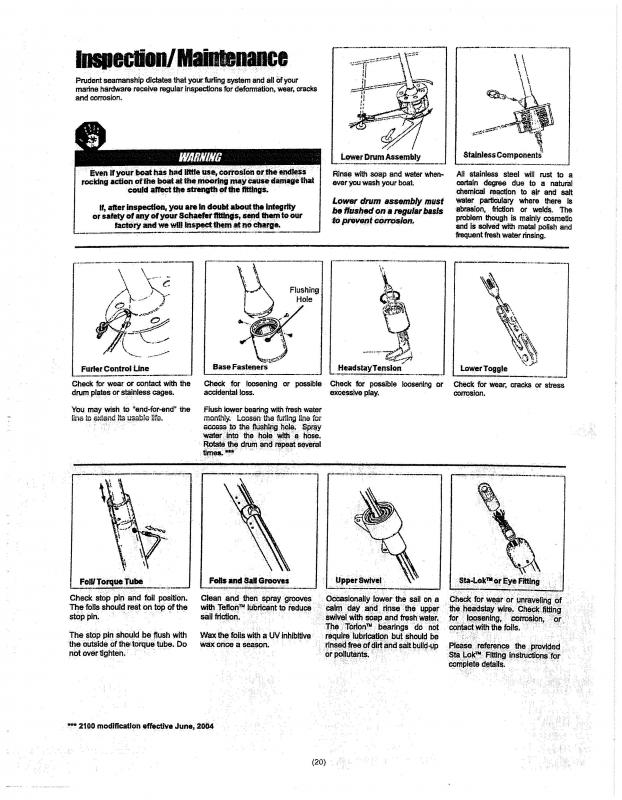

When we purchased our boat in 2010 we had the same problem. I went to the manual and found that you are supposed to flush with water and not necessarily lubricated (see attached page).
So I went to flush the furler drum and there was no flush hole. I contacted Schaefer. The tech guy didn't know exactly when but the first several years of this model didn't have the flush hole. He said you could try to rebuild it but he had seen very few successfully rebuilt. He recommended purchasing the new drum. We did and what a difference it made.
The replacement drum was about $140, IIRC, and they are in Fall River, MA so we just picked it up.
I replaced the drum with the mast up. I disassembled the furler first. Used the jib halyard as a temporary forestay. I undid the actual forestay and then did the replacement. Took an afternoon, 4 hours or so but I wasn't in a big rush.
