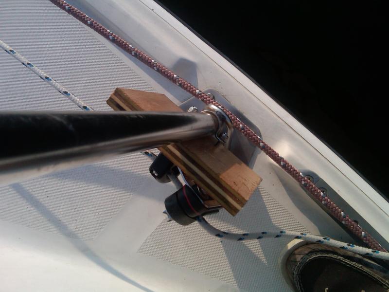

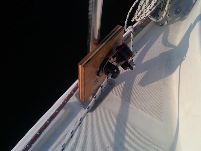

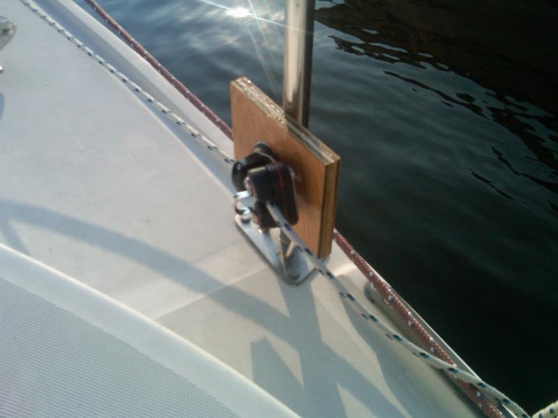

I am unduly proud of an improvement I made to my Oday 23. I have been frustrated with my roller furling line set up since I installed it 10 years ago. The furling line would interfere with the jib sheet, and it was always a pain to tie off the end to the small cleat I had installed on the edge of the starboard coaming. I was on someone else's boat a couple of years ago, and I saw that they used a swivel cam cleat to control the end of their furling line. I thought that was a great idea: you could stand or sit anywhere and snap the line in and out of the cams. No more awkward intereference with the jib sheets or leaning over the coaming. And, I already had a swivel cam cleat sitting in my basement gathering dust! It had been a gift to me to use as an upgrade for the mainsheet control on my Sunfish. Well, I sold the Sunny before getting around to installing the thing, so it was still available.
I thought about how to install the swivel, including a deck and coaming mounting. In the end, I decided the best and easiest thing to do would be to mount in on a board, then attach the board to a stantion. No holes in the deck or boat, and its out of way without being inconvenient.
A piece of scrap shelving gets cut to size and coated with epoxy, the swivel attaced via stainless screws and some 4200, and then mounted to the stantion, reusing the hardware from the stantion block it replaced. I tried it out last night, and I couldn't be happier with the results.

I like your solution. Holding the end of the line away from the jaws as the sail runs out should work OK. With much tension the board may try to turn a bit on the stantion, but if the wood contacts the brace on the base that will stop it.

I guess one big plus for my solution is that it cost me a grand total of $3.71. I had the swivel cam, I used scrap wood, and I had epoxy and 4200 on hand. The bracket was reused from the stanchion block it replaced. The cash outlay was for the stainless fasteners.

That's a cool solution. I only suggest easing the corners of the backing piece to keep it from being a shin/ankle biter.

Now that its up, I see a bunch of things that I would do differently, including your suggestion. I'm going to live with it awhile and see what needs to be changed.
