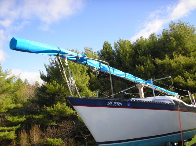

I am a fellow trailer sailor with a CDI furler. I love it; maybe not the CDI part but the furler part. If you haven't trailered with one before, keep in mind that the furler needs to be able to flex without kinking. My CDI has an exrtuded PVC (I think) foil so it takes the rigors of stepping quite well. You'll need to support it in transit too. The photo was my answer to the problem. The mast cover has all the straps sewn in as well as an acrylic cylinder and some support rods to keep everything in line and supported on the road.
