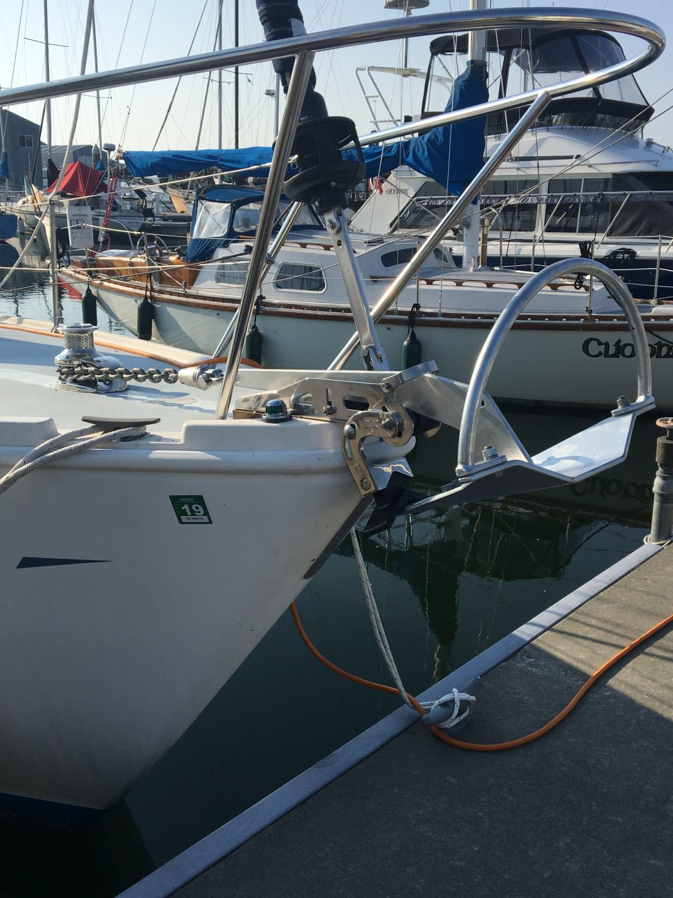

Thanks for that info Rick. I have a 420 too, and have wondered if the Mantus would fit. After reading all the reviews and watching every test video I could find- the Mantus is what I'm going with. Any chance you have a picture of it sitting in the bow mount?
24,951
While not a 420, I installed my Mantus 35 anchor on the Mantus bow roller this year. This is what it looks like on my CAL 35 C.
