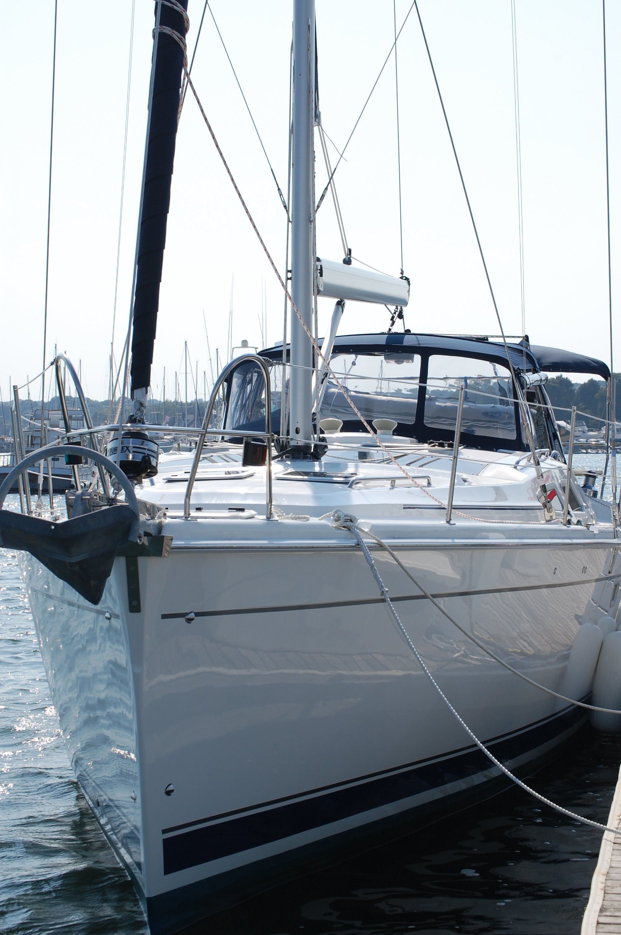

I’ve got a Rocna 40kg (88#) on my bow with the OEM windless Which is a lewmar V2-3
