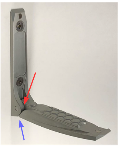

RE: are probably the best I've ever seen...

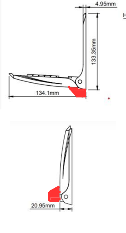

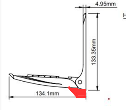

Take a good look at the pivot point. No support below, (blue arrow)
gary
Gary, If you look at the drawings below this image on that web site, that support is integral to the lower section of the tang in the foot step. Your red arrow is almost pointing to it.
dj
p.s. actually, my biggest concern is the pin used that holds the two parts together.

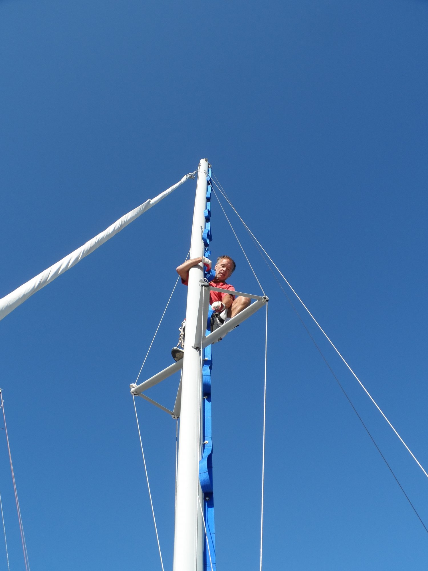

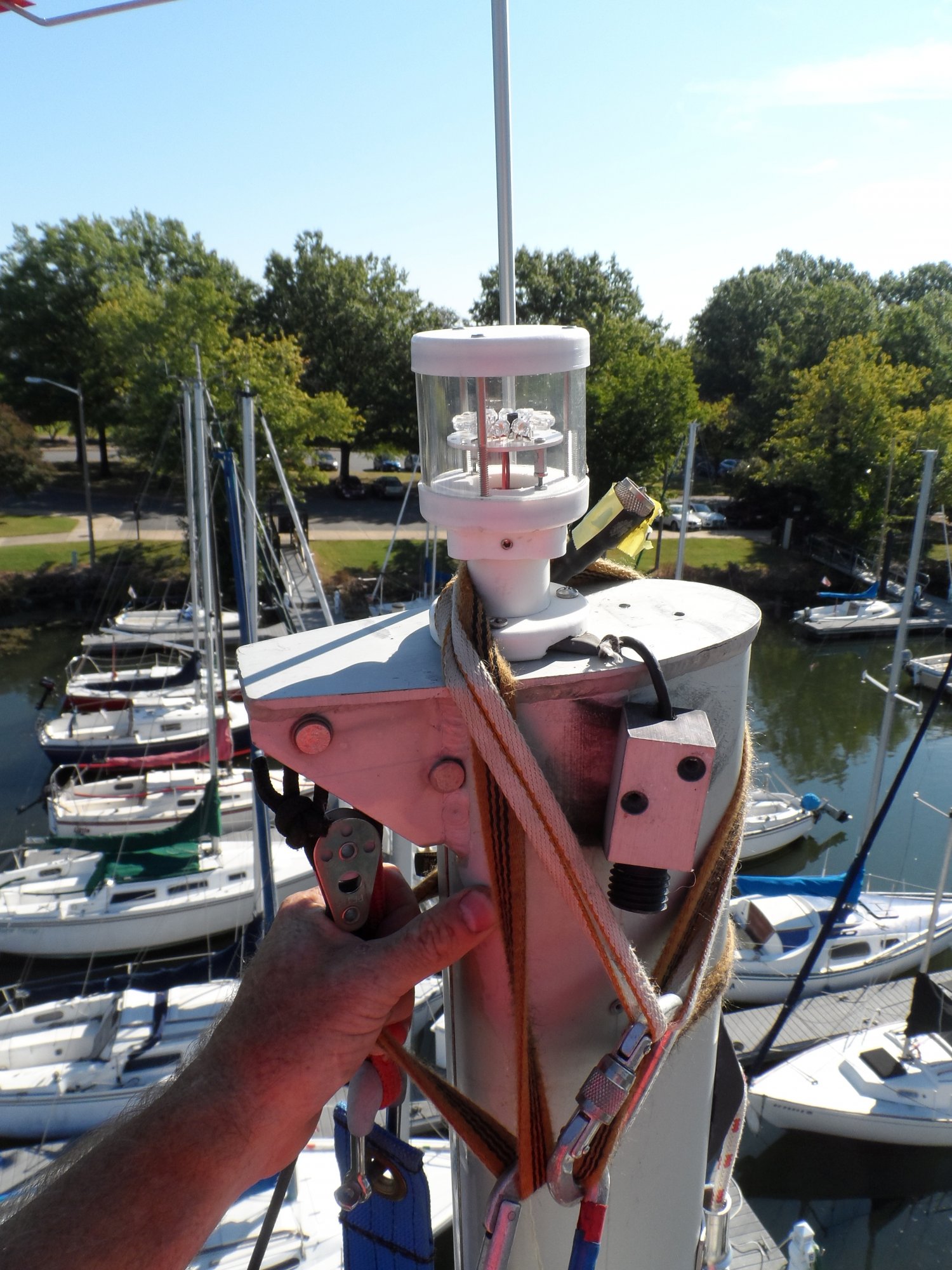

The solution to halyard stretch is to pretension the halyard with the winch to more than you body weight plus live load. Then there can be zero stretch. Even with polyester halyards, I've done this many times. You should get right to the top. Really. The material of the halyard should play no part if it is pretensioned correctly.
You hands go on the mast, not the ladder. That also helps. Wear shoes that slide into the steps easily (no tread). Roll the ladder the correct way for storage and the rungs will fall open.
(The ladder is at the top of the mast. Keep your weight in and arms around the mast. Most of the steps are nicely open, as you can see, but one got squeezed by the spreader.)
It's all in the tricks.
(Note that the ladder is only about 4 inches down. I could have done better, but this is enough. Polyester halyard.)

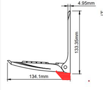

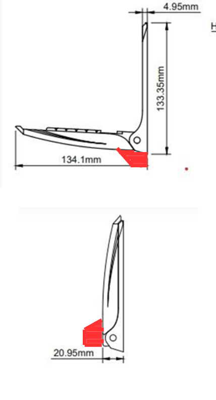

I have to disagree DJ.
The heel should look like this.
There also should be something to at least to resist the foot slipping sideways.
I know that there are reasons for foldaway mast steps but for safety, nothing beats the stirrup type.
Your foot cannot slip out sideways.

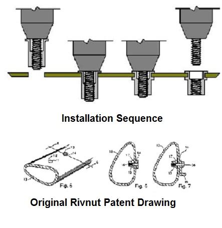

Rivnuts are another option. The strength of rivets and the removability of screws.
Likes: BAD ORCA

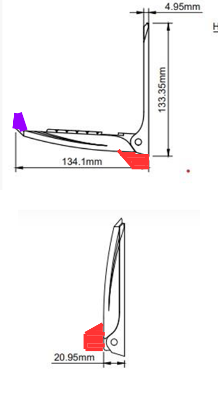

Foldaway and stirrup are two different things. Other than both being mast steps, not a lot more you can do to compare them. As in everything boating, there are compromises.
Although I would like to hear more on why you feel you need that added red section? Maybe I'm missing something. To me, that region is all about the strength to keep the step in it's unfolded position. Is there something more that you feel it needs to do?
The purple addition you have drawn - yeah maybe, but you are heading more to the stirrup type step which I feel is another system. You can't have both.
As foldaway steps, these present the least windage, cordage fouling, side profile I've seen. The construction appears to be very well done. If I were going to a foldaway step, I've never seen a better looking and well made one on the market. Hence my comment these are the best I've seen.

These are good looking steps but I see a few misconceptions/problems.
1. The attachments (screws) are not just in shear. In fact, the top screw is clearly in tension as the pivot point acts as a fulcrum and tends to "pull out" the top screw. Even the bottom screw is probably in some tension depending on the geometry and when where the foot is on the step but it looks like it would be in some tension. Do an experiment. Screw the step into some wood (not very deep or big to you don't have to strain too hard) and then pull down on the step. I'll bet dollars to donuts that the top screw will pull out easily followed by the bottom screw. I'm not saying it is a bad design, but the top screw is clearly in tension.
2. I have folding steps (three). I frequently go up on these to secure the sail when it is down. I find that sometimes if my foot "catches" on one of the steps as I step up and it folds up. When it does that I can get down okay, but if it were to happen up high on the mast I'd be hard pressed to get to the next step down without some gymnastics. Of course, I assume you'd be going up higher on the mast with some sort of secondary way to lower you. If not, you might be up the creek without a paddle.
