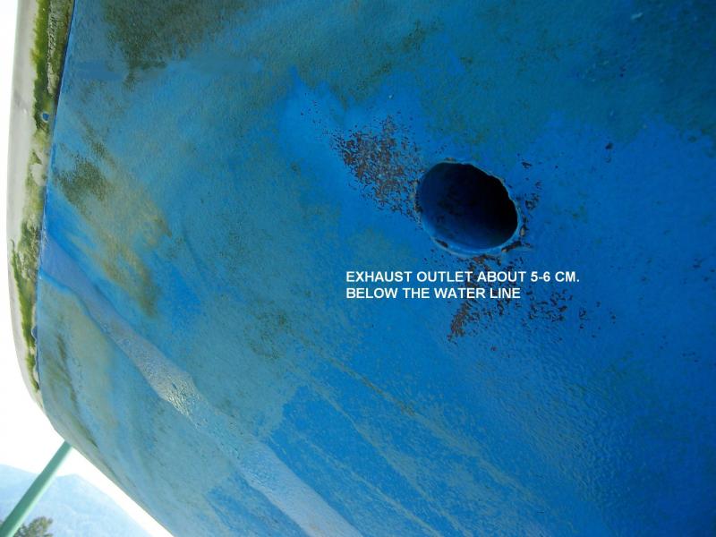

The Last Thing I Would Worry About ................
Anybody has any experience/info about that kind of problem?
................. is the closeness of the exhaust outlet to the water line, as long as you have a big,high internal loop as previously mentioned here.
In fact, our 1999 Hunter 310 was designed with the exhaust outlet about 5-6 cm. BELOW the water line. Makes for very quiet running in the cockpit. The attached photo is a shot looking up at the exhaust outlet on the underside of the hull. Water would have to rise more than one meter in the exhaust hose to go over the top of the internal loop. If that were to happen, flooding the engine would be the least of my worries :eek:.
