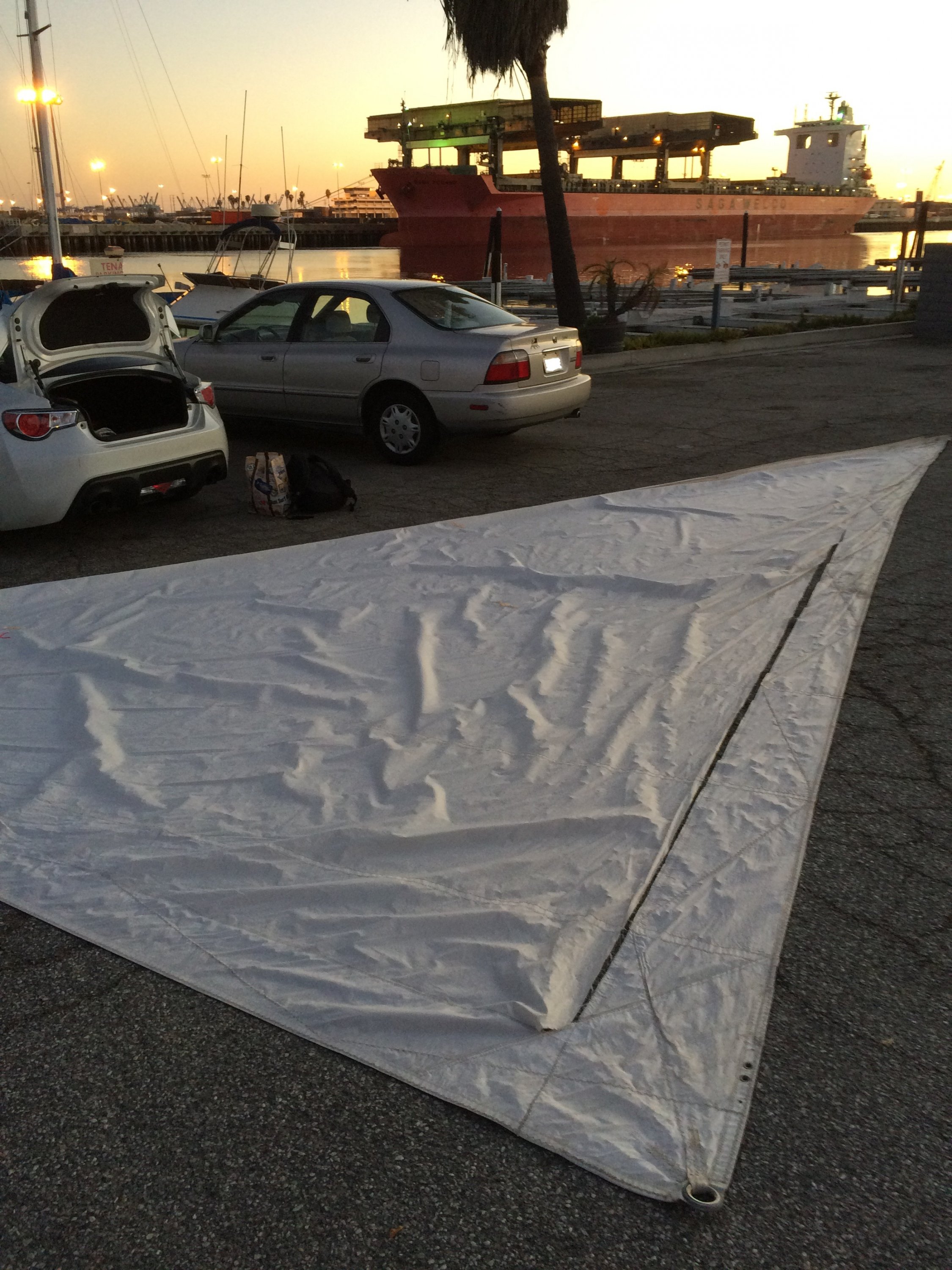

Yesterday we were out for a day sail south of the Port of Los Angeles. We sailed out of the Angel's Gate and were about five miles offshore when we decided to turn around to head back in.
I took the opportunity to heave-to so we could take a brief break before the journey back. We have a large (IMO) genoa - probably a 150 - on a roller furler. Tacking with the genoa fully unfurled can be challenging, since our Montego 25 has three shrouds on either side of the mast - a fore and aft lower, and the cap shroud. The lower shrouds attach to the mast with a bolt which protrudes beneath the spreaders (we have one set of spreaders on our small 25' boat). A pretty typical setup in my limited experience around sailboats, observing such things. As you tack, the significant portion of the genoa athwartships of the shrouds of course tends to get hung up against the shrouds as the bow goes through the wind during the tack. Generally - sometimes with a little gentle encouragement on the soon-to-be working sheet - it will eventaully come lose and finish its transition to the other side of the boat.
Anyway, I had earlier furled the genoa a bit - perhaps four or five feet of the foot were reduced - since it was a little breezy yesterday and the boat was becoming a handful (the furling settled it down nicely). We had just hove to and I had just started to go down into the cabin when I heard that awful "Rrrrriiiiiiiiiip!" sound. Uh oh, that obviously can't be good.
As the title of this thread says, it turned out that the damn genoa had caught the edge of the bolt that protrudes where the lower shrouds attach just beneath the spreaders for the cap shrouds.
It was not the first time I've hove to, and certainly it was the first time that the genoa had ever caught that bolt, as far as I know.
My questions to the forum are: is this unusual? Is it unheard of? (Surely not.) Any recommendations on how to proceed? A marina neighbor suggested "grinding down" the bolt, but I don't want to make it so that it can't be removed when that time comes. I was thinking of trying to cap and tape it but I also don't want to create a situation where it would trap moisture up there and contribute to corrosion.
Is it always such a bear to tack with a 150 genoa, in terms of the sail making it across to the other side during a tack?
As for the sail, well I will be getting new sails shortly. We bought the boat about a year and a half ago and I judge the sails to be either original equipment, or close to it. The main is original, I think, and shows signs of having been re-stitched at some point. We discovered a new tear in the foot of the main, near the clew patch, *also* while we were out yesterday. We had a bit of a problem with the outboard as well, while in the main channel on the way back in - quite an exciting day for us!
I'm not overly broken up about having to purchase the new sails. I'd been looking forward to it for a while now but I wanted to get "every last drop" out of the sails before I sprung for new ones, and I had budgeted for it way back when we bought the boat. For the local folks, I will be going with either Quantum Sails in Long Beach or the Doyle loft in Costa Mesa (next to Minny's) because I want to work with a local loft who will visit my boat in person. Any recommendations on that front would be welcome (feel free to PM me if you'd rather not post that publicly).
I'll attach a picture of the genoa - the long dark line on the right is the tear. The UV strip is face-down on the ground, but the tear is along the line where the UV strip ends. I will try to locate a picture of the spreaders and the lower shroud attachment points.

I agree with your neighbor- if the bolt sticks out far enough to snag the sail, it's too long. Either grind it down or replace with shorter one

The tear is on the stitch line of your sacrificial UV fabric - a pretty common rip location for an older sail. Every time you have the strip restitched, you put more perforations in the sail. A rigger can give you protection options for that spreader bolt. When you roll up your Genoa for a hove to bring it to less than 100% J measurement, you likely don't need much and that practice will avoid having the head sail straining across your spreader. Finally talk with your local sail loft about your desire to reduce the size of your headsail. There are some great options being offered. The local guys will know what is working for others. It may require some changes to you deck hardware.
