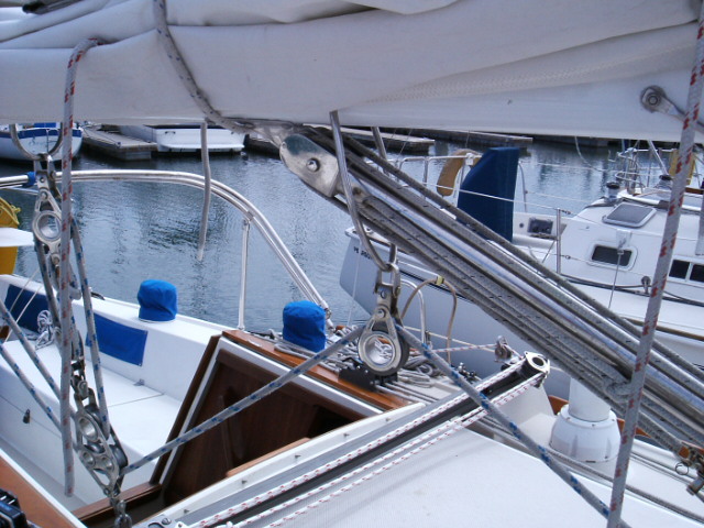

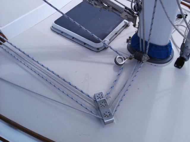

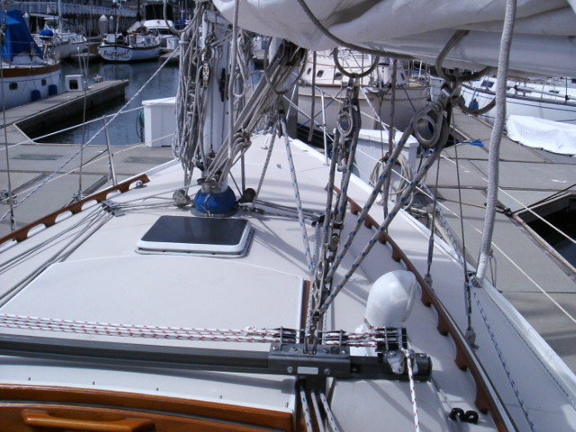

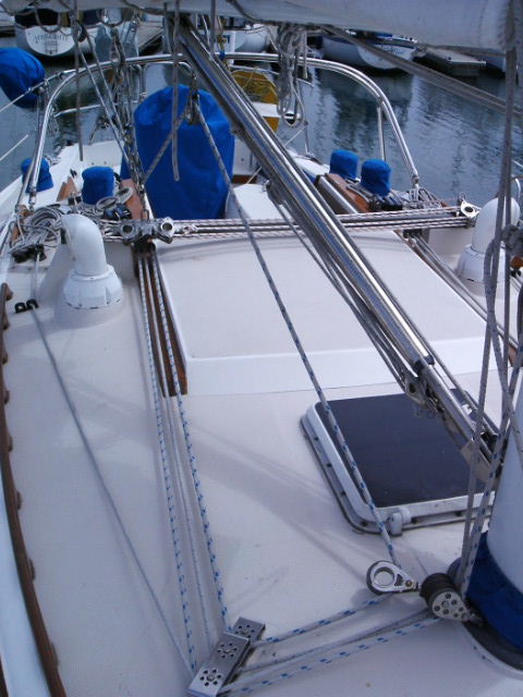

You could do that, or
do what we've done. There is really no reason to have to line up the mainsheet with the base of the vang at the mast, it works just fine offset a bit. It does not "interfere with the vang during tacks." Don't go to the deck organizer, just go back aft from the block at the base of the mast, which is NOT what we did, but will save some friction on the mainsheet. If I did that it would interfere with the saloon hatch.

Stu, thank you for the info and pix. Your setup is similar to mine and with Rich's input I'll take another look at it this weekend.
