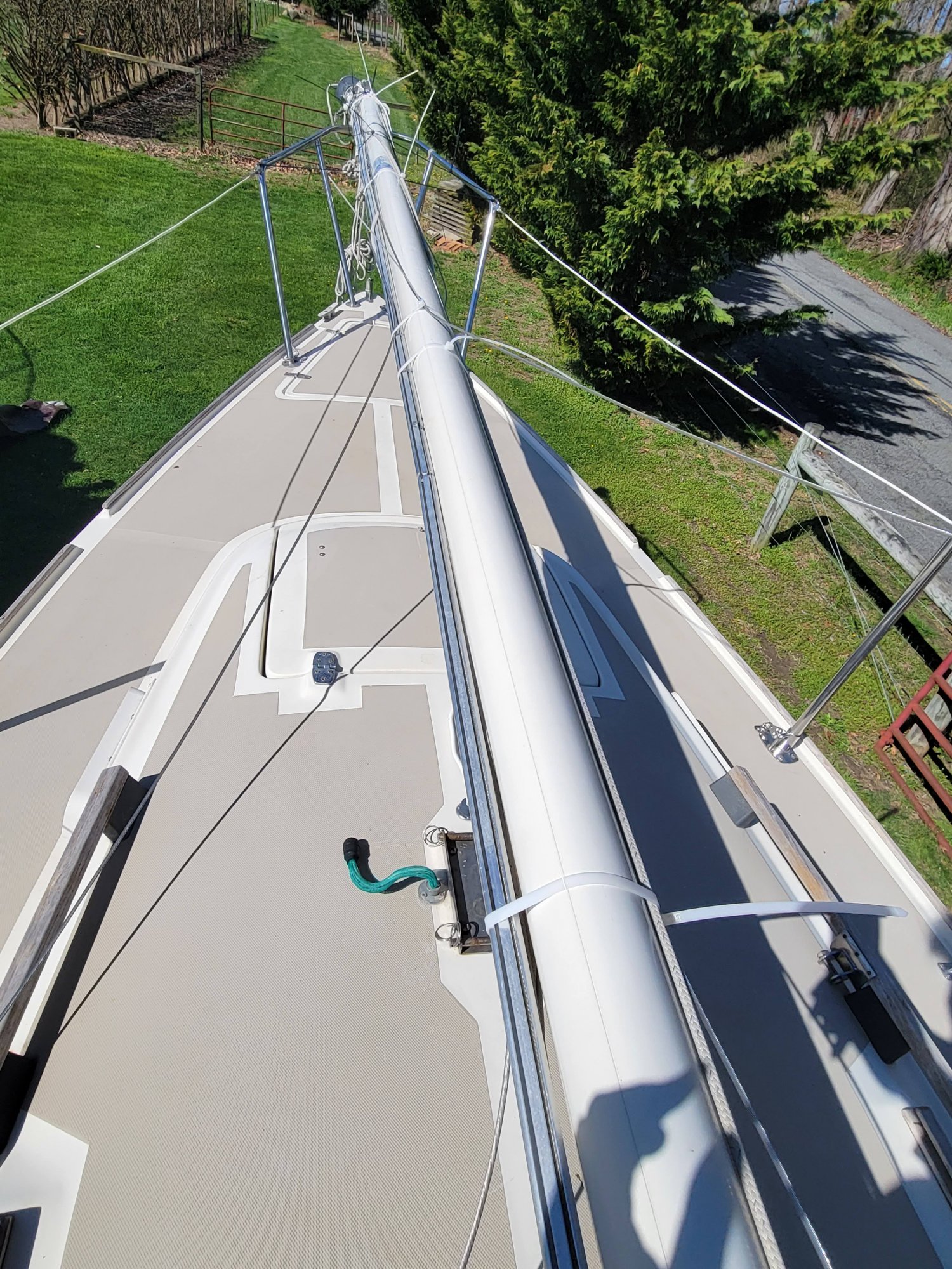

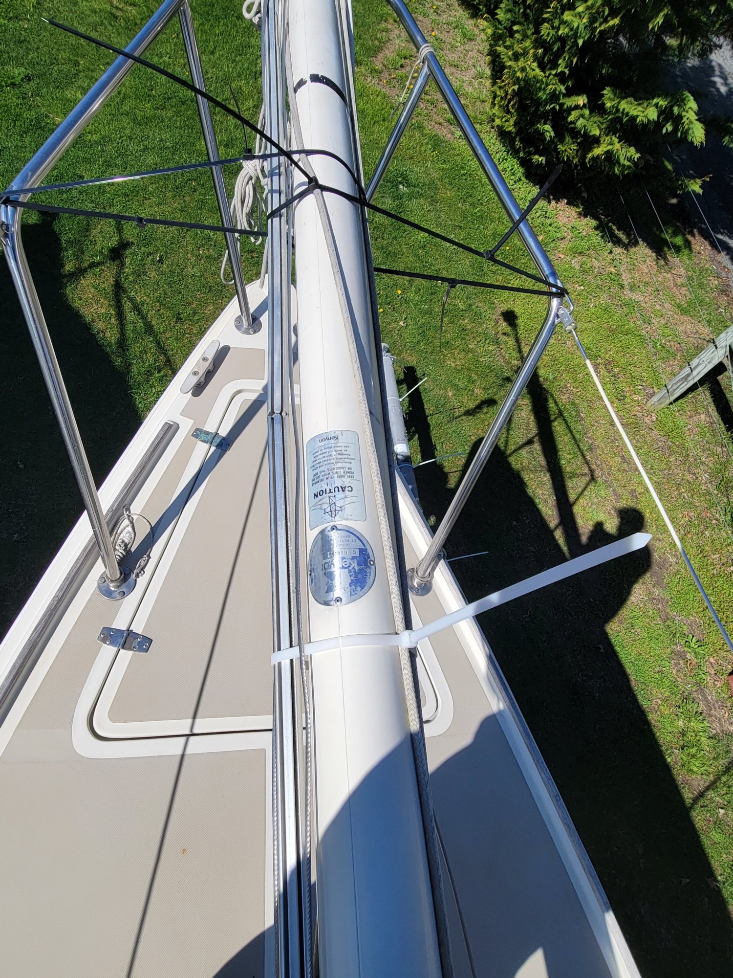

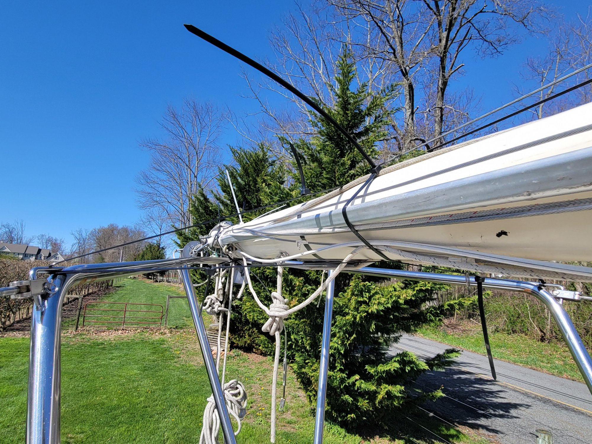

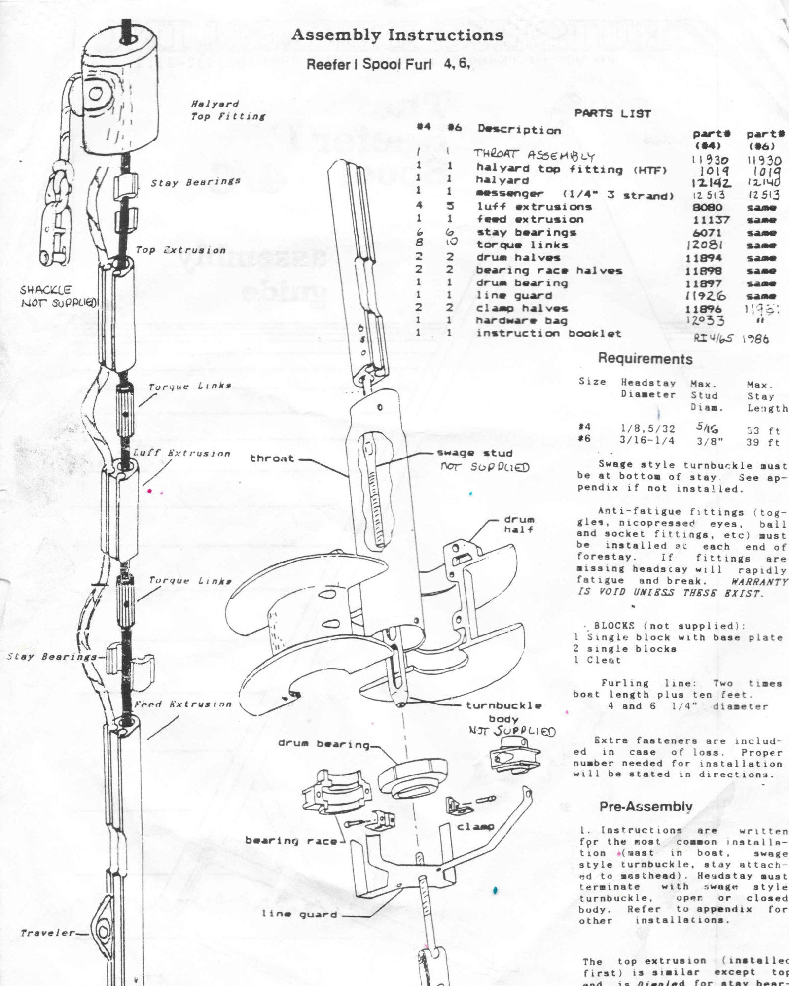

Thank you so much for your detailed response! I have been concerned about raising and lowering the mast over the bow for those same reasons, so it's great to have some firsthand experience to go by. Is it my understanding that you do not attach the end of the gin pole to the top of the mast at all? I've seen many pictures/videos/threads where people attach the forestay/furler to the end of the gin pole to provide the necessary leverage. If that's the case, I'd imagine your gin pole is very rigid and the clamp is really robust to provide that leverage. The furler/reefer I have is the rigid one with the foils, not the Flexible Furler (FF) which I think you are referencing, or maybe I'm mistaken. So, if mine flops to one side of the mast as it is raised/lowered that could bend the foils, which is my concern. If I attach my rigid furler/forestay to the end of the gin pole, I've read that the slack in the forestay could also bend the foils on the furler. See the attach document and images of my reefer. Thank you for your help.

I've been thinking about your furler all weekend . If you had jib halyard ,you could use instead of the forestay/furler ,the gin pole would still work . If you were still concerned about the aluminum being bent .Here is an idea . find the smallest diameter schedule 40 pvc pipe that will fit over the aluminum and slide it over . It comes in 10' lengths . So cut it in workable lengths and slide a few couplers every 6 feet or so .
You might want to glue a coupler on to one end of each section . I bet you wouldn't even be into it for $30.00 .What is bolted or claamped to the starboard teak handhold ?
