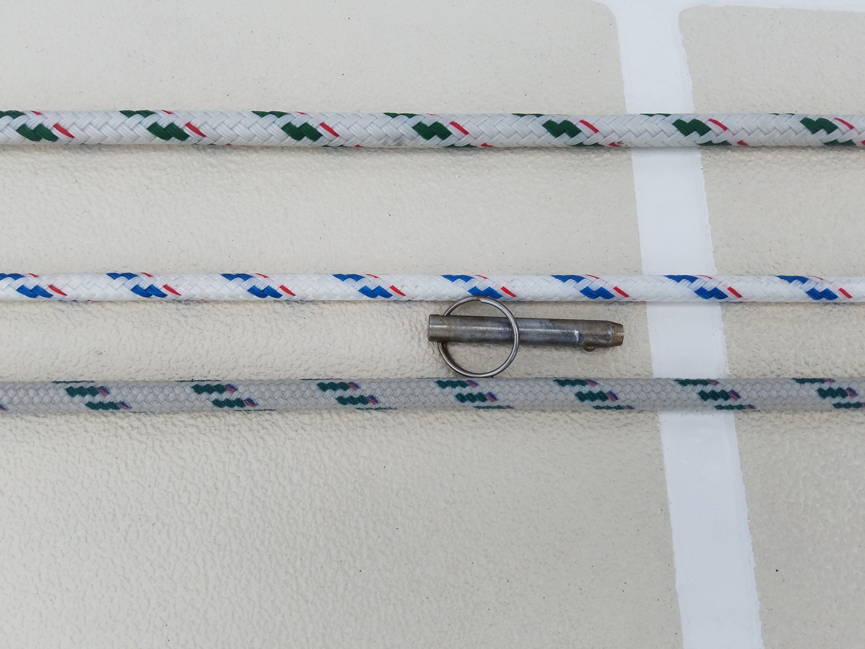

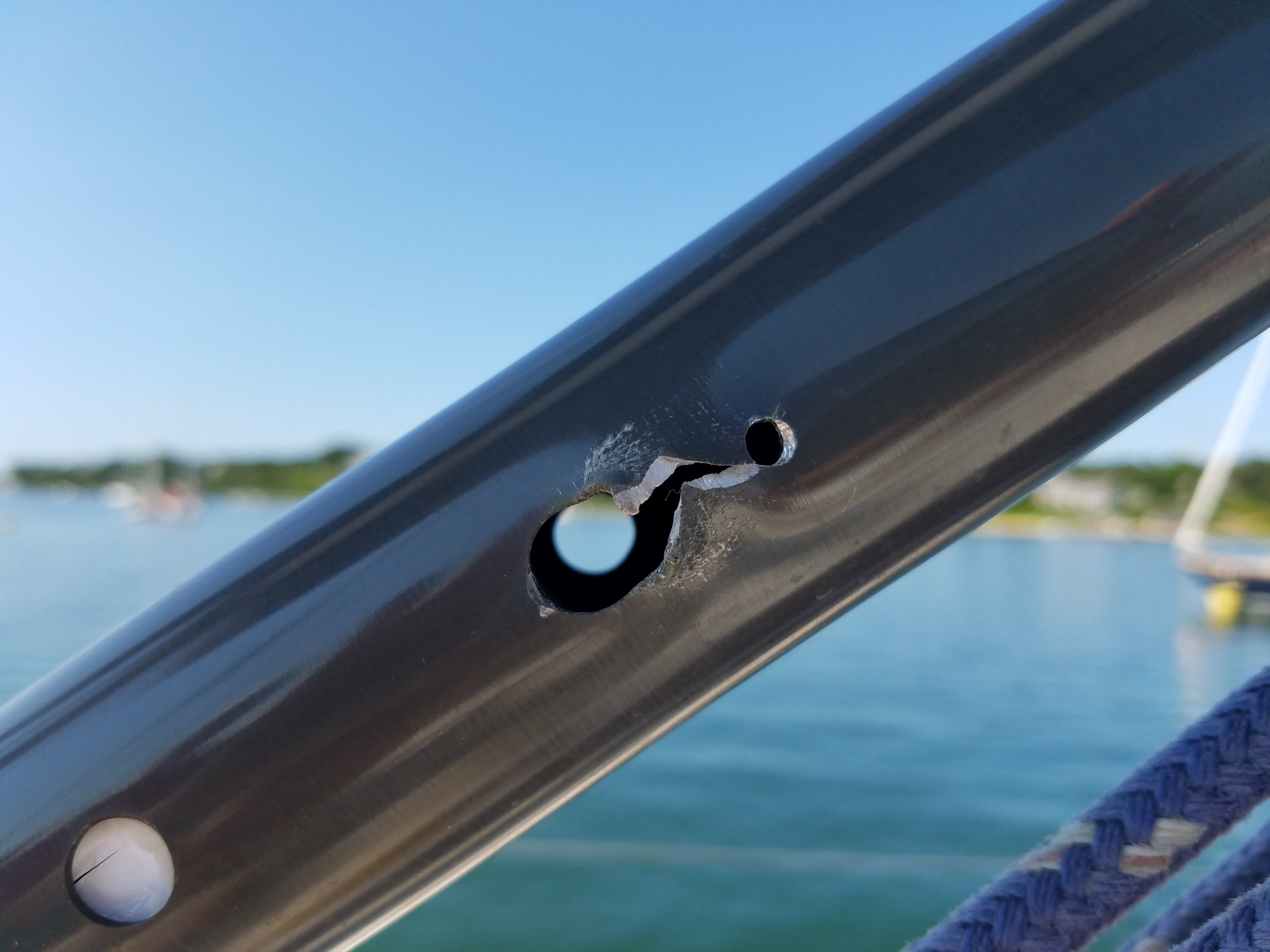

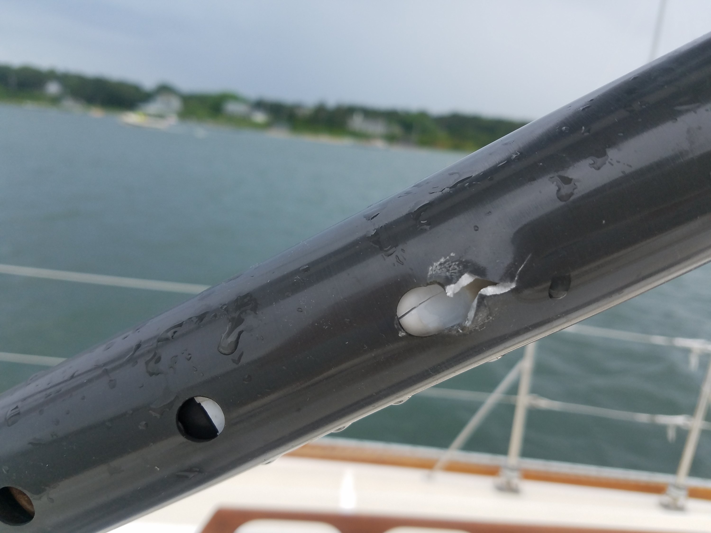

Found the vang had thrown the pin that retains the spring, and in so doing damaged the port side hole. See the pics, please. I found the pin on the coach roof!
Does anyone recognize this vang? I think it's a Forespar, but am not certain.
I'm planning on re-installing the pin at the nearest useable hole location. I'm hoping I don't fire the parts across the harbor in the process.

I can’t be certain, but from your photo it looks like the white internal portion of the vang by the damaged hole is cracked. The whole thing might be toast. I don’t know if I would trust a repair which might cost more than a new vang.

Thanks Doug. That's a keen observation. I think you are right. I am going to try to take it apart (without killing myself) shortly, and try to at least get it working well enough to get home this week.

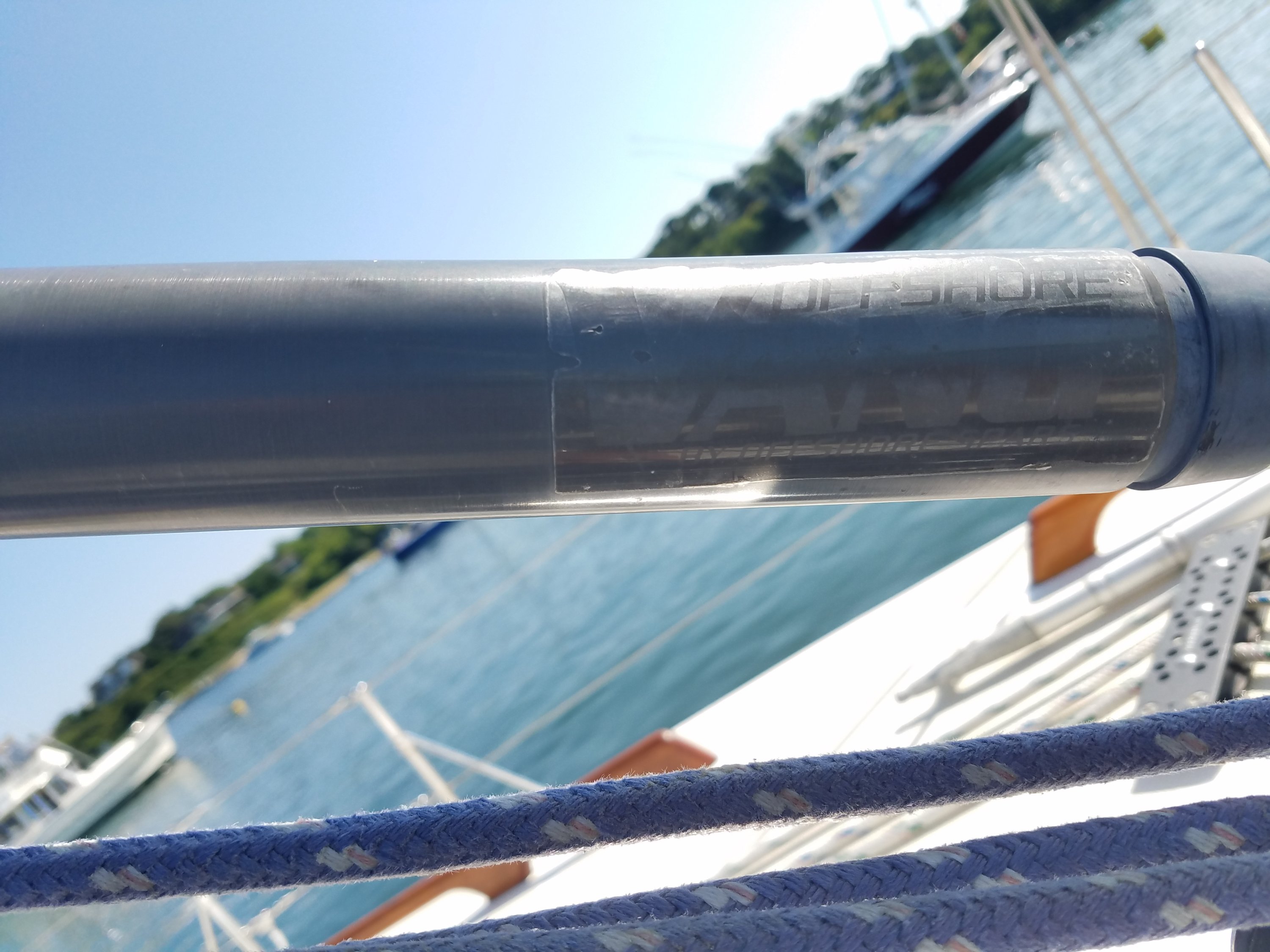

I determined from the faded label in the morning light that it's an Offshore Vang from Offshore Spars. Makes sense, they made the mast and boom for this boat, too (as far as I can tell).

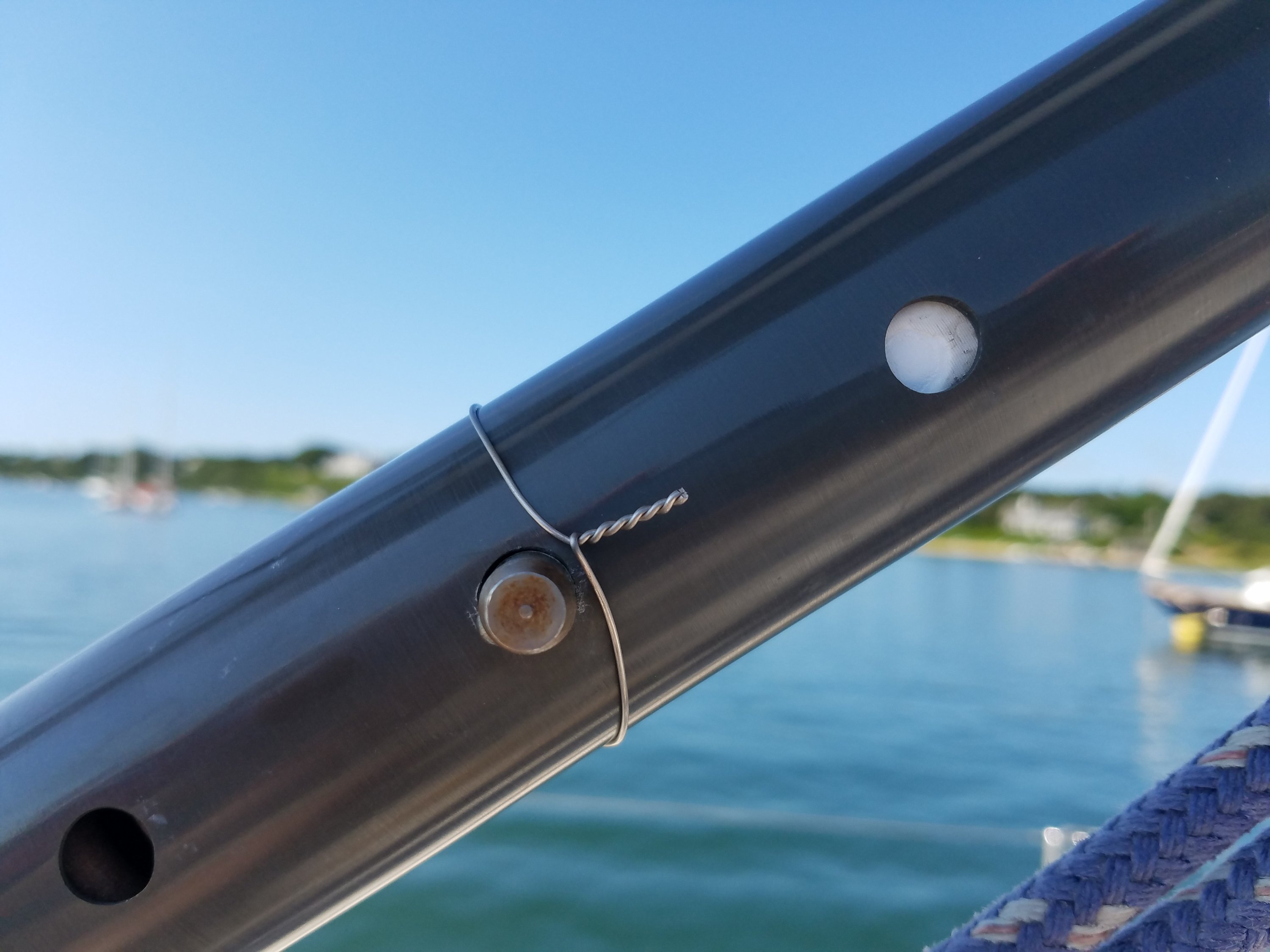

I raised the boom with the main halyard to about 15º up, and the middle hole and the hole in the white nylon/Delrin follower nearly lined up. With a minor adjustment I was able to insert the pin. I released the halyard and the boom sat at about 5 to 10º up with no vang tackle tension. All good, I think.
I then stop-drilled the crack in the tube, peened-down the sharp edges, and safety-wired the pin.

I declared victory prematurely. Even though I got the height right, the thing is now jammed. More investigation....
