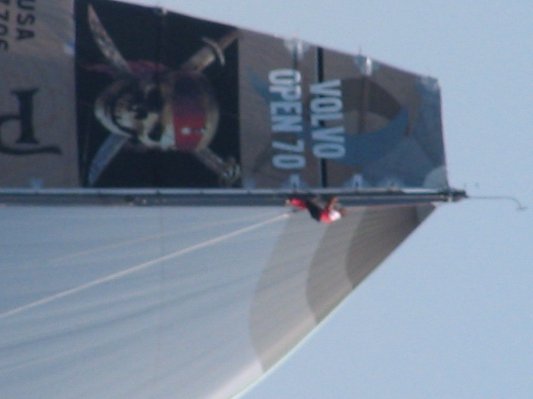

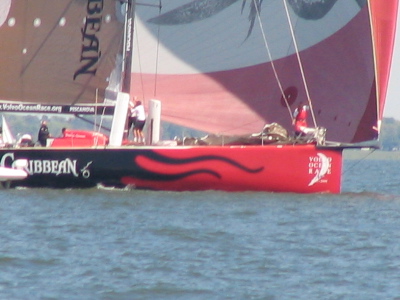

Ross - If the CG officially declares an exclusion zone for racing purposes and a dopey idiot erroneously or mistakenly enters the zone, who is arrogant?
Happened to me twice .... Once during the Chespeake Challenge for unlimited powerboats where I had a 'surprising' grand view of 100 mph plus boats passing me simultaneously on both sides. and once during the 'round the buoys' race in the Ches. for the Volvo Around the World Race .... I unknowingly 'drifted' into the exclusion zone (and got some 'nifty pics')
