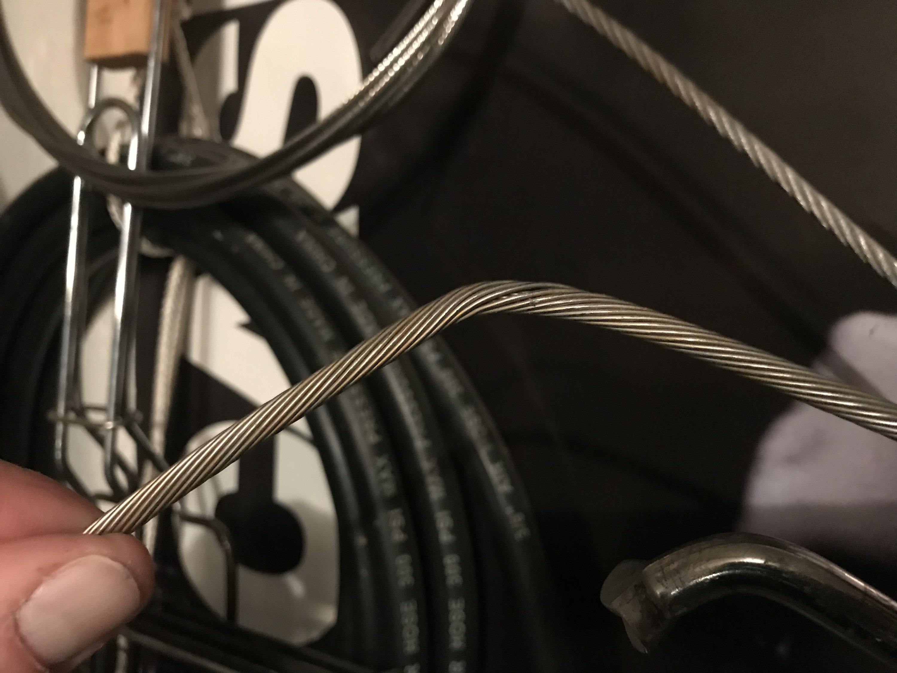

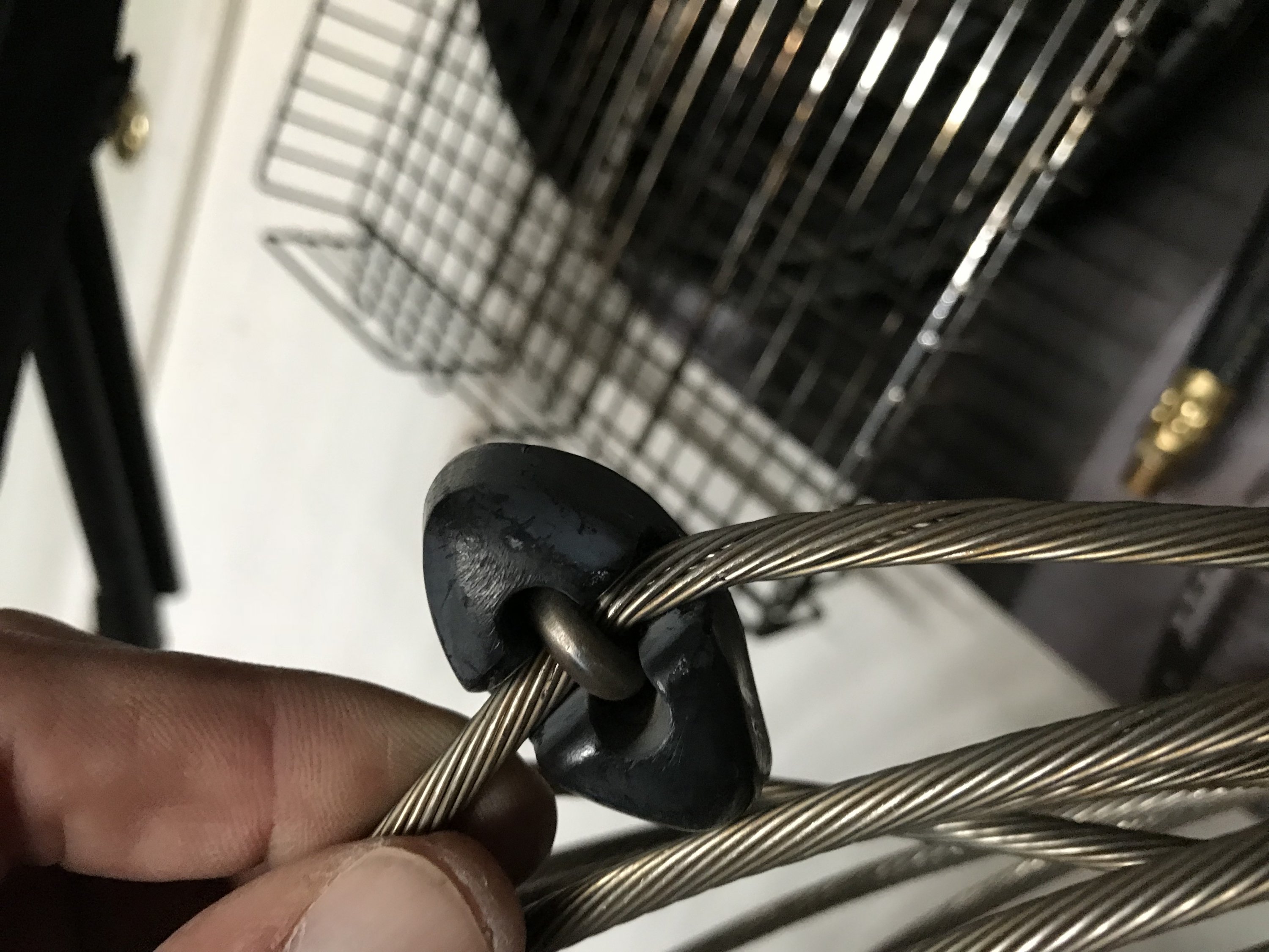

does anyone think this should be replaced it’s the upper shroud right where it goes through spreaders. H26

Not clamped tight at all....the purpose being containment, not immobility.Also should the shroud be clamped tight at the spreader or just tight enough so it slides a little.
The spreader tip should bisect the angle of the shroud's deflection from vertical to mast attachment. Or, the angle between the wire and spreader should be the same above and below the tip.. That's why they need to move a bit. You should be able to simulate that geometry while the mast is down if you know the horizontal distance from mast to the chainplatesSo when replacing an upper stay, which is not under tension while sitting horizontally on saw horses, how does one determine exactly where to place the spreader end cap?
