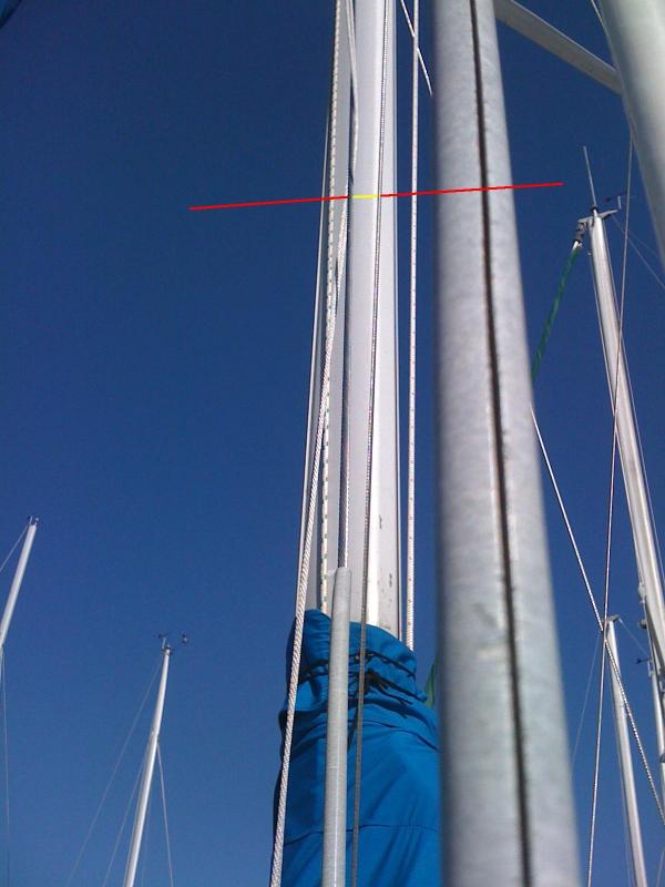

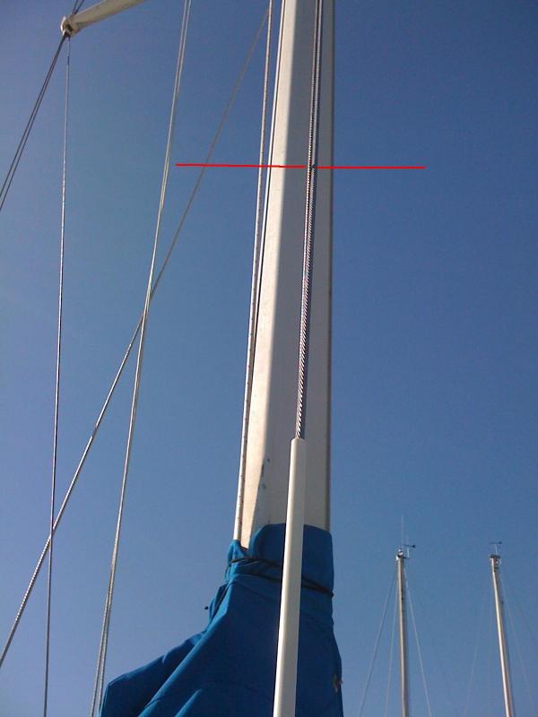

I recently purchased a Hunter 31, early 80s model and was in the process of tuning the rigging when I noticed that the starboard lower shroud and the starboard lower diamond stay are in contact with each other, whereas there is a 1 1/2" gap between these on the port side. Has anyone ever encountered this and if so what is the cause and what is the solution? The lower spreader on the starboard side appears to be out of alignment with the upper spreader but there is no discernable twist in the mast and no visible difference at the spreader base.

The shrouds seem to be the same length. The mast is straight but does look twisted. The spreaders look ok and the shrouds cross the spreader tips in the same place.
