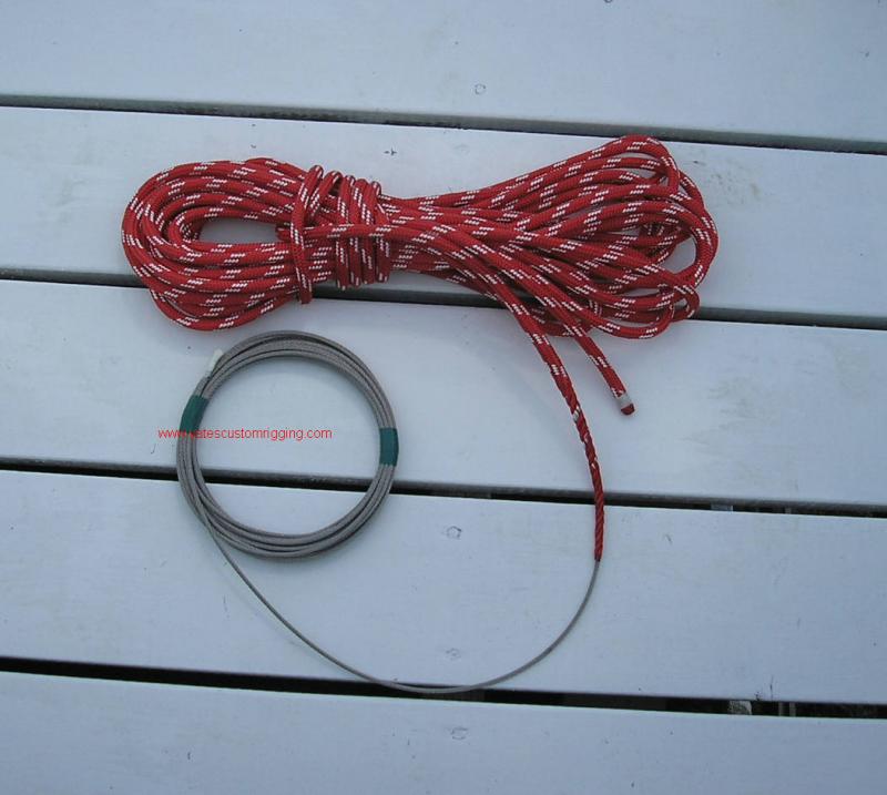

Wire reel winches used to be common but are only seen on older boats now. They can be very dangerous if the brake slips.
A better solution is a modern winch and either all rope halyards or wire/rope halyards. With wire/rope the best way is a wire/rope splice like the one shown below from Yates
