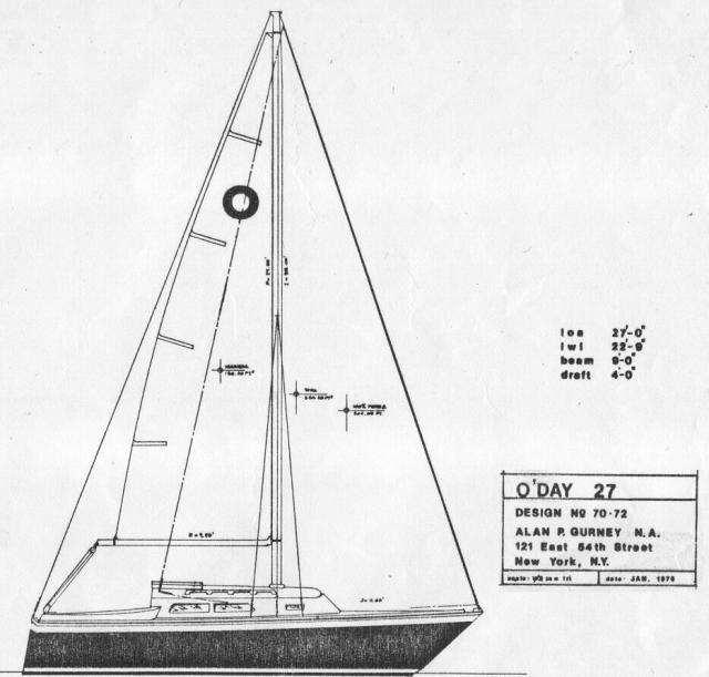

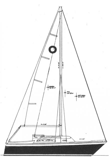

O’DAY 27 Specifications:
Designed by: Alan P. Gurney, 1972 Produced: 1972-78 (Model years 1973-78)
LOA: 27’ 0” LWL: 22’ 9” Beam: 9’ 0” Draft: 4” 0” (A few boats had a deeper, 5’ keel)
Displacement: (Outboard): 6,700 lbs. (Inboard): 6,950 lbs. Ballast: 2,230 lbs. (Lead)
Ballast with shoe: (5’ Draft) 2,430 lbs.
Sail Area: 340 sqft. Mast Height above waterline: 38’ 6”
Aux. Power:
Outboard to 15 hp, or optional inboard [gas: Atomic 4 (30 hp), or Vire (7 hp), or diesel: various]
Rig Measurements:
E (Mainsail foot): 9.25’ J (Fore triangle base): 11.67’ P (Mainsail luff): 39.5’ I (Fore triangle height): 35’
