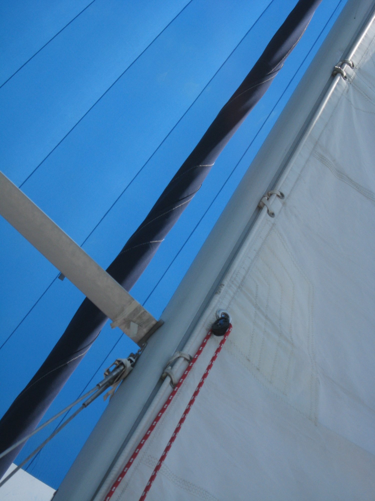

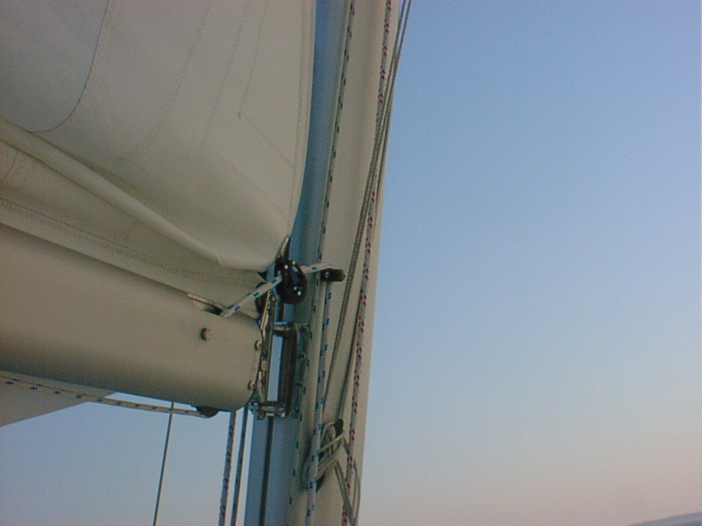

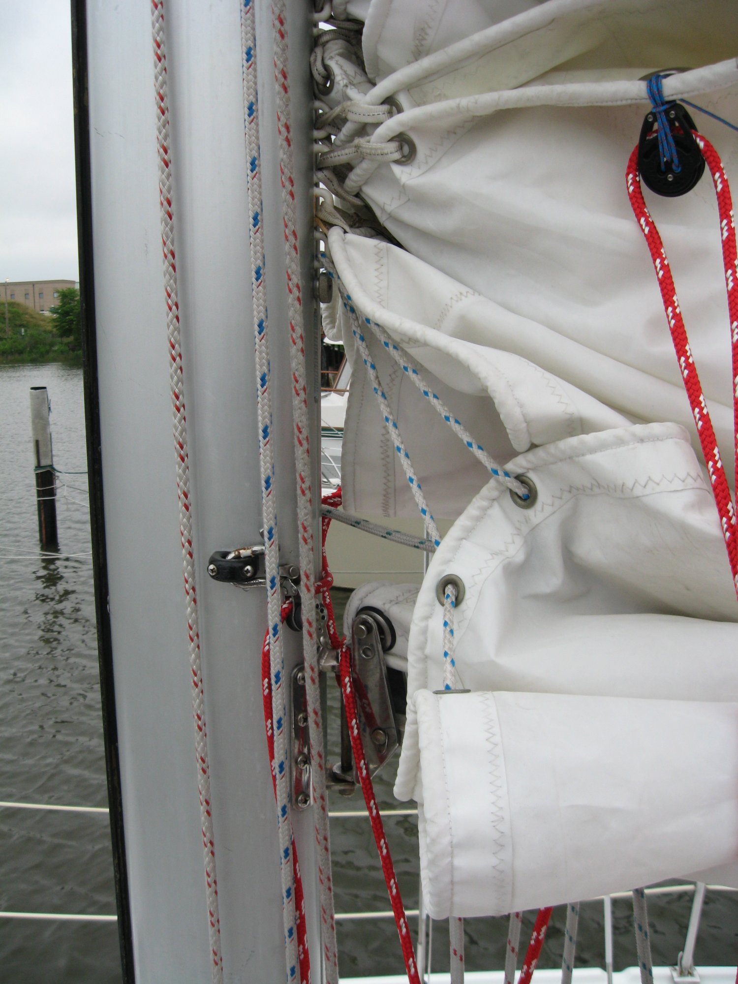

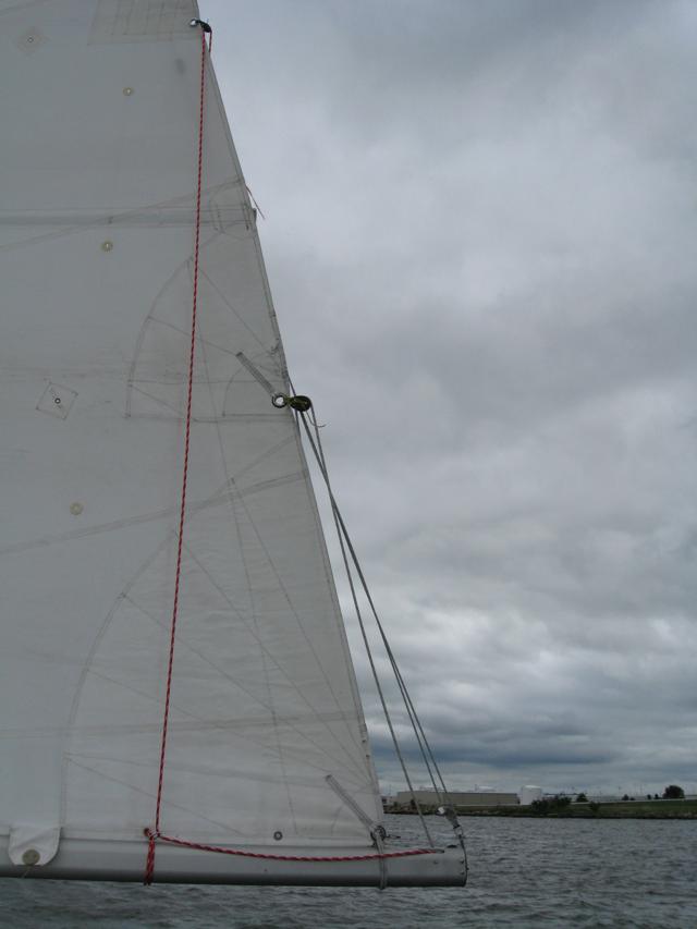

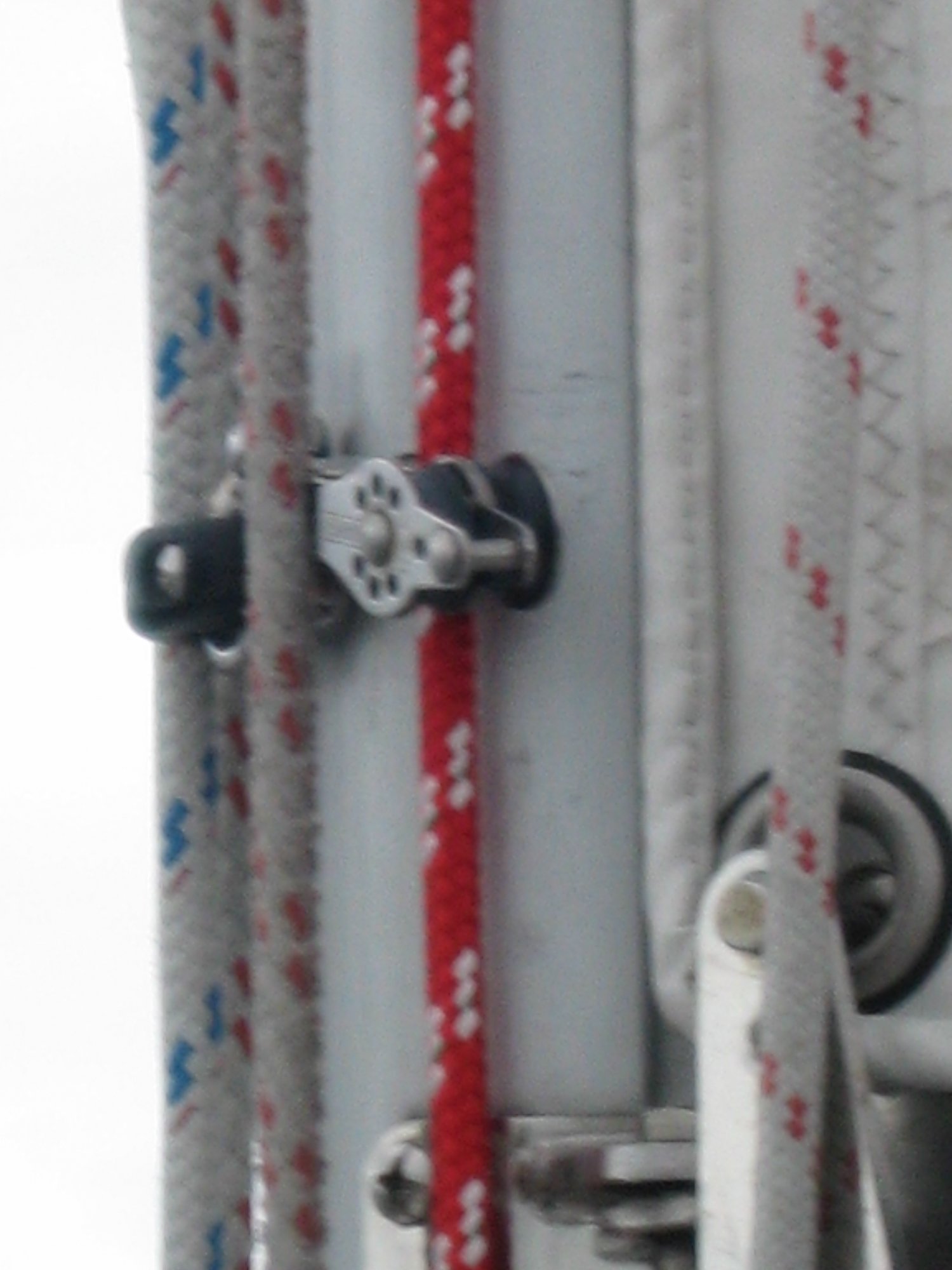

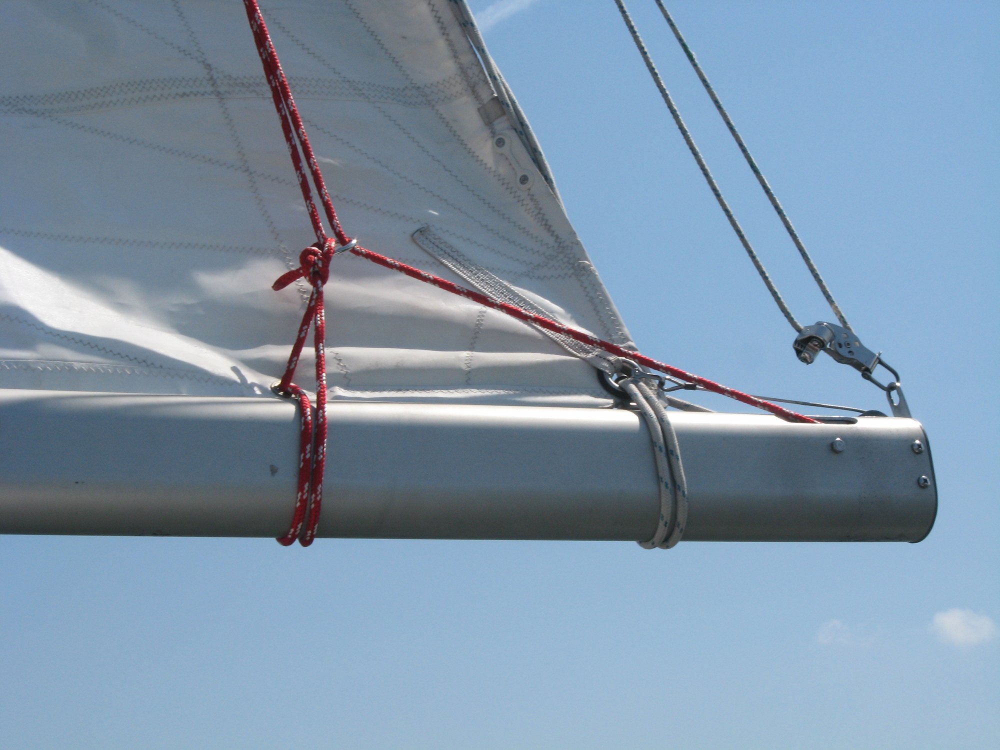

Here are some photos of my second reef. There is one photo of the tack with a line that is not red and white which came from a post from "For pete's sake"; you should be able to find that in the archives. I have to go forward and remove the slug stop to pull in the second reef, and then put the slugs back in when I shake it. My main has a jack line to eliminate this step for the first reef, but not for the second. There is a photo which shows several slugs above the "jack line" that Parsons mentions above for my first reef.

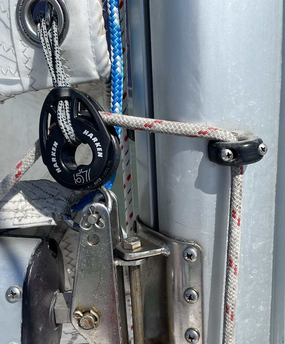

I don't have a 2nd reef set up on my C30 but I do agree with Valcour and Parsons that carbo blocks at the reef tack and reef clew are beneficial and needed to balance the pull on the sail when using a single line jiffy reefing system.
Another plus is by using the blocks you keep the reefing line on one side of the boom, making room for the 2nd reef line on the other side of the boom.
@Hayden Watson taught me about the reef blocks and his method of setting a reef. I lower the main until the reef tack is about a 1' from the boom (for 1st reef). I have my main halyard marked for this point so there is no guessing.
I then pull in the reef line until the luff and the clew tack are properly tensioned. The low friction of the blocks makes this possible. I don't have to go back to the main halyard to adjust the luff using this method.

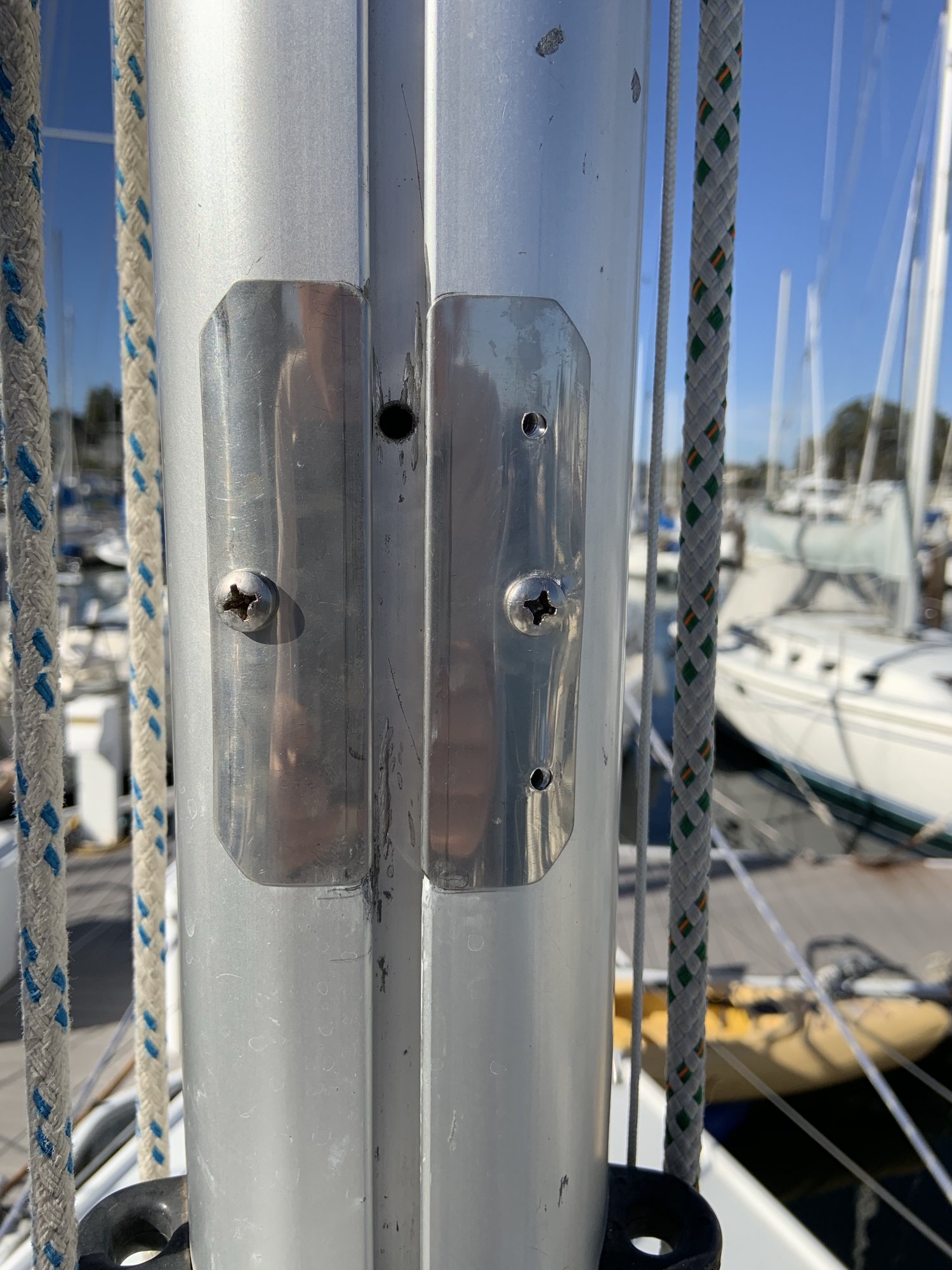

I replaced our slug stop with a mast gate when we added a lazy jack/sail stack combo. It took me several tries to get the screw holes in the right place, but it was worth the trouble. Bought it from http://mastgates.com/

I'd be curious how the Mastgate works and your experience with it @marchem . I've got a traditional slug retainer that screws into the mast at the top of the feed slot. Removing slugs for a second reef requires a trip to the mast, removing an inch of threads with a thumbscrew-type nob (keeping the screw!) and pulling out slugs. I don't have a jack-line on the second reef, so it's a pain, especially considering that you'd go from one to two reefs in rougher weather. Does this Mastgate save you any of those steps, particularly the trip to the mast or the unscrewing?

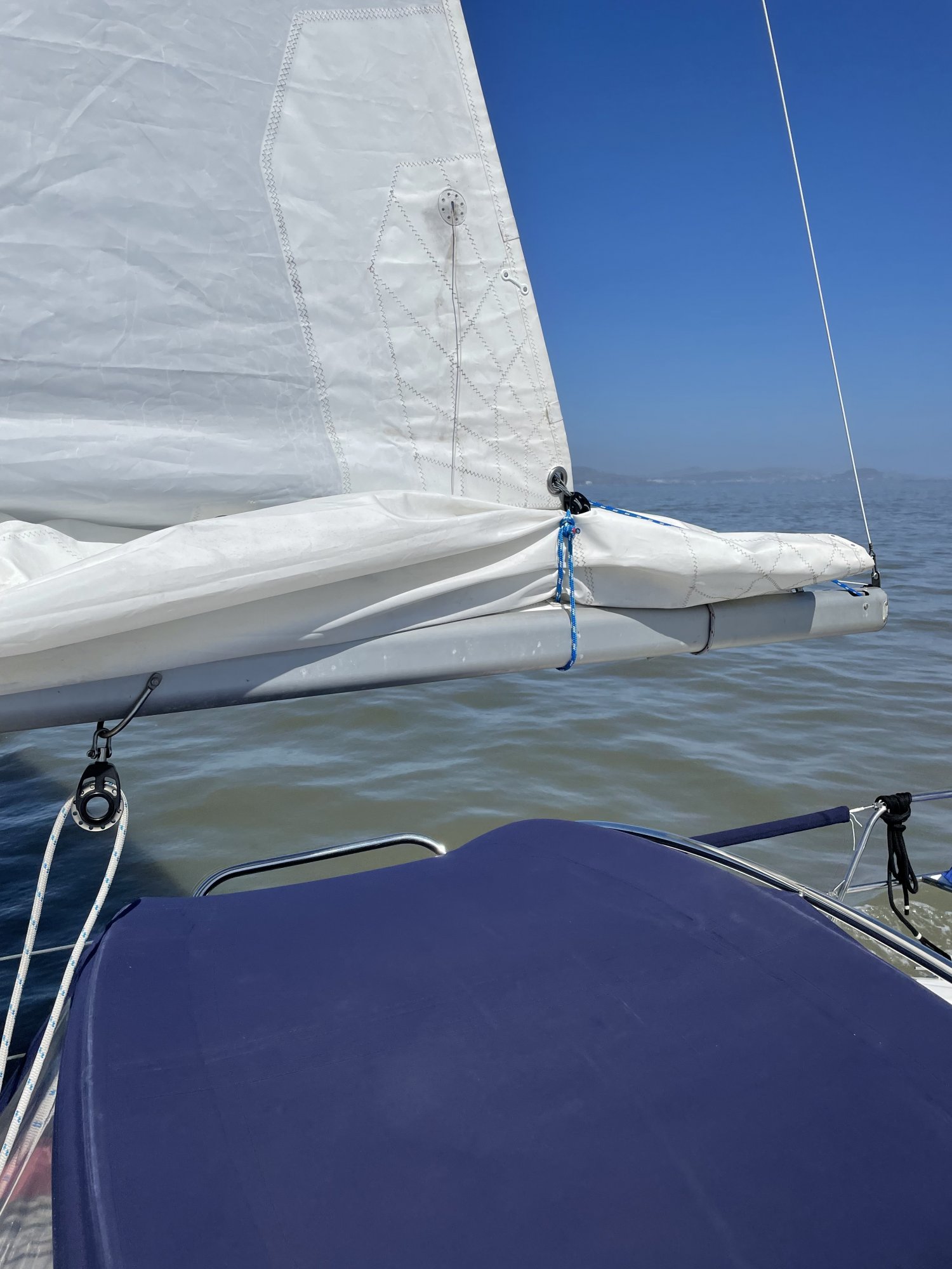

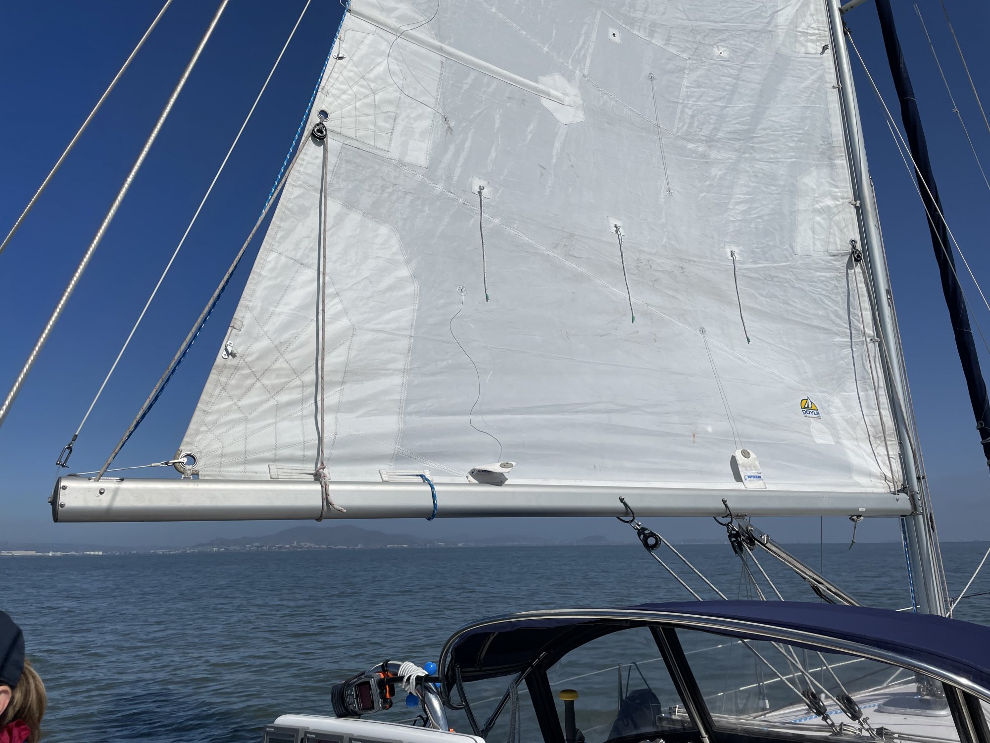

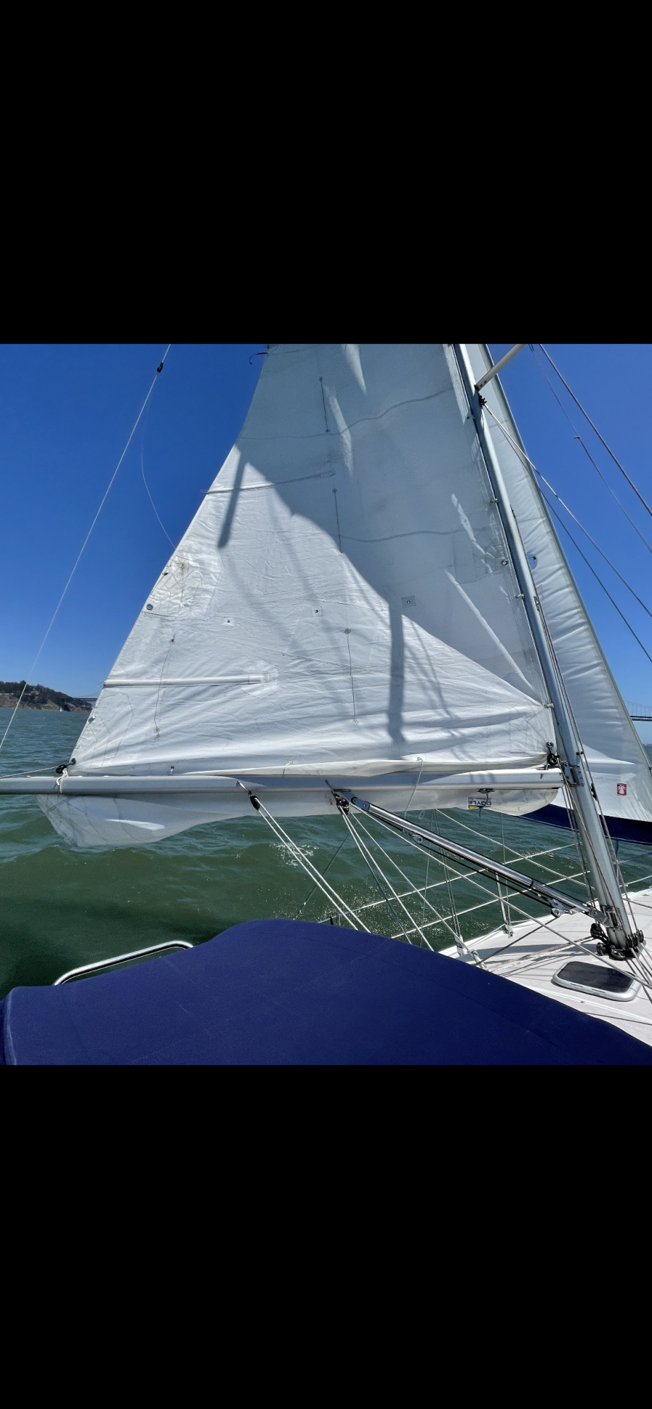

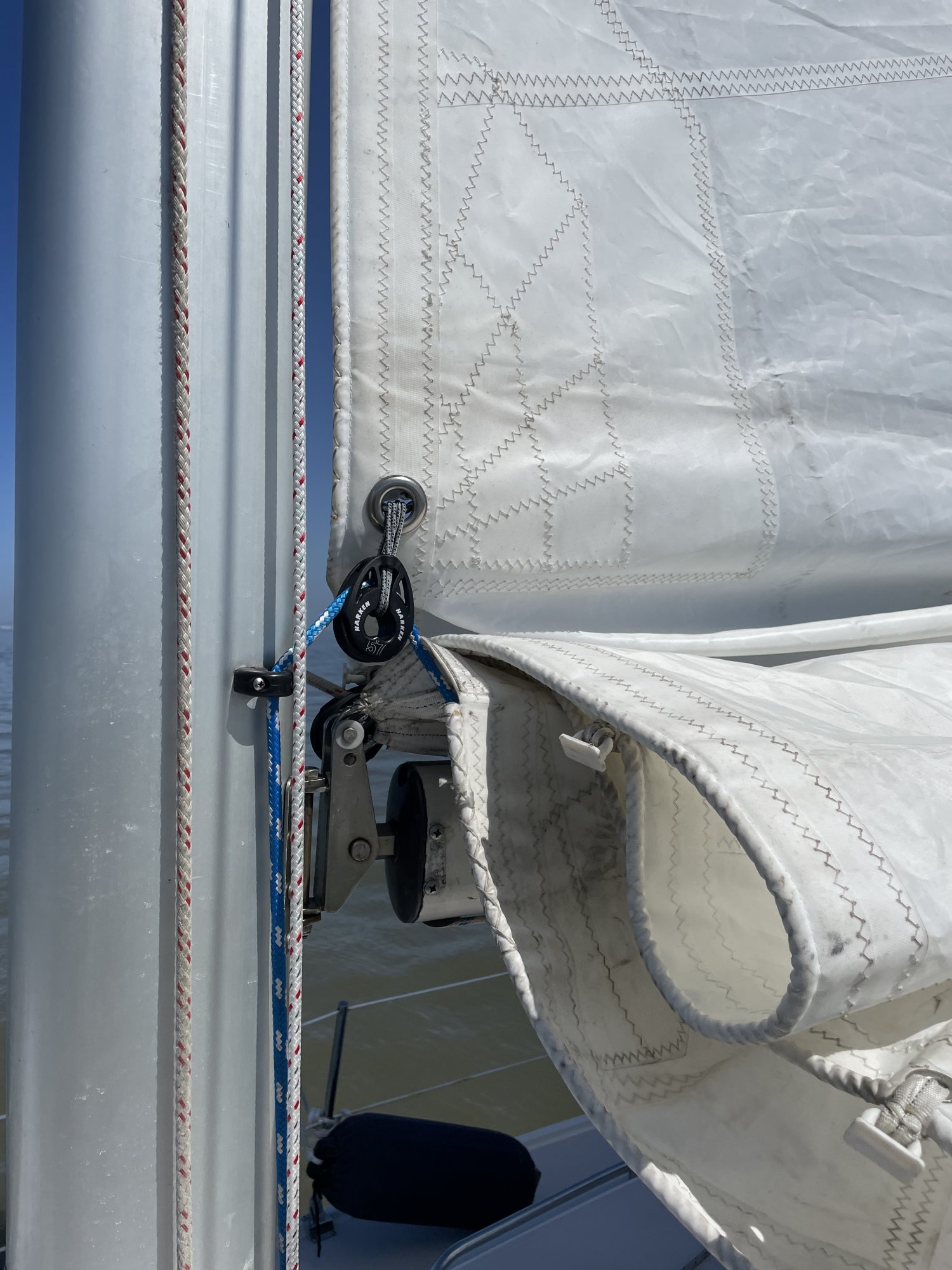

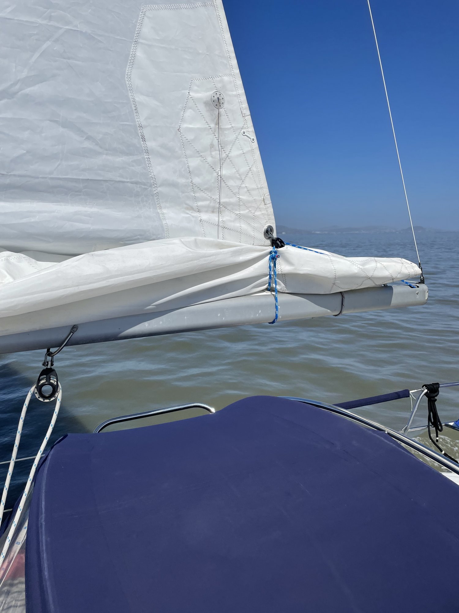

We got the second reef all sorted out and it works great! We used the carbo blocks for all the reef grommets. We each practiced numerous times and got our process down. Reefing and running with gusts nearing 30 today was easy.
Still planning on a mast gate to avoid messing with the slugs and thumb screw, but it turns out we only need to do that for reef 1. Reef 2 sits high enough at the tack so no further slug is affected.

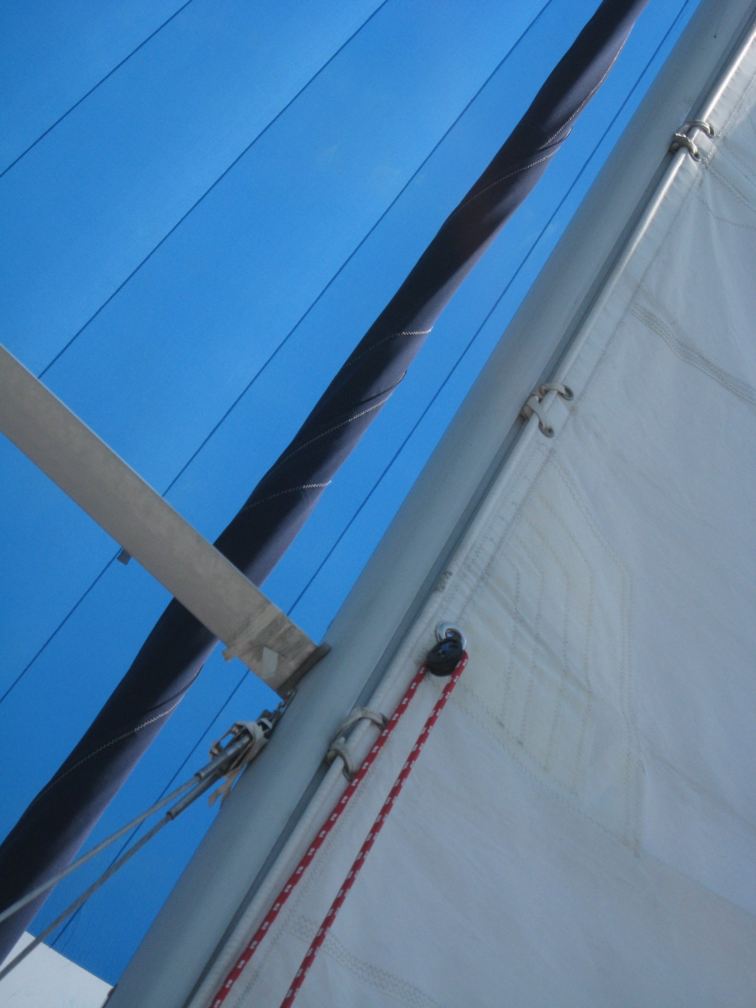

8,177
Looks good!
If you look at the picture of your main with the no reef tied in you may notice that the bunt line and leech cringe(l) are not in a straight line. The leech cring(l) is at least 3 inches higher on the sail then the luff cringe(l). I believe that is why single line reefing is more challenging. You draw the sail down a different distance at each end.

Very good, It looks like you run the reefing straight thru the boom without a shuttle block inside? This is the simplest single-line setup i;'ve seen.
You might change the termination of the second reefing line on the boom to a running bowline
That should allow reefing line to pull the clew right down to the boom, making the bottom half of the sail a little flatter than when the clew is allowed to rise.
Yes, the fish tape ran straight through from aft end of boom towards the mast and I couldn't see any internal block inside. That was actually the easiest part, and what I thought would be the most difficult.
I see what your saying on the better knot for the 2nd reefing line where it ties off at the boom. I'll give the running bowline a go. Thank you!
I'm also going to lower this not-so-fair lead on the mast for reef line #1. The angle causes a lot of friction, probably because of the carbo block, but I think the carbo blocks are a great improvement overall.
