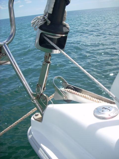

If it's really easy and kept on the trailer and you have a set launch routine it couldn't hurt to ease it I suppose. I use a quick release lever on our forestay that'd make it very easy to untension the rig but I never do. See pic.
Have a great season, Mike

I'm with Mike. We step our mast everytime we sail. I tension it in the spring then don't worry too much about it. I have a backstay lever as shown above but I step my mast forward so the lever is on the backstay. It works slick!
