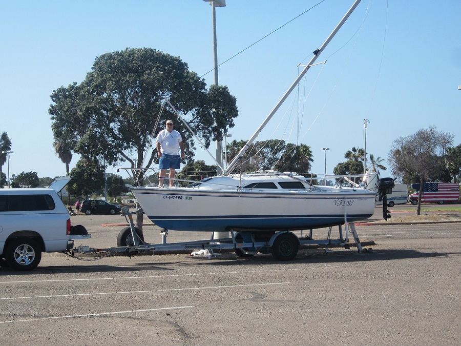

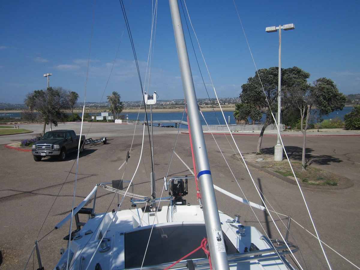

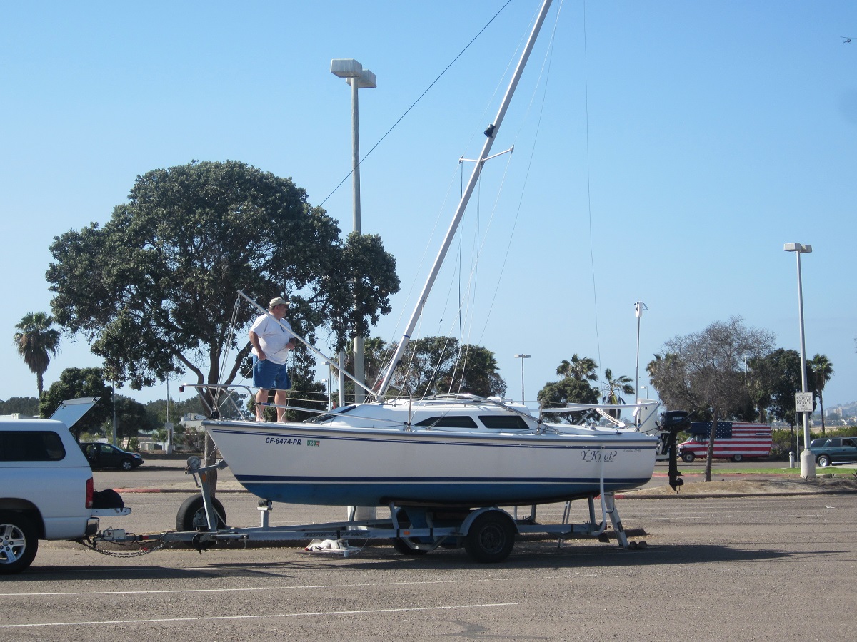

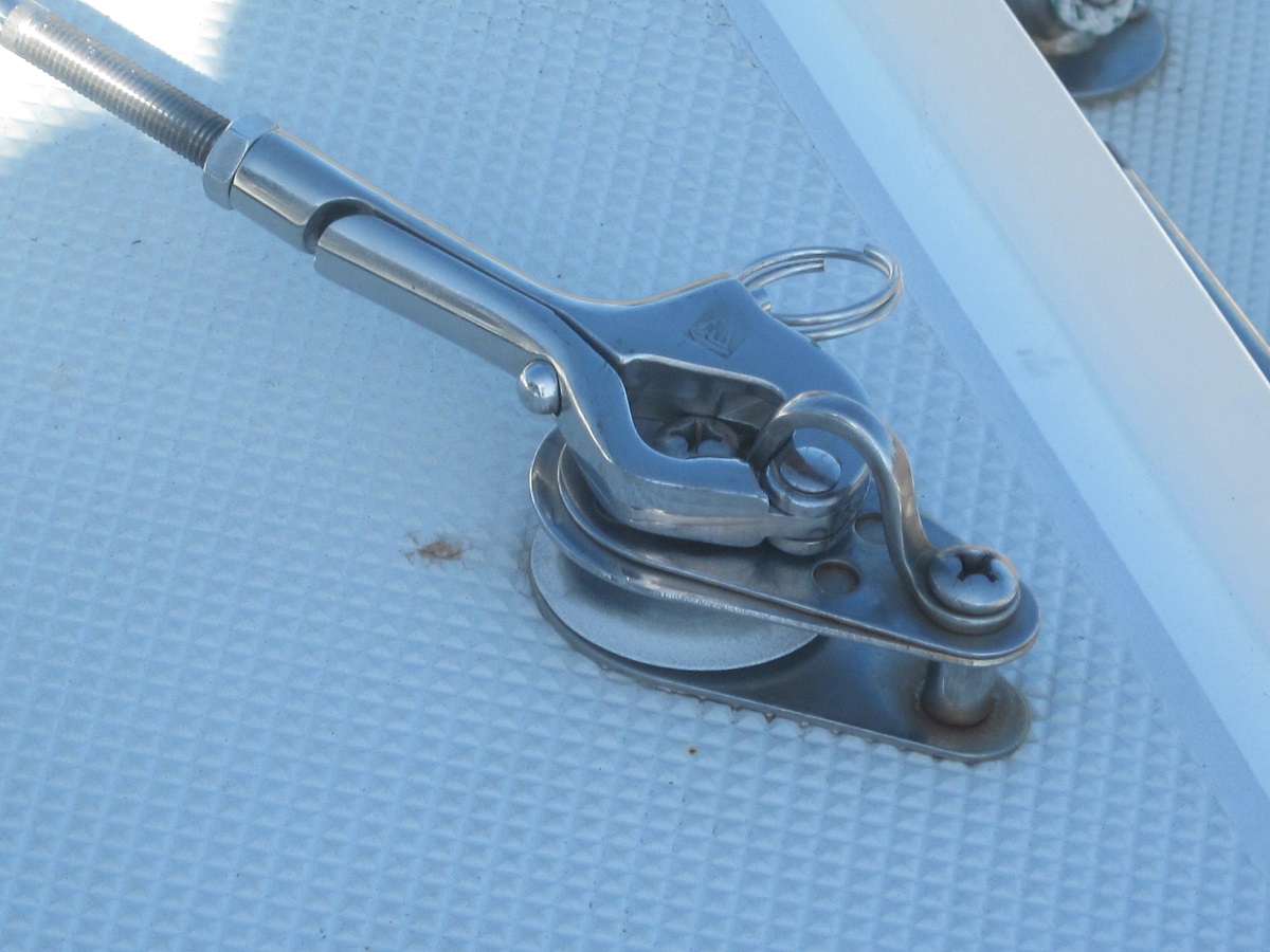

Probably more versions of mast raising systems than different types of mouse traps. I tinkered with several, and I really like the system Steve Hock came up with, and built one myself. Great for the older versions of the C-22. But my all time favorite still is the mast raising system the Catalina factory came out with when they introduced the MK-II. All of the masts for the MK-II's and the Sport came from the factory ready to use their mast raising system. It wasn't until the factory started buying the spars from Selden that they discontinued it. No tools required, and the 4-1 purchase makes it super easy. We travel around a little and often there is no one walking by to assist, and the factory system is so easy, even a fat old decrepit sailor can easily accomplish the task by himself.
Don
Baby stays attach to the mast with T-fittings minimizing the side to side movement of the mast.
Pelican hooks attach the bottom of the baby stays to the halyard turning blocks on the cabin top
Just a pull on the line with a 4-1 purchase and up she comes easily.
A stay snags on something while raising the mast, or maybe you just want to pose for a photo? No big deal, the cam cleat on the lower fiddle block holds everything secure. The same system was offered with the C-250's with a much larger and longer mast, so on a C-22 it's way stronger than it needs to be.

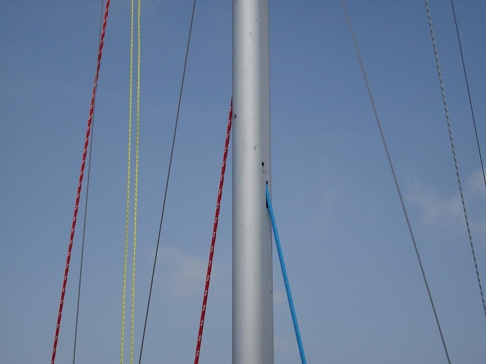

LakeShark , I'm still on the trailer in front of my house. The purpose of this exercise is to check everything as I reinstall all of the mast hardware and of course, practice. One critical thing is that I have not installed my halyards yet. I have the Ronstan exit 'slots' (not sheave boxes). I will post pics of those when I install them, but I want the mast up when I decide on their location and mark the positions. They will up high enough from the mast step than you can physically heave on them so eye ball height at minimum but not higher than an average person can reach. Plus, they have to be off-set from each other on either side of the mast. The slots that are drilled and cut are smaller than what you would cut for a double or even single sheave box, and separating them by say 18 inches on the vertical while juxtaposed fore and aft will prevent creating a weak spot in the mast. More on this in following posts.

My Capri-18 just had offset slots in the mast for the halyards to exit about 5' up from the base. I believe the Capri-22 follow the same method. Smaller slot, no hardware, no screw holes, just a simple slot.

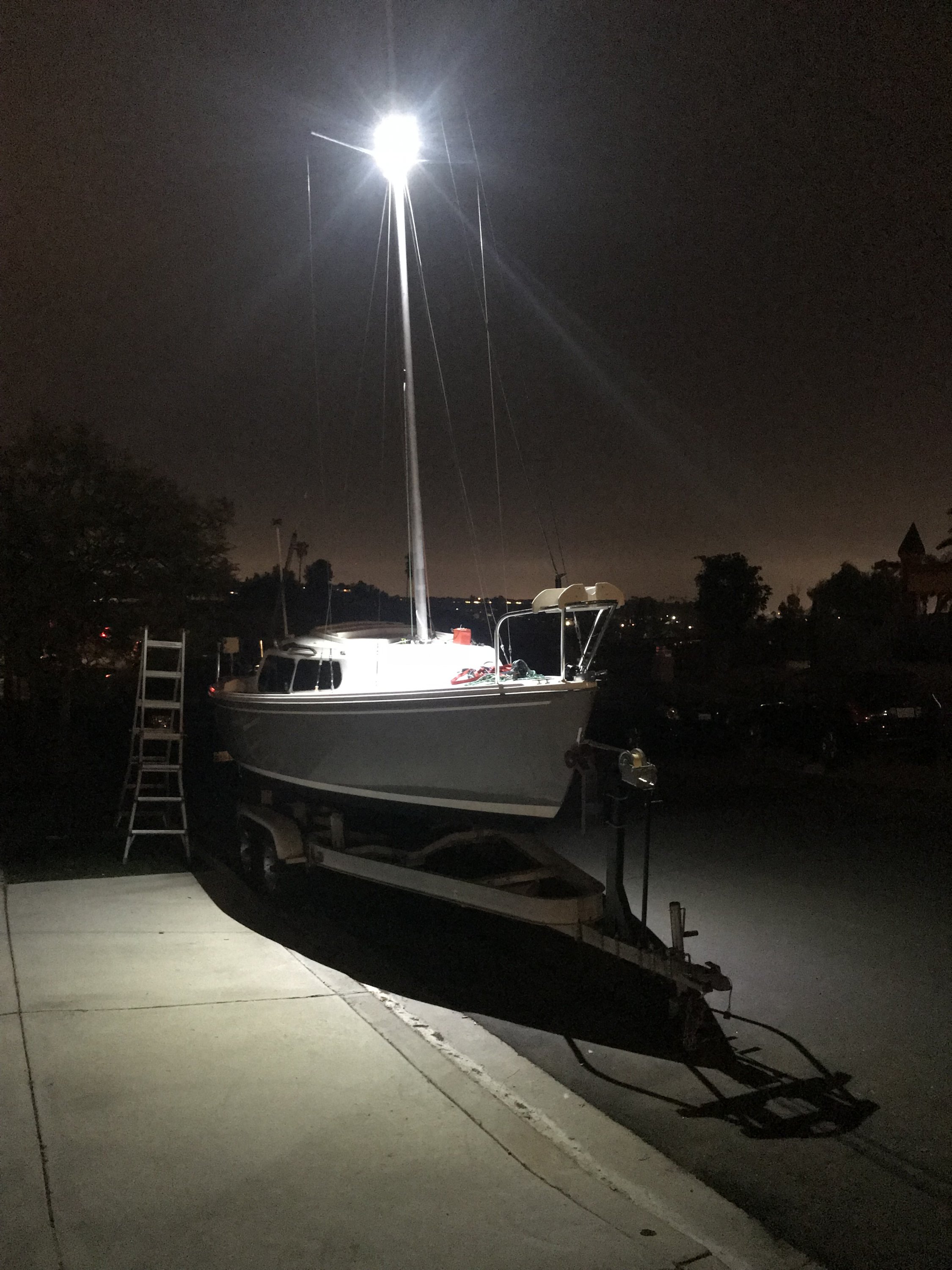

This weekend I finished up the mast wiring. I had made the wire loom with Ancor 18 AWG, everything on the mast is LED so I would have used 20 AWG if I could find it. For conduit I used 2 10 ft pieces of grey PVC electrical conduit, size 1/2" which is the ID and it's 3/4" OD. I cut off the union ends and installed them separately leaving a gap right at the spreaders, thats where the deck/steaming high pigtail exits. Long story short, I took pictures of most of it but I'll either write up a separate mast wiring thread or put them in my resto thread when I fix all the pics. Just for giggles, here is shot of how the deck light works after I got the rig back up;
