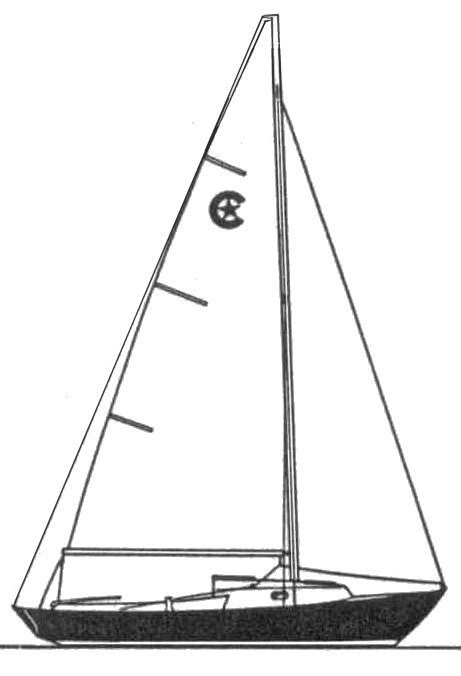

Thanks for your response. I've never seen the boat with the mast and sails on her. I've just had her rehabbed and I'm looking for pictures/drawings showing how to step the mast, run the main sheet, connect the jib to the roller furler, etc. It may all become obvious once I get started but the more information I can acquire the better.

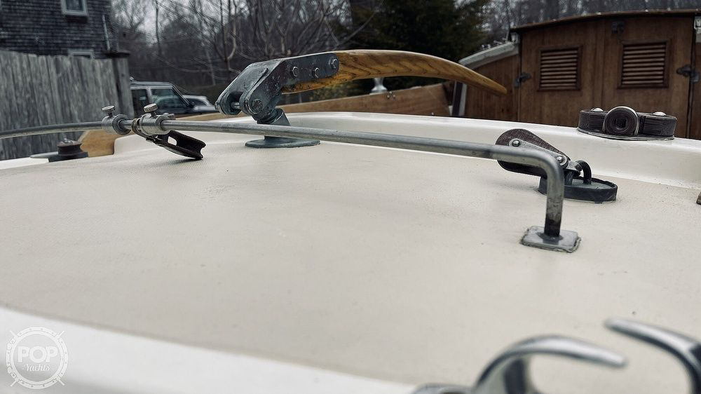

Dear John, Thanks very much! The images are very helpful. The arrangement for the main sheet is very interesting in that it appears to run through eyes and cam cleats on both port and starboard sides. It's not clear to me why this is useful/necessary since there is a block that moves across the traveler. Any thoughts?
23,613
In this design (OEM), the bar is the traveler. The blocks on either side run up to the boom and to the bllock on the traveler. This gives you the ability to control mainsail and trim the mainsail.
It is a design from the 60's. When the boat was introduced.
There are newer designs. Without any images of your boat, I have no idea if the previous owner modified the boat you purchased from the original design.
