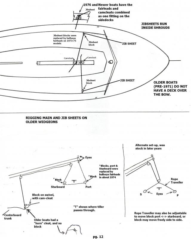

I am in the last phase of restoring a 12' O-Day 1973 day sailer. I have nothing to guide me in how the lines for the main sheet should be "threaded". Photos of the day sailer all seem to have any help. No one in my area have this boat. I can find nothing in the library etc. Has anyone got a Jpeg they could send me.? Do not want to wind up with a row boat.

Better yet, ask a former WIDGEON owner! <GRIN!!>
WARNING: I love to talk about my boats!
You can get a manual on Iheartodays, but it is for the older 1962-70 models. For the same price I have one that covers 1962-2003. As well as scans of several brochures (including 1973).
Anyway, from my manual:
