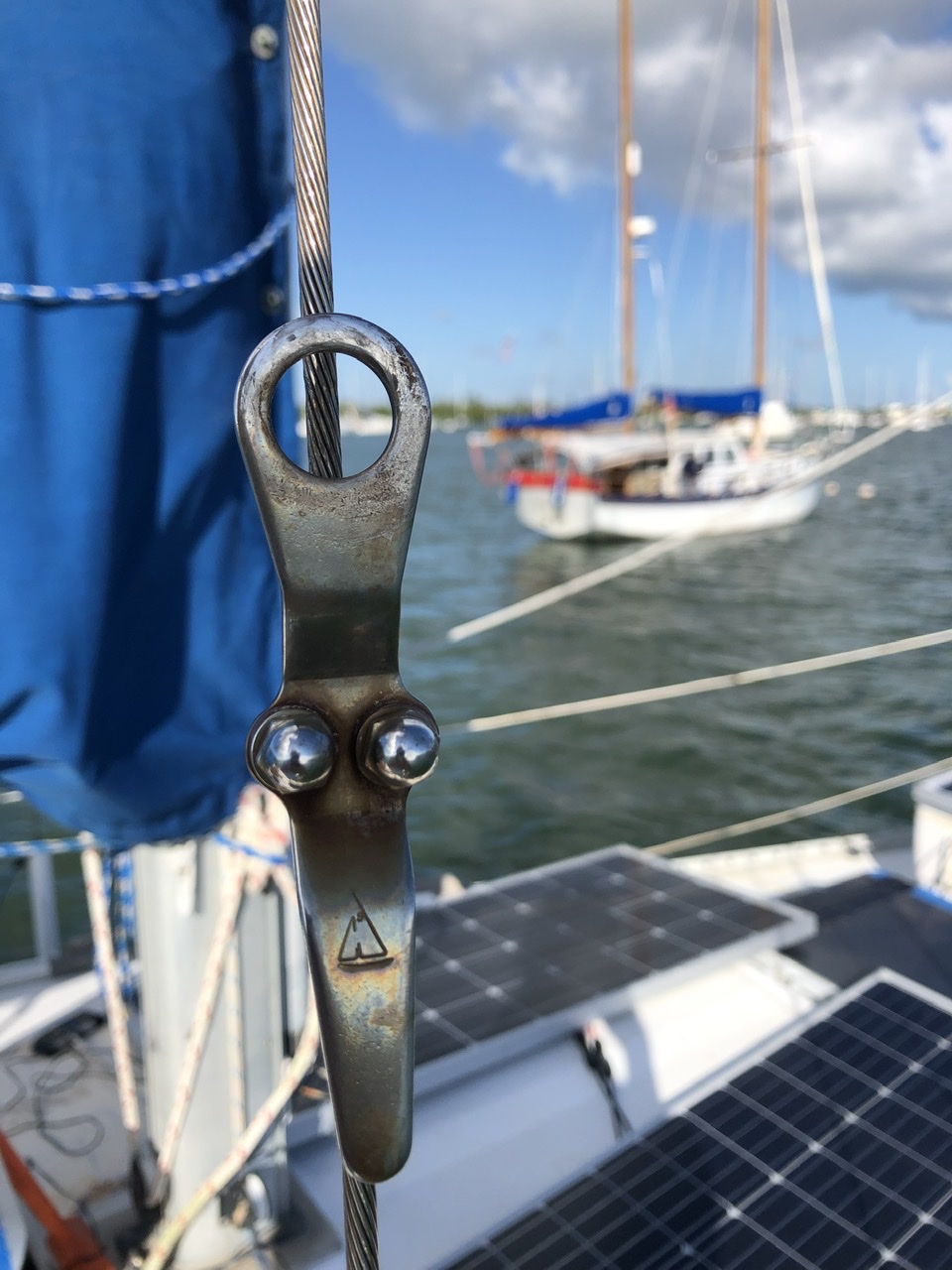

Hello everyone. New to the forum and ready to learn! Just started my liveaboard adventure and wondering what these are. I have them attached to two of my stays.
thanks!

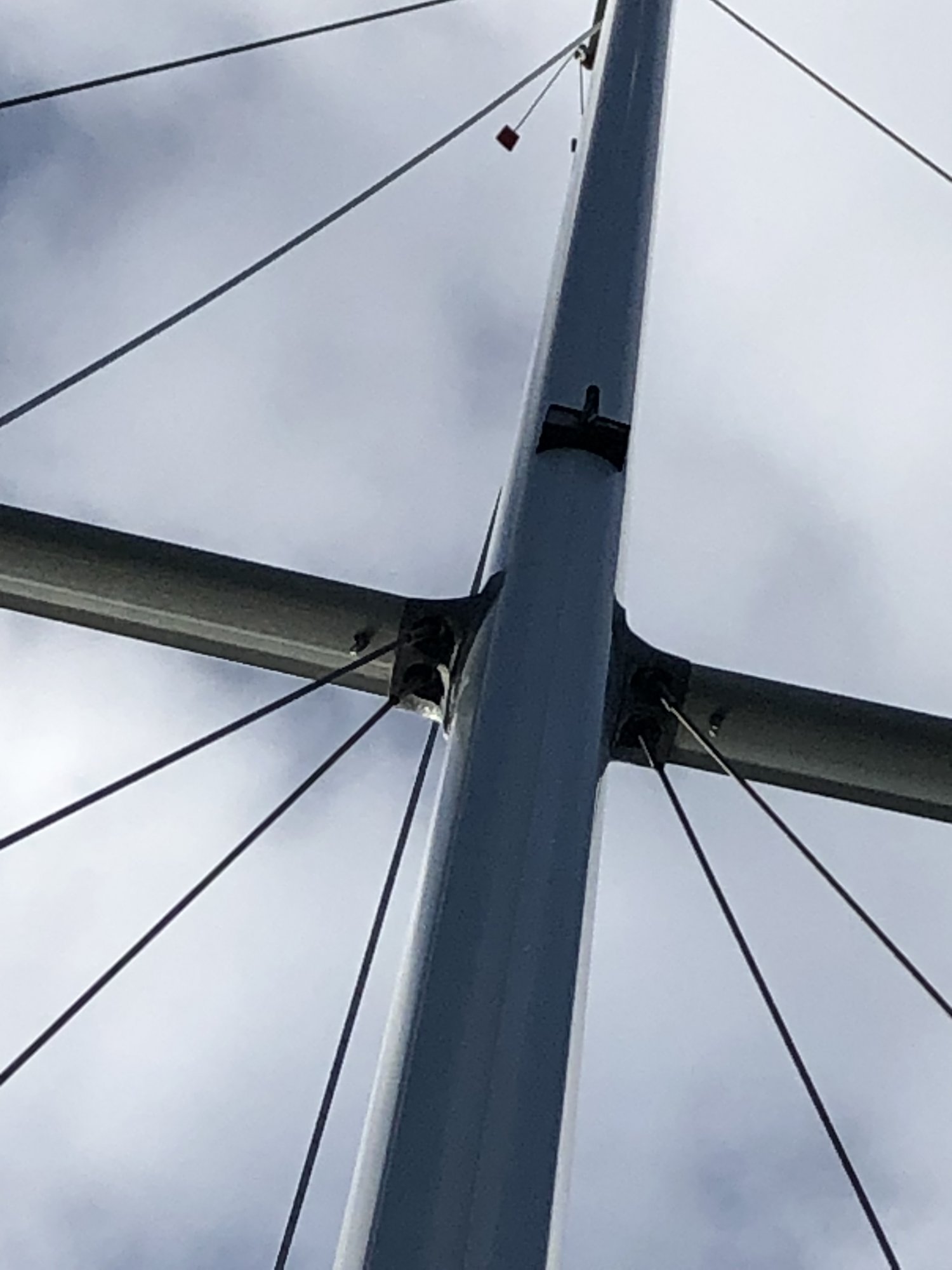

Do you see a small block on the bottom of the spreader above this? If so, you need to figure a safe way to get a line through the block.

Those are possibly attachments for blocks. Hard to tell from the detail of the picture.

Those are usually flag halyard cleats. There would likely be a small block on the underside of the spreader above.

The eyes on the spreaders look like they'd be good to rig bullet blocks for flag halyards. A radar reflector wouldn't fit between the fitting and the shrouds though. Are there others further outboard on the spreaders? You would want those set inboard far enough for the radar reflector to clear the shrouds. You may not need a radar reflector too much in Florida, however.

Never put them on the forward lower shrouds where they can snag sheets. It is safer to mount them on the inside of the middle or aft wire to lessen the snag possibility, and give a cleaner run to the flag halyard blocks on the spreaders. You can use those shroud cleats anywhere you find a need... I have one on my backstay for my national ensign with the small, upper halyard block clamped farther up the wire.(Btw, always fly the national ensign, i.e. your country's flag, from the stern or farthest aft location on the boat,... never, never from the flag halyards on the spreaders).
Also, the width size in inches of your national ensign should approximate your boat length in feet. So if you have a 30 footer, try to find a flag close to 30 inches wide. It doesn't have to be exact, just close.. 16x28 for example.

That's a combo shroud cleat. The cleat version is used as mentioned before to tie off a spreader halyard used for burgees or reflector. The eye on top is for your main halyard when not in use. Keeps the slapping down..
ALSO, I'd turn it around so it's inboard on the shroud...
