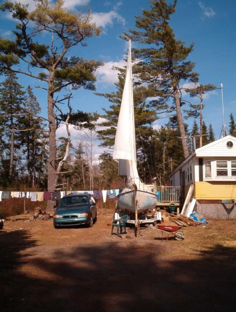

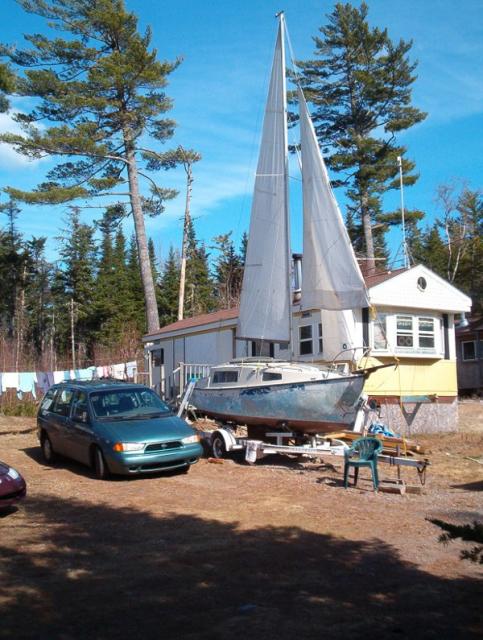

Hiee all. Today being such a nice day we decided to step the mast (for the first time) and check out how our new mast step works as well as to see what shape the standing and running rigging was in. It seems as though originally this boat was a fractional sloop and then someone added the bowsprit and made it into a masthead sloop while also allowing it to be rigged as a cutter. Question: how do we set the Jib and inner sails? Today we just kinda guessed at what we were doing.

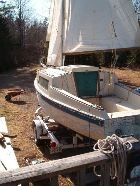

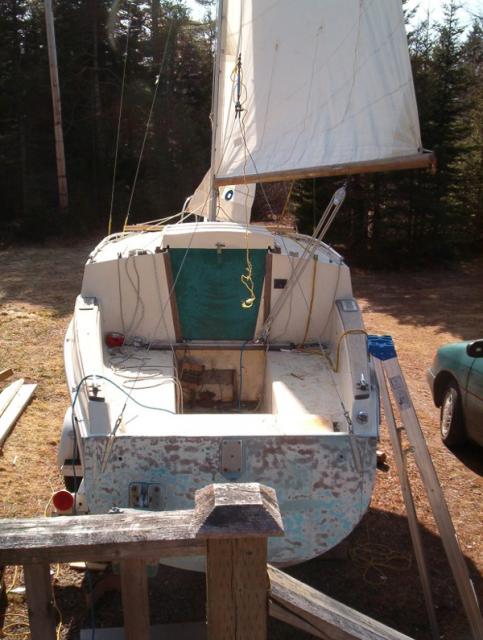

It appears there are cleats on the cabin roof for the sheets. Look for some small jib lead blocks or bullet hole shaped fairleads to guide the sheets to the cleats.
Some closer up pictures of the cabin top area and sides would be a great help.

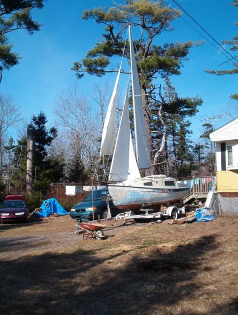

The pictures are too small to make out the detail of the sprit. Are there 3 stays mounted forward of the mast? It looks like there is a forestay for the headsail and a babystay for the staysail. It also looks like there is another wire.
While not being an expert, but after having sailed many a nm on a 38' cutter, this is a different rig than most cutters. Additionally, what has been done to secure the bowsprit? There are some extreme loads on the bowsprit and it must be held down and to the centerline. I can't see the rigging that does both these chores.
The sails that you have rigged are small for the purpose of a cutter. Most headsails on a cutter are 110% to 135% with the staysail being about a 70%. The mast location on a cutter is also a little further to the rear than a sloop.
If the bowsprit is anchored and safe, then I'd tune the rigging and give the boat a cautious try.

When the bowsprit was added it looks as though the original forestay was moved out about 12'' beyond the bow. A second forestay was added the end of the bowsprit to the masthead. There is also a second line ss from the underside of the bowsprit to the bow hook with a turnbuckle to tension it. The stay sail is actually on a furler now and the baby forestay is not used for hanking. The halyard for this is a ss line though.
What there isn't is any way to fasten the clew of the headsail and appears as though maybe there never was. We have tracks and cars on both sides of the cabin top to route the sheets for the staysail and there are pulleys on each side to the cabin on the grab rails to route the sheets for the headsail.
