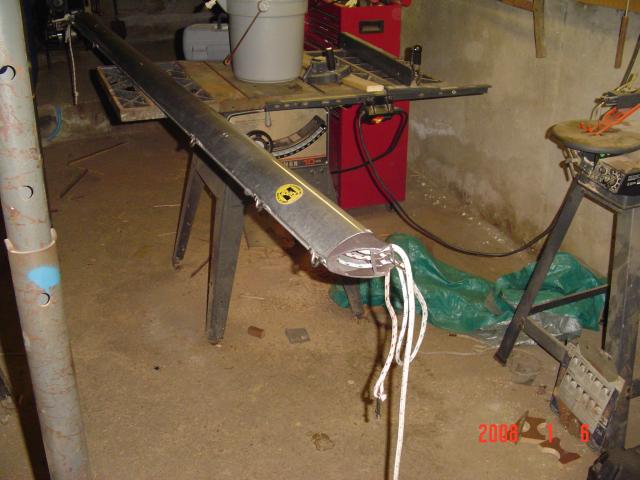

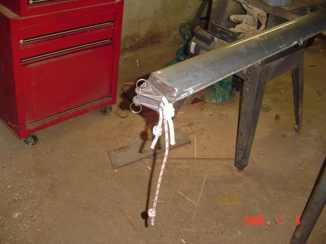

Joe,
I have a 1986 O'Day 222 with Z-Spar internal halyards. My boom has three internal pendant lines with three sheaves at the end of the boom and three clam cleats at the goose neck. I'm using the center line for my clew out haul, the Starboard line for my topping lift, and the Port line for my reefing. My topping lift consists of a covered cable similar to a life line, which is attached to the mast head and comes down to within 12" of the back of the boom. The end of this cable has a marine eye swadged on and a single sheave attached to that. The Starboard line coming out the end of the boom runs through this sheave and is attached to the end of the boom via a small shackle. When I reef my mainsail, I do it all at the mast. In the reefing procedure with the sail up, I take up on the topping lift which will support the boom so that I can lower the main sail down to a point where the reefing cringle is even with the horn on the goose neck, commonly called the "Ram's Head". I remove the first sail slide from the sail track. (leaving it in creates too much tension in the lower portion of the sail when it's reefed.) I then insert the luff cringle on the horn and pull the reefing line so that the new foot is stretched into position. The topping lift is let off, and the loose sail is roller and tied with the three reefing gaskets using slipped reef knots. I'm not familiar with the type of reefing that you have on your 240, but maybe it works as well as what I'm using once you get used to it. I would attach two strong twines on to these lines for tag lines, and pull out the pendant lines just to see what it looks like and how it's made up. Also, you may want to call Rudy Nickerson Nickerson and ask him about this type of reefing. He owns all the O'Day boat molds and at one time, was having this boat along with the 192's built by a guy in Bristol RI back in the mid 1990's. http://www.drmarine.com/ Here's some pics of my set up. That last pic shows a short line above the winch with a slipped reef knot tied to it. I use this for my sail slide stop, and it works great. Check it out.
