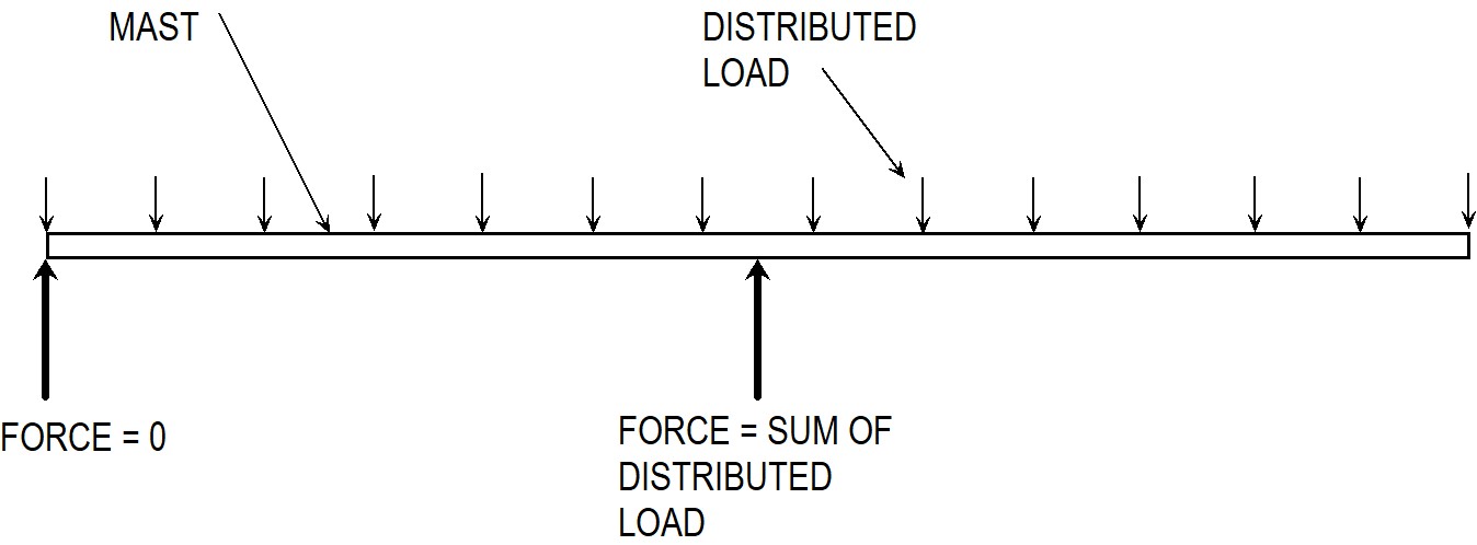

ralph, lay you mast on it's side. you pick it up from the area around the spreaders while wifey picks it up at the head of the mast. who is carrying all the weight?

Thanks, @DArcy . You're right, it was not my intention to consider all mast loads at this stage, only to create an aid to visualizing forces related to lateral mast tuning.
....the sail load is lower at the head and higher at the foot of the sail.
I had attempted to convey that with the shape of my distributed sail load, but I agree that it's not accurate--again, only meant to convey notions about forces related to lateral mast tuning, not an analysis.

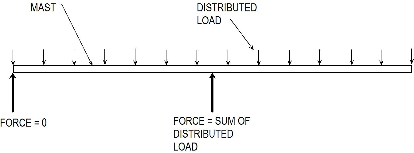

A somewhat peculiar response to the matter at hand, but let's take a look at it.
Here's a force analysis diagram (as you have described above) with the mast in equilibrium (it's at rest and not moving).
It shows me supporting the total weight of the mast while wifey is not required to exert any force to keep the mast from moving. Now what the hell this has to do with with your idea of unbalanced tensions in a shroud on a vertical mast, completely escapes me.

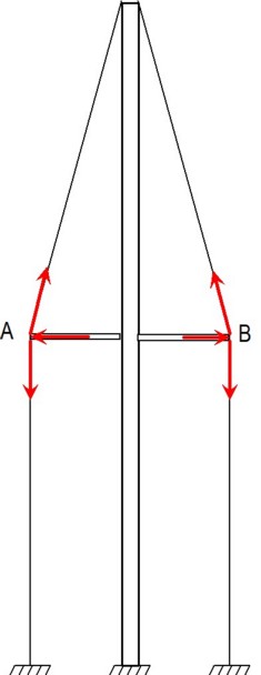

You are using "stay" when you should be using "shroud" so let's look at a force analysis of two opposing "shrouds" on a mast which is what I believe you originally intended.
This drawing is in equilibrium as is your mast.
Looking at point "A", the the tension in the upper shroud must equal the tension in the lower shroud because the spreader does not offer any vertical force TO THE CABLE. The shroud merely slides in a groove at the tip of the spreader. For those of you really on the ball, in construction there is a very slight upward tilt to the spreaders which bisects the angle formed at point "A".

Now that you know the difference between a shroud and a stay, lets proceed from there.

I’m pretty sure Jon’s point was about the lower shrouds, not the lower sections of the upper shrouds that you’re referring to in your drawing. It is safe to say that the full upper shroud has equal tension along its length.
David, use of improper terminology will only serve to confuse newcomers and those asking questions.
Yes, uppers are usually set tighter than lowers because the upper wire is longer and subject to more stress. (Calder), and Catalina so recommends, too.
But that's not what he "said" either.
And you're right, of course: "...the full upper shroud has equal tension along its length." Not "safe to say," but simply correct.
