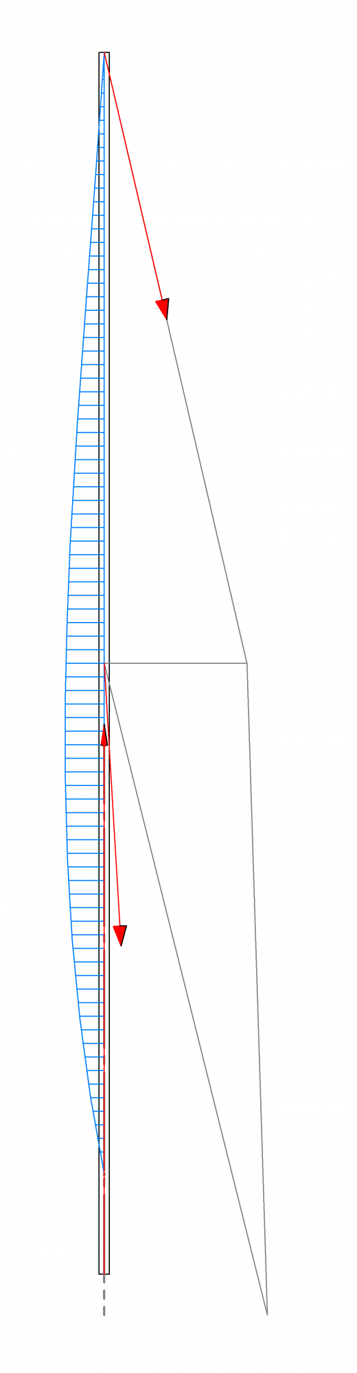

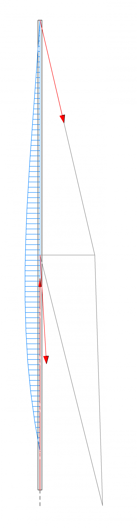

I know for a "fact" that my forward and aft lowers have less force than the cap shrouds. All I have to do is look at the chainplates. Nice beefy ones going to a serious piece of the hull for the cap shrouds. The lowers have a couple of bolts through the deck to hold the chainplates (if you could call them that) on plus the wire and fittings are smaller.
I agree with that too. But the idea that the cap shrouds have greater tension is counter to the free body diagram showing that the cap shroud only needs to hold the top of the mast, whereas the lower needs to hold the relatively more loaded (by sail area) middle of the mast plus the compression of the spreader holding the more loaded cap shroud. I can’t resolve that discrepancy in my head.

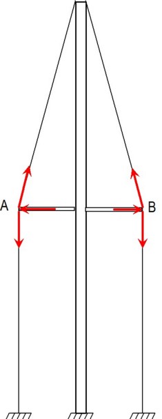

This drawing is in equilibrium as is your mast.
Looking at point "A", the the tension in the upper shroud must equal the tension in the lower shroud because the spreader does not offer any vertical force TO THE CABLE. The shroud merely slides in a groove at the tip of the spreader. For those of you really on the ball, in construction there is a very slight upward tilt to the spreaders which bisects the angle formed at point "A".
Sorry Ralph, "boats are different" alert! My Selden B&R rig has DIScontinuous shrouds, which terminate at the spreader tips of each of my two spreaders. No sliding, no grooves. Your points in the quote are for continuous shrouds. Just adding to the cacophony in this thread to further confuse the casual reader :)

Ok, so it would seem that forces on the lower shrouds, either a single shroud or a pair, would be greater than forces on the cap shrouds? Equal? or less than? (in the dynamic condition with sails under wind load)
  • I opt for Yes. Maybe. Less than.
  • Once you set the rig in place, you need to sail the rig and make adjustments as needed to keep the mast in column. If you are sailing with a maxed out sail plan in very strong conditions, with the boat battering through the waves, the amount of rigging forces will be much greater than on a quiet condition with the wind coming off land and smooth water.
  • If you were racing you would adjust the rig to take full advantage of the conditions you panned to sail. As we are not all racing and are a bit lazy, we compromise the rig tensions and seek a balance of tension and release that can accommodate the conditions we frequently enjoy.
