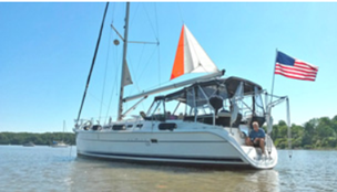

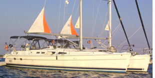

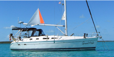

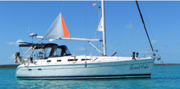

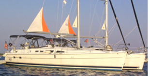

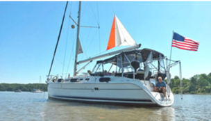

Photos of a riding rails rigged on Hunter sailboats:
View attachment 193241View attachment 193244View attachment 193245
BUT, you are comparing a product that is many times more effective. Not apples to apples.
(I have tested them side-by-side.)

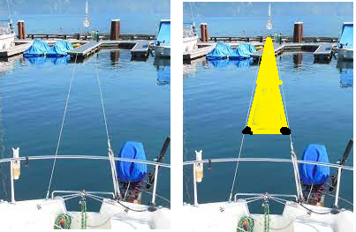

Maybe you could use the backstay. What if you made a triangular piece of nylon that fit in the back stay, supported the edges with some light tent poles (fiberglass) and put a block in the lower two corner (depicted as black circles here)
Then with the blocks and some line, you could let the bottom out a bit and turn it into a shoot that scoops the air. Adjust how much it "scoops" with the blocks until you get the draft you desire. You could even angle it a bit if you wanted the nose of the boat to be a little off the wind.

Thanks for the thought. My back stays are very far apart at the cockpit/transom, so I don't know that this would work for the 381. Keep the ideas flowing, though!
