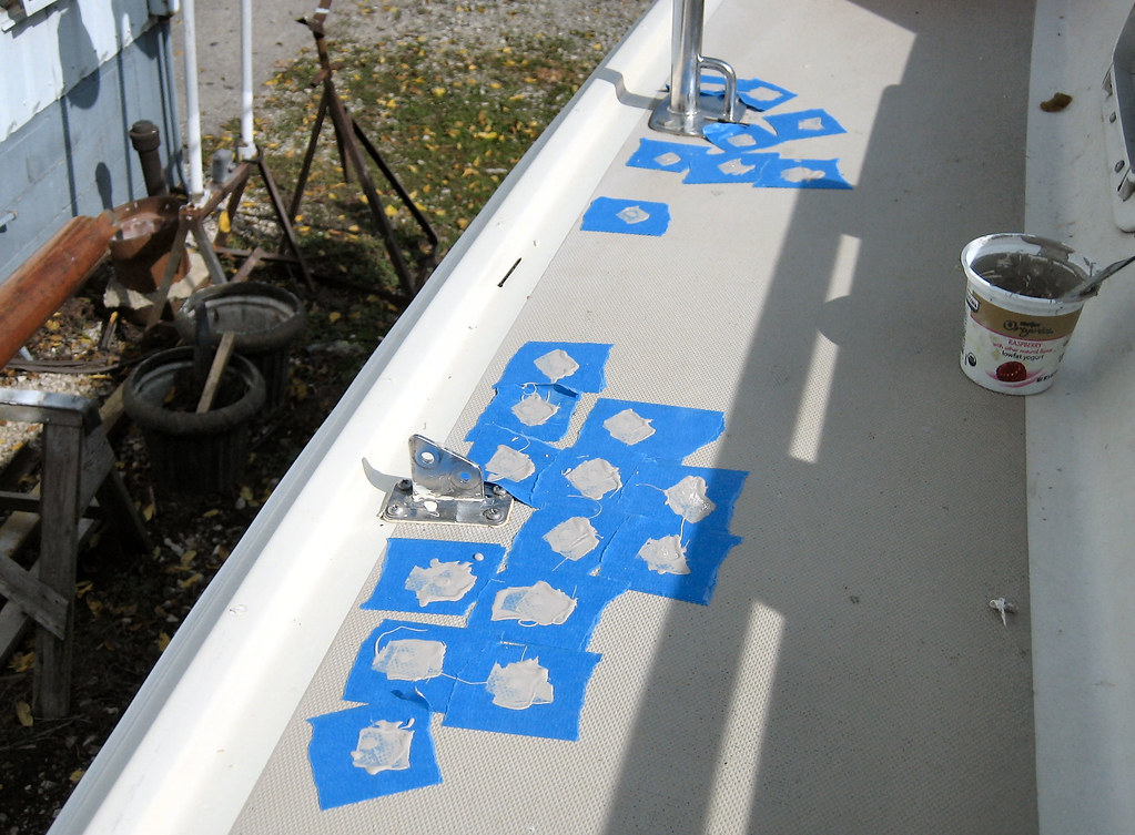

Well thank you for asking, Keith. As you know I've got Pronto! shrink wrapped for the winter which I hope will be mild so I can get enough done to have her ready by Memorial Day. I just built a ladder with two steps for the companionway. The boat originally had just one step which I felt was too long. I think they did it that way so the settee slide-out would have clearance. I eliminated the slide-out.
Then there's the head. The platform was rotted from the chainplate leak. So that area needs rebuilding. I mentioned before that the sink and vanity across from it was also rotted but I tore that all out and I'm just leaving it open for now. Maybe I'll use it for storage or shelves.

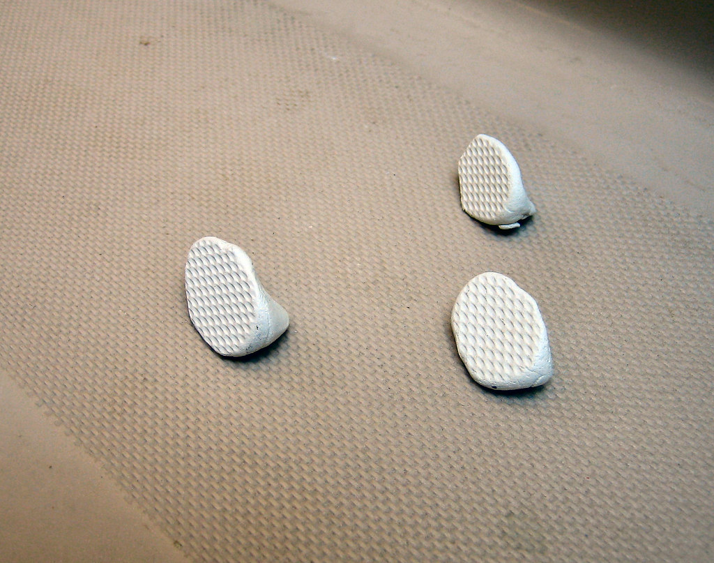

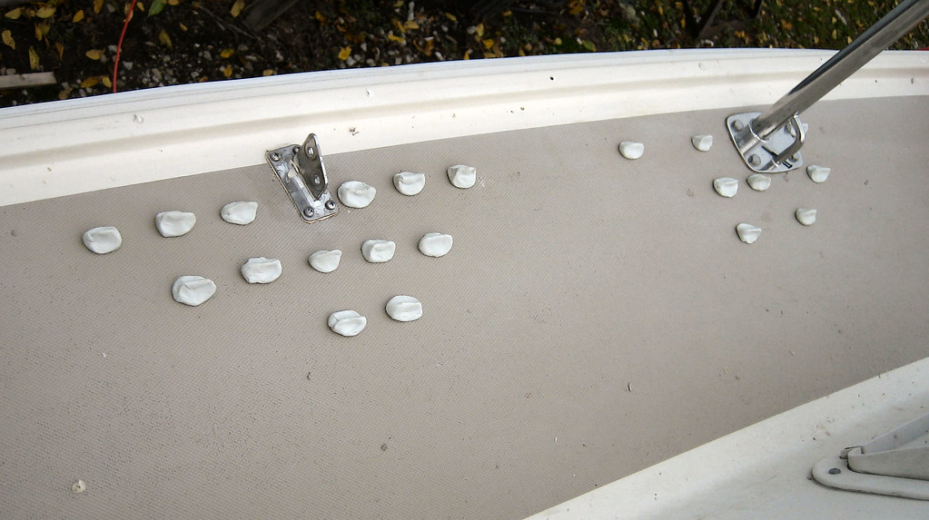

I had mixed success filling the holes on the deck. I worked out a way to fill them and match the nonskid. I took a double layer of blue masking tape and punched a quarter inch hole it and put the tape over the quarter inch hole on the deck. Then I would mix and color gelcoat to match the nonskid. Fill the hole level with the tape (two layers works OK, three maybe too high- haven't completely worked that out). Remove the tape.
Then I used "aqua-mend" epoxy putty and made some stamps with the nonskid pattern and put them over the gelcoat.
Sorry, I don't have any pics of the results yet. The level of success depends a lot on the color match. Sometimes the gelcoat plug would
stick to the stamp and come out. If I'm not satisfied then I just drill it out with a 1/4" drill bit and do it over. Anyhow it's cosmetic since I injected Git-Rot in all the holes last spring. I doubt if I'll do anymore on that 'til springtime. I can even do it when she's in the water.
Mainly I want to have her ready to sail first.

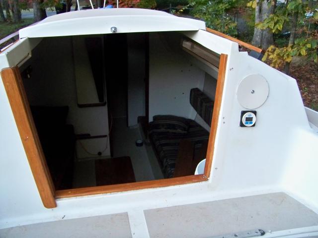

I have to install a compass.

Instrumentation will have to wait also. I haven't figured out where to put the knotmeter and depthsounder. A season on the water will give me a better idea on placement.

Rich,
To keep the putty molds from sticking try or combine these to methods.
Scran wrap - a.k.a. plastic wrap and not wax paper as used on gel coat by the yards. Real waxed wax paper is hard to find. The supermarket stuff often soaks thru. That is becomes permanent.
Coat the plugs with plug release wax. This stuff can be gotton from Worst Marine or those sites that I have mentioned previously. You have to clean wax coating off. Most use acetone to do that after molded part hardens and before full cure.
If you use Scran wrap and you wait until fully cured it might not come off. Scran wrap gives the surface a very smooth finish, as on original gel coat finish on a boat.
Just do one spot to see if technique will work for you. Do not do many then find out the Scran wrap does not come off with the filler product you are using.
Also if you pulled the filled holes out, you waited too long between layers. One the underlying layer fully cures, after 72 hours, I doubt anything will stick without ruffing surface and washing with acetone.
So, doing such project keep to injecting and when injected epoxy is hard to touch but not cured inject next layer. The curing time for epoxies varies with temperature and type of epoxy used. That is why West System uses three types of catalyst.
Keep in mind that there are cold weather epoxies that can routinely be used to about 40 degrees. But even those should not be allowed to freeze until cured.

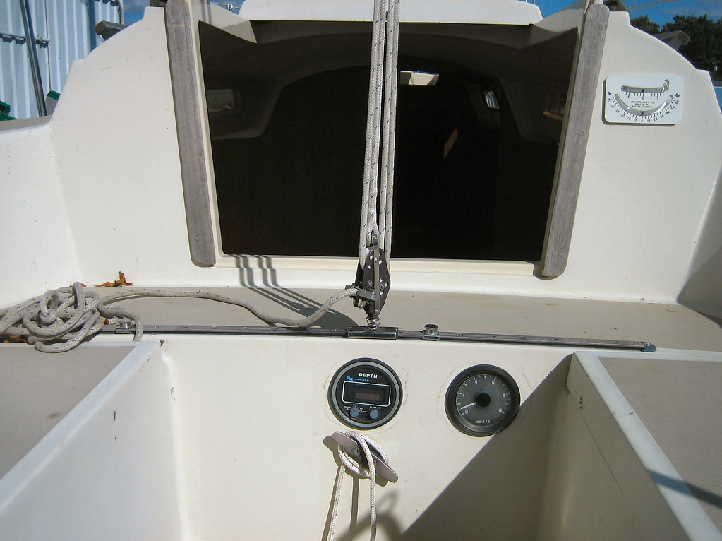

I don't know, on this boat there's not a lot of room to mount them on the bulkhead and if someone is sitting there they'll be blocked. Same for the compass. With the compass, if you're sitting on the starboard side and if it's mounted on port you won't have a good viewing angle because it's mounted so far outboard. Such a wide companionway. Plus you'll ruin the only semblance of a backrest that you have in the cockpit.
This is where the PO mounted his.
I plan on mounting my compass where the depth sounder is just above the c/b cleat- which I'll relocate. I figure that the hole is already there anyway. That is also why I'm moving the electrical panel which would be just forward of the compass. . And I will be removing that inclinometer.

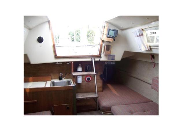

Hello Rich, I've attached a photo, as taken from inside the salon, showing how previous owner mounted a "L" mount for the Humminbird depth sounder/fish finder. Seems the previous owner felt the same way about a semblance of a backrest. The transducer is mounted under the starboard settee just forward of the galley. It works as I witnessed, although I would have preferred the transducer to have been run and installed under the v-berth.
I have an original but dead display on the portside, hidden in the picture by the depth sounder. It still has power run to it so I figure I'd remove it and cover the hole with a vent cap, similar to this, but mine is plastic
http://shop.torresen.com/ships_stor...nt+Cover+-+Black&sectionid=2536&imgsize=large
Then since I have "L" bracket I was going to add my bracket and then
tap the line, nearby, to power my LOWRANCE iFinder H2O Handheld GPS Receiver, that I kept from my previous sailboat.
