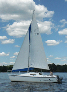

Sorry for snooping, but I saw you reading this closed thread. http://forums.hunter.sailboatowners.com/showthread.php?t=120970 Turns out, you're describing my boat exactly... At least I think that's what my main looks like. Please check out the picture attached and tell me if the problem you described is what I have going on with mine. The sail may not be raised all the way, but the sail and rigging are all original - I think!

1. Could be simply that you arent FULLY raising the mainsail, most 'non-racers' rarely raise their sails properly preventing the sail from taking its 'designed shape'.
2. With 'original' sails ALSO that the luff boltrope possibly has shrunken...
ALL I can discern from your photo is the aft end of the boom is much lower than the gooseneck, usually caused by 1&2 above .... all this results in "weather helm", draft too far aft, very 'full' draft, 'baggy' sail, leech 'hooked up to weather, drooping boom .... Boat - cant point worth a damn, heels over aggressively but slow as hell, 'cranky' boat, etc.

The picture on the Hunter 23 shows a short luff and that's OK. Need to put more tension on the halyard and if there are two holes on the headboard, use the aft position.

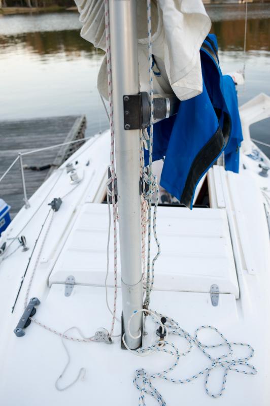

I'm attaching a picture of the base of my mast. I do have a winch on my mast but the PO had the halyard run to the cockpit for easier single-handling. (You'll also notice the collar missing from the winch.) Forgive my ignorance, but would using the mast-mounted winch really help get the sail higher and tighter? Yes, I did read what you said about kneeing the tack down.

Kermit
The sailmakers database has your H23 with an 88 degree 'tack angle' for the main when 'full up'.
I suggest that, on a windless day, you simply make a trial of raising with the incomplete winch and measure the resultant tack angle that he mast makes with the top of the boom .... a square sheet of card board (90° angles) will be 'close' or 'good enough' for starters. This will also help to determine if your boltrope has shrunken or not.
Then, you can 'trial' raise from both the cockpit or by 'worrying' the halyard (pulling the halyard from a perpendicular angle while you hold tension around a cleat, etc.) at the base of the mast, etc. to see if you 'can' come close to the 88-90° tack angle by not using the winch. Odds are you WILL need that winch for an old sail with a shrunken boltrope.
You can still use the winch even if the halyard is led the cockpit ... raise the sail with the winch and have someone in the cockpit 'tail' the winch from there ... when you need to dowse from the cockpit, the halyard will simply slip on the winch, etc.
Of course the ultimate test will be while on a beat and heeled over - to let go of the tiller and have the boat continue a 'straight course' without heading up or falling off ... then loosen the halyard strain until the boat 's-l-o-w-l-y' heads up all by itself. .... but every day will be 'different' as to how much or little halyard tension is needed ... and if the halyard is in the cockpit of a smaller boat, the safer the 'final' halyard tension adjustment while underway.
Later, to make halyard tensioning 'faster', once you find the correct amount of tension for the 'usual' wind and wave, etc. conditions ... simply put a mark on the mast and another mark on the halyard overlaying the 'mast mark' and simply 'match the marks' when raising.
Just do some trial 'raisings' to see if you can get at least a 90 mast/boom angle.
